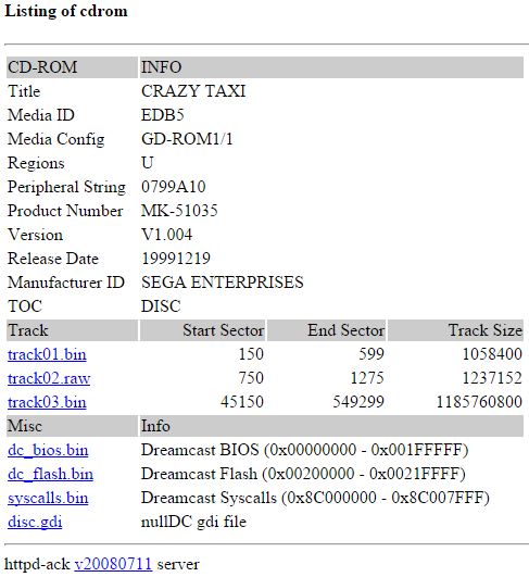

    5. You'll see something like this:
    6. Then click and download each track file one by one. The TV will let you know if any tracks have errors.
    7. After you're done with all the track downloads, save the disc.gdi file for the disc as well.
    8. If all the tracks download without a problem you're done! Otherwise clean the disc and retry.
