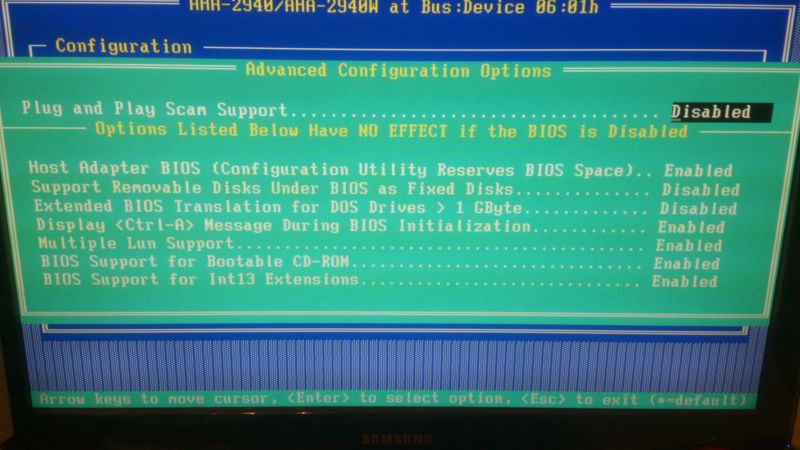

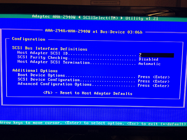

    That's not normal.
    At least, I don't have that & I also use a 2940 card.
    Maybe a specific setting on your scsi card is doing that ?
    If you go to the bios of your scsi card, note all settings & post them on the board, we could compare settings.

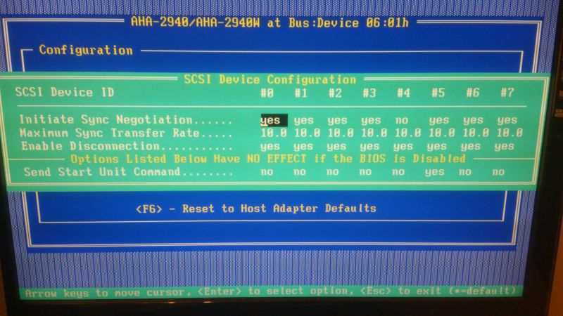

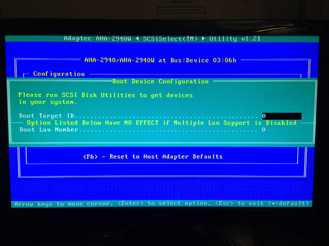

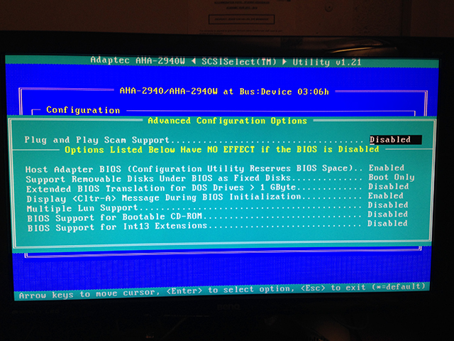

    I've attached images of my settings.

    (I have utility version 1.23 installed on my card)
    main Screen: scsi parity checking is enabled for me
    boot device cfg screen: identical
    scsi device cfg screen:
    advanced cfg option

    I've changed my settings to match yours, and I believe the problem with mine was initiating sync negotiation on SCSI device #4. It now boots properly, thank you!
