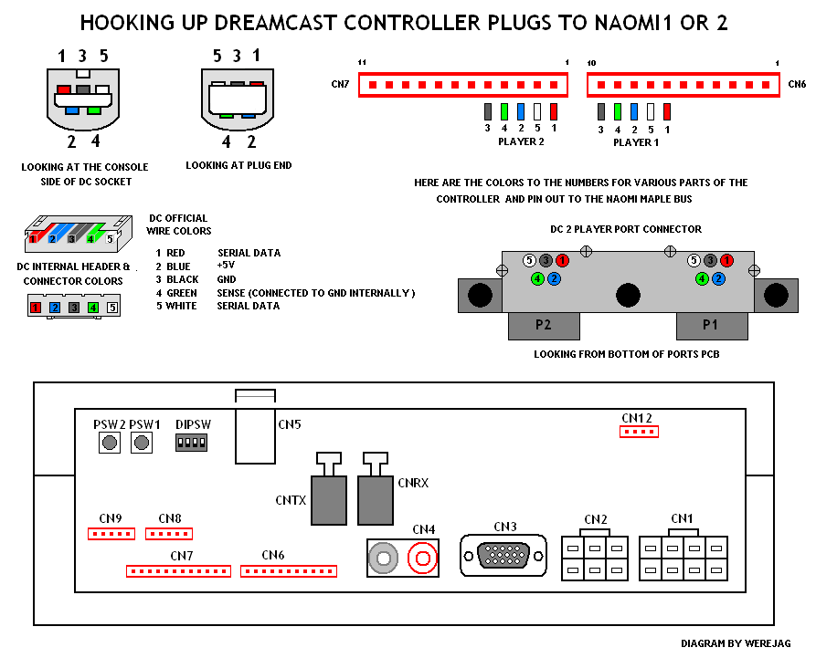

    3. Hack some Dreamcast pads to connect them to the Naomi:

    Running a NAOMI without a I/O board will result in an error, in other words, connecting Dreamcast controllers directly to the mainboard won't be to much use.
    Basically what you need to do is get/make an arcade stick and wire it up for connecting to the jamma connector and kick-harness of the I/O.

    The games that support the Dreamcast controller (and there only are a few) will only work if the Naomi 2 is running Japanese bios (with the exception of Gundam vs Zeon, Lupin Typing and Typing of the dead (last two being keyboard only) which support the dc controller port in usa bios).
    Of the games I own the following support the dreamcast controller: Marvel Vs Capcom 2, Gunspike, Capcom vs SNK Millennium Fight 2000 Pro, Moero! Justice Gakuen and Mobile Suit Gundam The Earth Federation vs The Principality of Zeon. That isn't too many considering I (currently) own 23 Naomi/Naomi 2 games.
    Your either going to want to setup a Jamma to JVS io (either sega or Capcom) or a Sega JVS I/o. If you pick one of the Jamma to Jvs I/o boards you will need a jamma harness that can be wired to something like a neo geo controller. Of course as mentioned above the io needs to be powered either from the jamma harness or connecting it to the Naomi or its power supply.
    I can speak from experience, this is one of those things that seams hard to do at first but once you have it hooked up you will have no problems playing games. I recently set my controller extension cable up with alligator clips so I can easily remap controls to different buttons by taking a clip off of a jamma harness contact and putting it on another.
