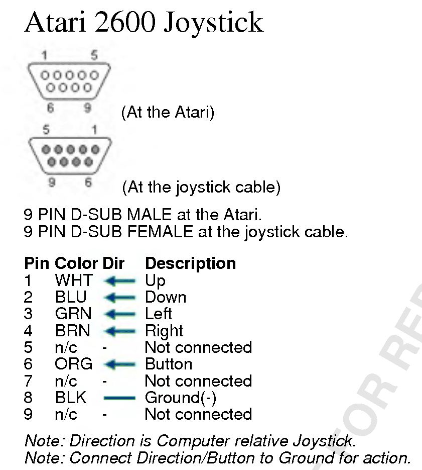

    Update:
    I am at the moment drawing a schematic for a pause mod and instead of a switch I'm going to use a single button soft latch, wired to the controller.
    Although i am struggling with if i shall replace the d-sub 9 with a d-sub 15 to accomodate for this and future ideas.
    OR simply use a microcontroller/port expander.

  6. bacteria
    bacteria I am the Bacman
    Apr 8, 2008
    978
    Controller is just contacts from what I can see, so simple.
  7. Greyneon
    Greyneon Member
    Nov 16, 2015
    NO didn't mean that controller. Meant controller for rgb output xD my bad
    Do not want to buy the rgb circuit. I want to make it myself and couldn't find a schematic for it :/
