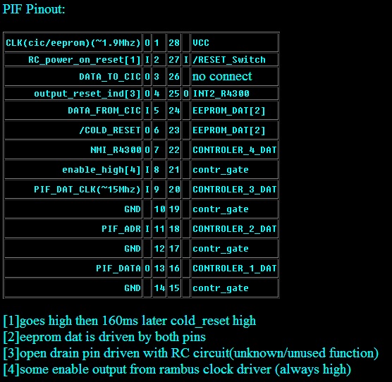

    Well here's the pinout
    I would start with switching VCC, PIF_DATA, DATA_TO_CIC etc. to figure out which of the 28 pins can be connected all the time and which must be switched between the two pifs.
    The easiest way probably would be using an Arduino and some relays and figure out wheter or not the Cartridge is PAL or US with a push buttonthat checks the indentation of the cartridge.
    But those are just random ideas since I'm pretty clueless to be honest.
