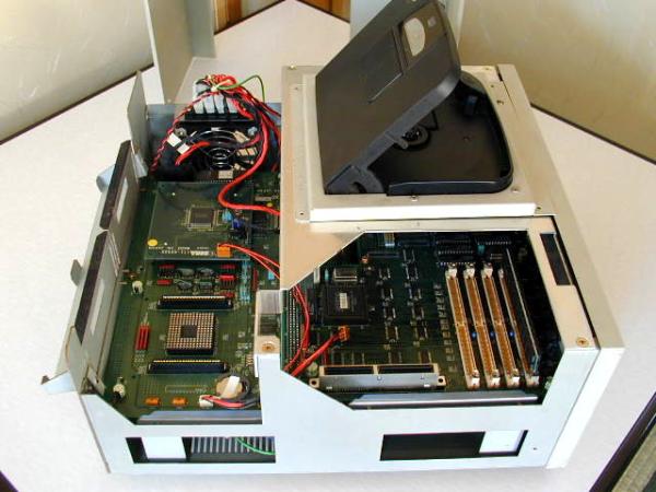

    That could be. That's part of why I am seeking info. The lower main board has 2 spots marked SHII. I have 2 modules that are identical layouts, but are populated differently. One is Sega 837-10494 and is marked SHII ICE CONN BD. It has no CPU, just an empty DIP socket with an odd pinout. I haven't seen a socketed SHII CPU, so maybe that's what fits. The other one is Sega 837-10495 SHII QFP CONN BD. If you plug the ICE module, then you can only physically plug one of the two CPU modules. I would guess that you either use the ICE module + the ICE CONN BD, or just the SHII QFP CONN BD alone. Is that how it works with saturn sophia?

    He's missing the ice module, it sits on top. You can put in a SH2 but where to get one in zif format?

    Looks like my unit is pretty complete except missing the cable that attaches the ICE PGA adapter to the ICE pod. I am assuming that the ICE pod is the Hitachi SH7604 triple-stack assembly. It's got Hitachi (c) all over it, so I don't think that it's made by Sophia. I found my 2 proto carts. Pics here:

    I just noticed that the sh-2 board isn't the same as the saturn dev. Yours is much smaller.
    Afaik Sophia made all the items for Sega including the ice module. I could be wrong.

    The ICE box for Saturn is the Hitachi E7000 - standard SH2 ICE. However, it needs a PGA adapter which comes with the Sophia Target Box. That, and the pod has a different connector from other non-Sega pods I have.
    Photos aren't loading for me - I'll look another time. You'll need two SH2s or one and the ICE in place, though.

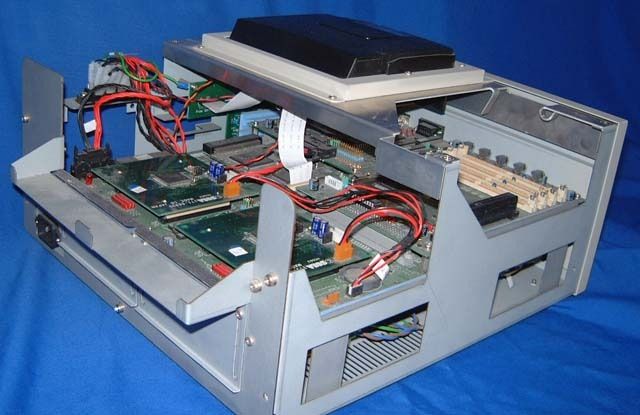

    Take a look at my Sophia gear:
    http://www.assemblergames.com/forums/showthread.php?t=20197
    You'll see the two pods on top. Both made by Hitachi and identical. The left one came with a Sophia setup and has a PGA socket, the right one came with a Hitachi ICE used elsewhere and has rows of connectors.
