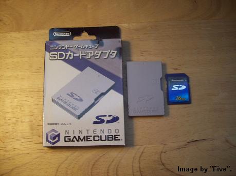

    I'm lucky to have an official SD card adapter for Nintendo GameCube
    It was sold only in Japan and was compatible with only a few games (including Animal Crossing).
    I wanted to test it with Swiss to read backups or isos, so transform it into SD Gecko. And it does not work well at all! 32MHZ playback does not work at all, and there are many bugs in 16MHZ mode.
    The problem ? Unlike a real SD Gecko, the pins of the SD drive on the official adapter are not connected directly to the pins of the memory card reader, there are resistors, transistors, etc ... : [​IMG]
    However, homebrews in .dol format can be read without problems (emulators, etc ...).
    I am currently thinking about rewiring, but that does not seem possible, even removing all transistors, capacitors, resistors, etc ...
    Do people have the same problem as me?

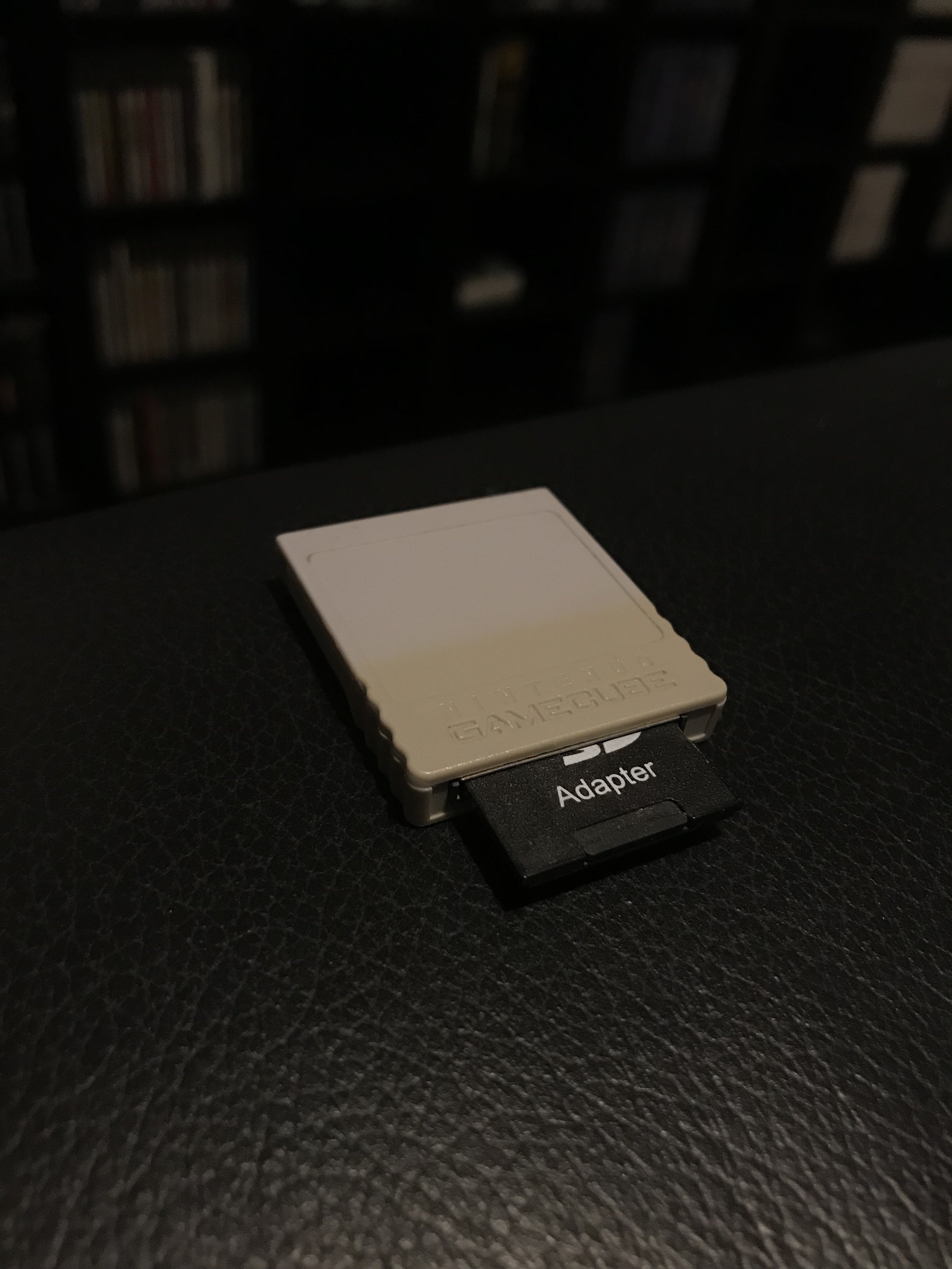

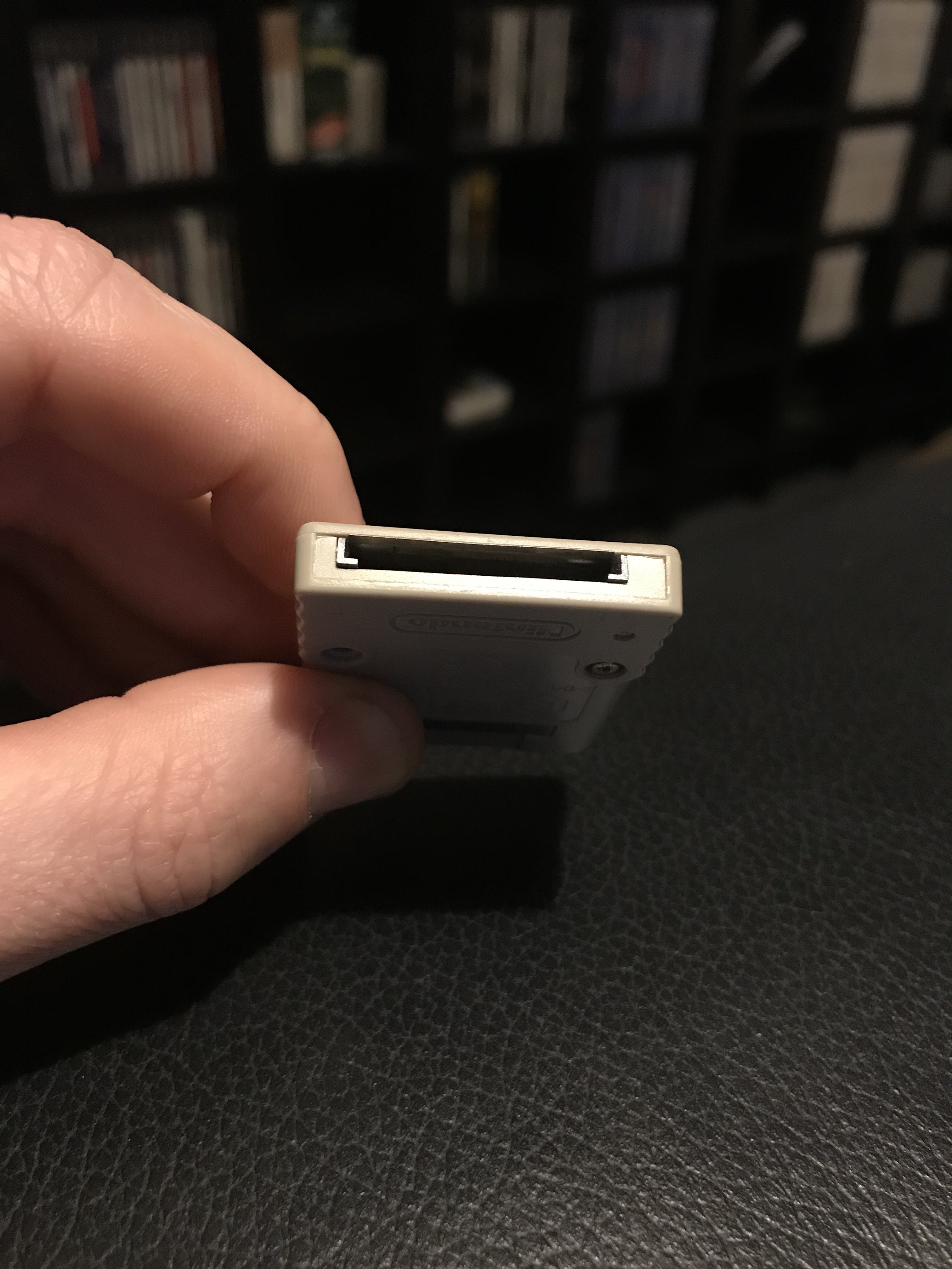

    While it's not as fancy as your official Nintendo SD adapter, I did modify an original gray (59) memory card to SD adapter some years ago. Turned out neat enough, but one of the screws on the bottom had to go as it couldn't fit with the SD socket inside.
    It's just the SD socket wired directly to the memory card pins. I haven't really used it much, but it loads Gameboy interface just fine through Swiss. I also tried running a US version of a PAL game I own, which worked no problem, but my overall experience with GameCube and SD cards is limited so I can't really comment on compatibility and reliability in the long run.
    Had I done the mod today I would use a micro SD slot instead, but they weren't as common when I did this.
