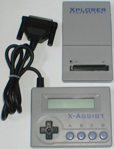

    I do even have an XPloder Professional cart at home. It came together with a display unit (X-Assist).
    Does the Xploder need to be reflashed with Caetla firmware for this (is Caetla firmware compatible with Xploder carts?)
    For Windows 2000/XP you can use drivers like UserPort or Porttalk
    My cart looks like this:
    Got it for 4 € in a second hand store.

    1,255
    88
    Yes it is. I'm running caetla on a xplorer fx, I think it's compatible with the other revisions too. You probably need to reflash it under msdos, thats what I ended up doing anyway ( don't forget to save the firmware first in case you want to go back to it ).
    Then get hold of catflap, it runs great on windows xp and it supports sending cpe's ( native psyq format ) as well as exe's. The latest version I have is v2.36, it seems quite hard to get hold of. Let me know if you need it.
    If thats all the development you want to do then having an official debug station is a bit overkill. Caetla doesn't care whether you can play cdr's & the colours don't match :)
