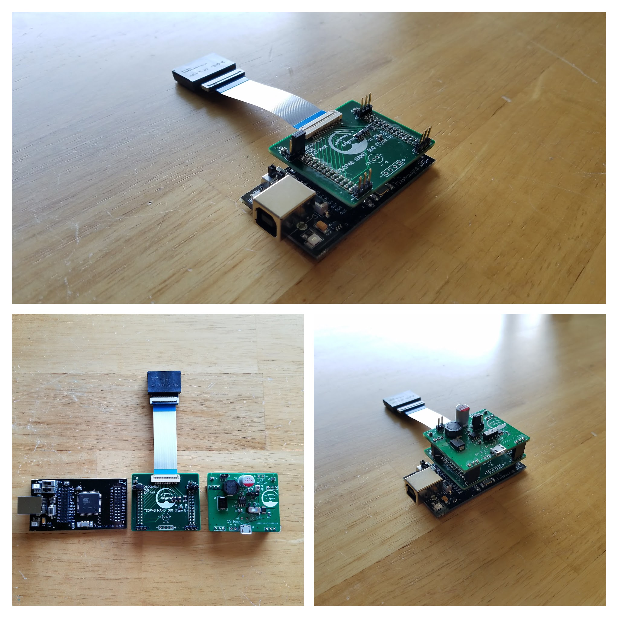

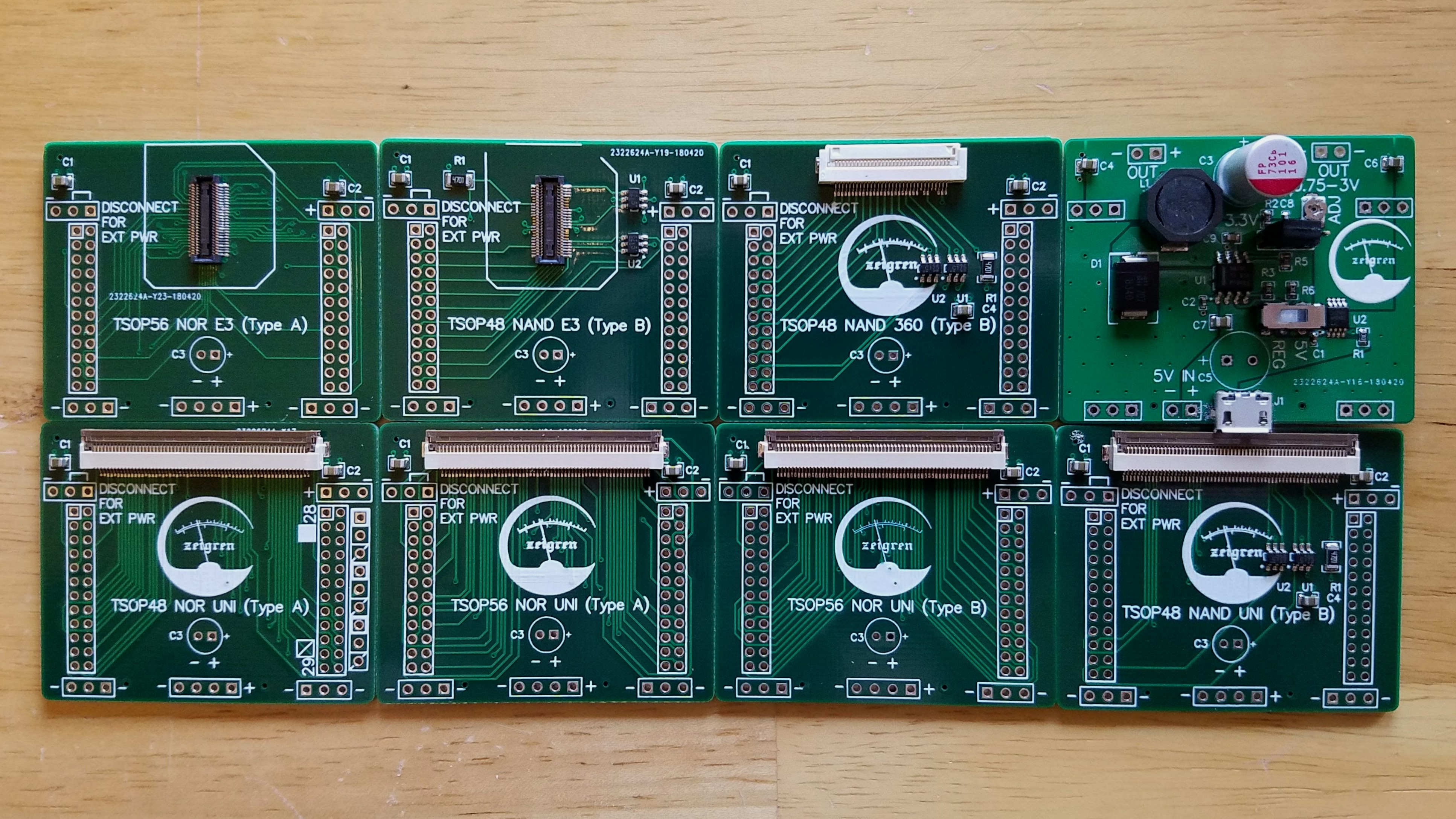

    I wound up doing what ricktendo asked and made a bunch of clip adapters for the FlashcatUSB xPort.
    Which completely replaces what I was working on before. It makes more sense to just make these for the xPort since it has better software support, works with 100's of different flashes, and has almost 3x faster transfer speeds along with a bunch of other useful features. All while still being about the same price as a Teensy++ 2.0. This way these can be used for much more than just PS3 stuff.
    I made a matching clip adapter for each of their TSOP48/TSOP56 NAND/NOR parallel socket adapters that they currently sell, with some extras for supporting different clip styles along with a probably overkill power supply to sit on top of everything #stacked
    I have more info about all of these up on my website, now I suppose I probably should update my for sale thread.
