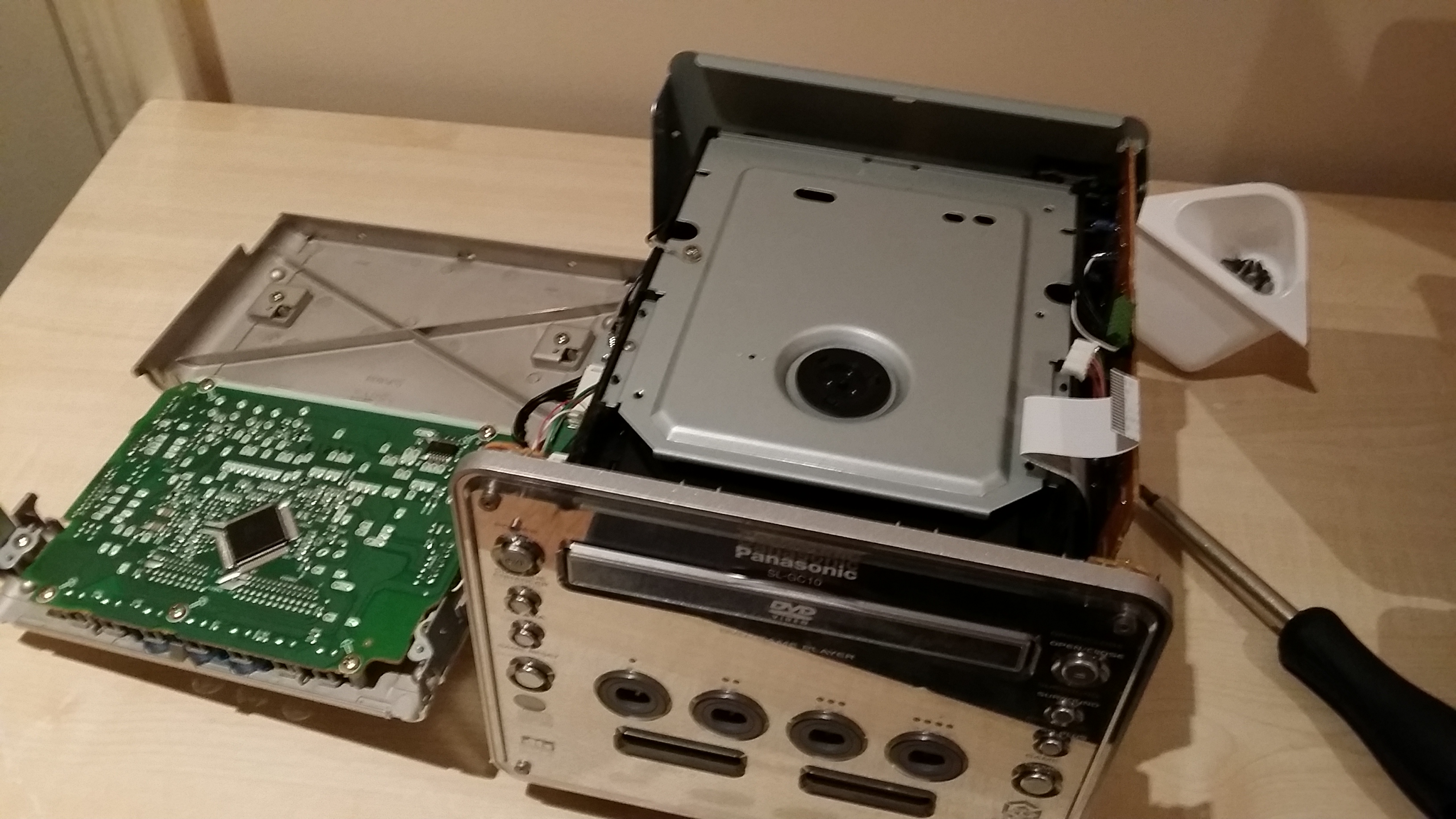

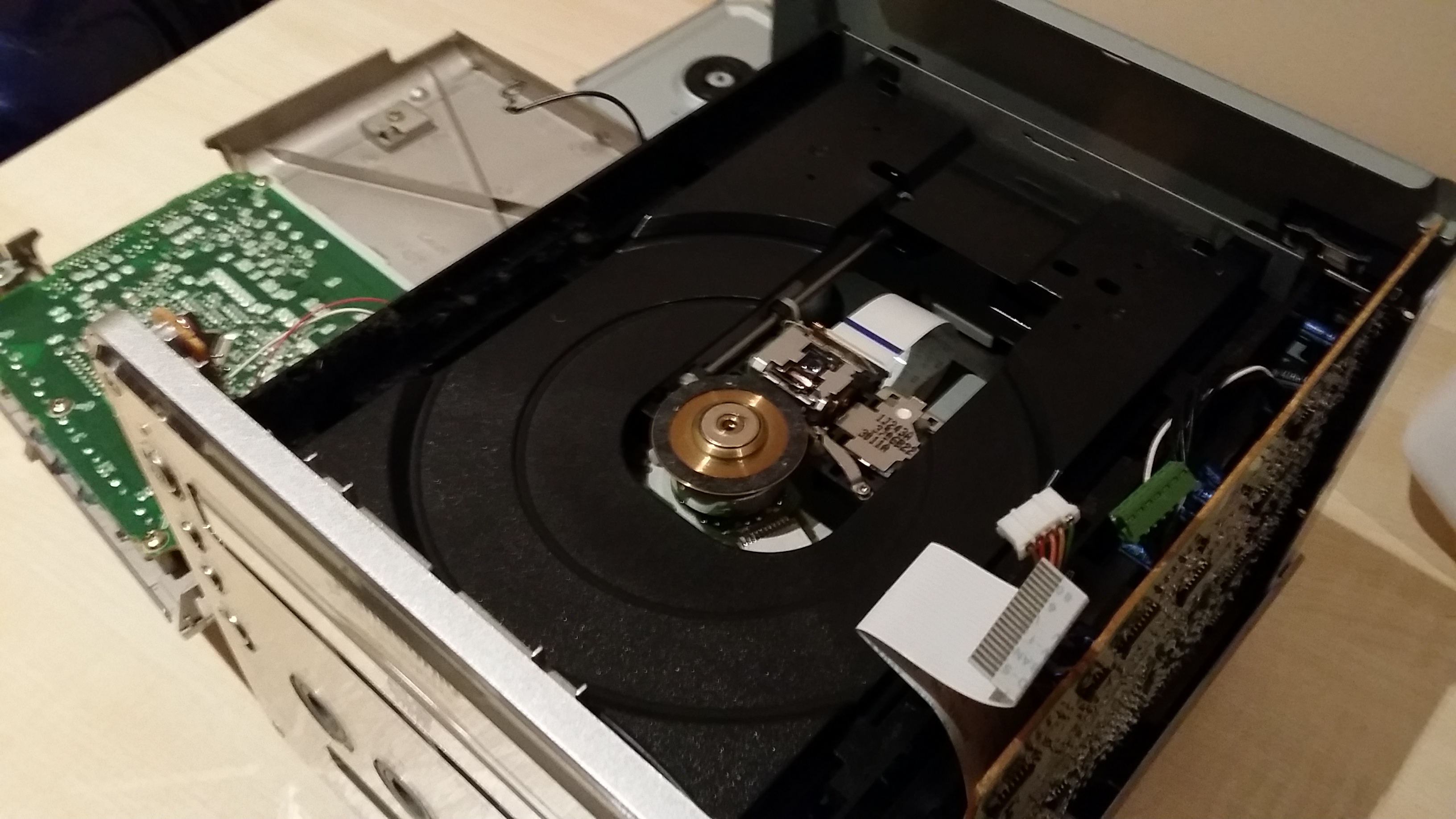

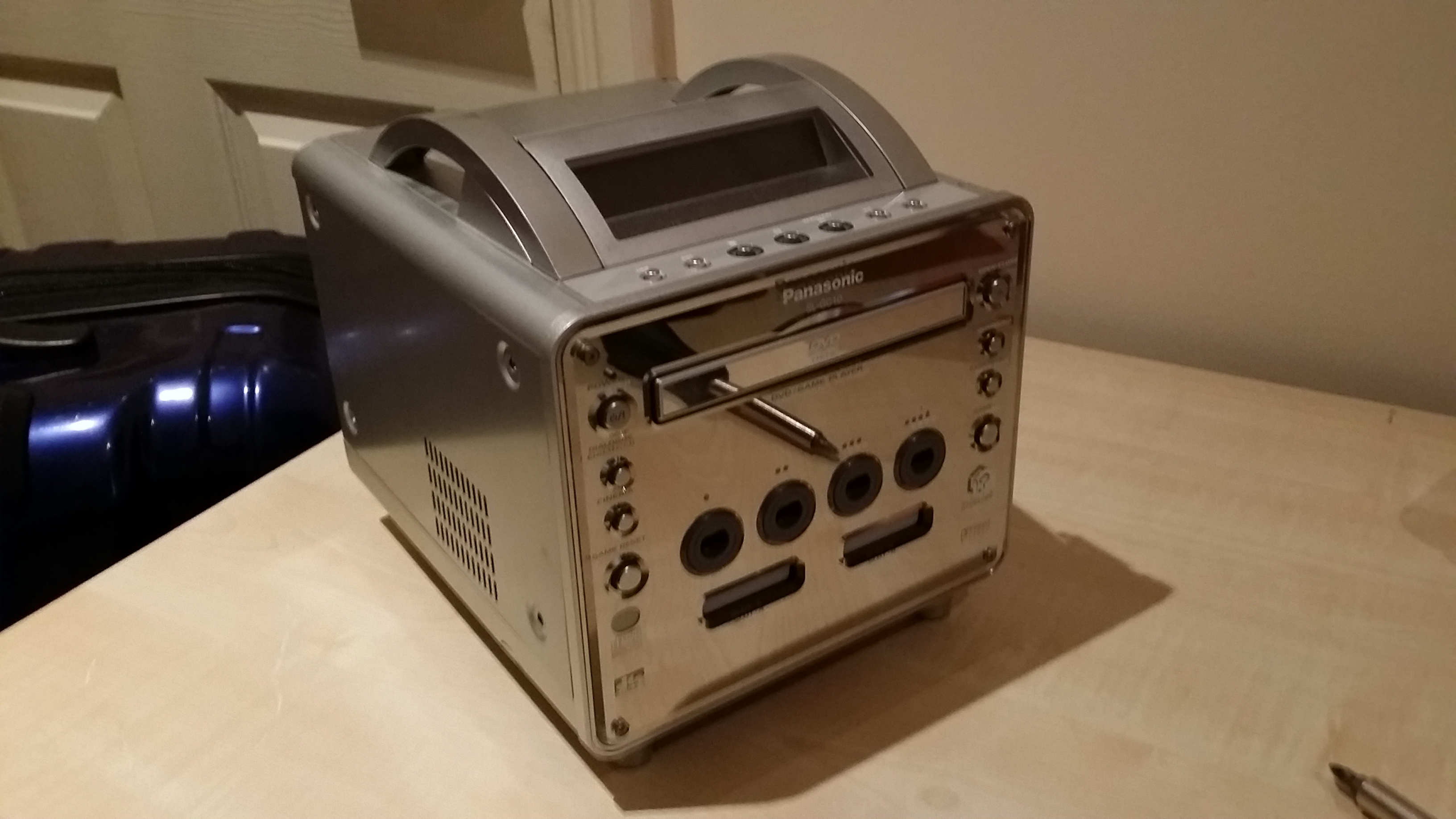

    My Panasonic Q somehow managed to destroy its disc tray just by sitting on the shelf unused for years, couldn't even get the tray open to be able to reach the drive belt (which I bet was hardened). Play your stuff, folks!

    I could see that because those tray drives have rubber belt things that petrify over time despite if they are turned on or not, but stuff like my snes killing itself remains a mystery to me
