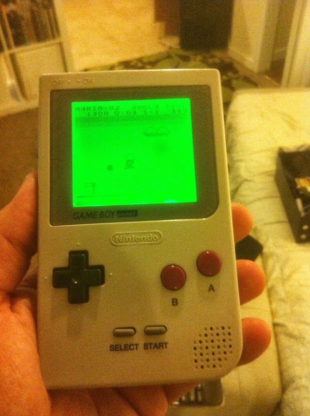

    Hi guys! Bit of a weird question, but I've recently picked up a Game Boy and I'm thinking I'll install a backlighting mod on it. However, the guides I've seen result in the console losing it's characteristic "pea soup" colored display, so I was wondering if it's possible to install one of these kits without losing the color. Part of the installation process is removing two films from the screen, one of which appears to be a green film. If you didn't remove this film, would this this do what I'm looking for?

    Possibly by the colour of LED. It won't be exactly the same though.

    Yeah, they make a green backlight, but it's a very neon green color.

    I bought a green led frontlight for my Gameboy Pocket.
