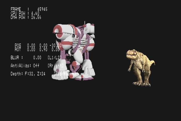

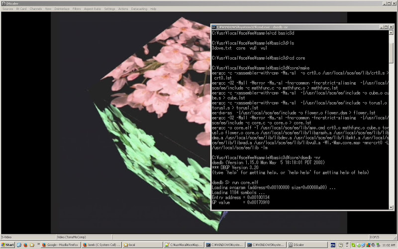

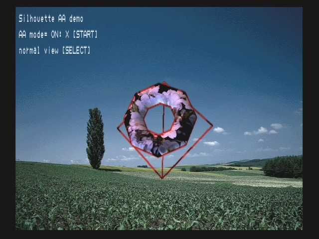

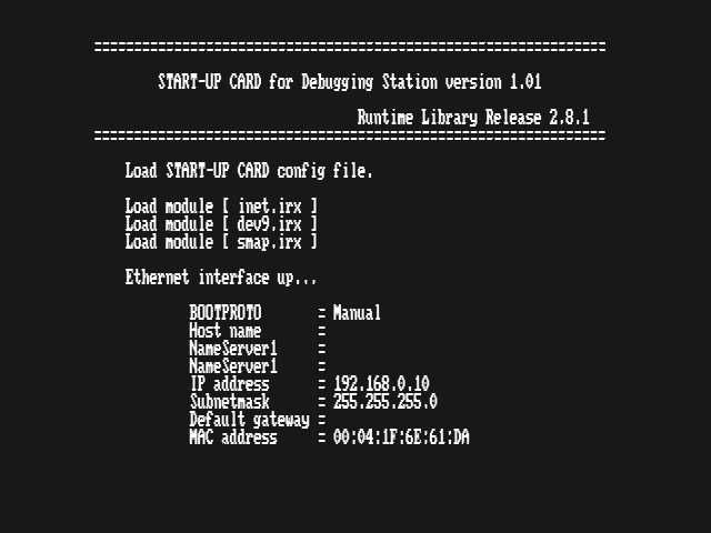

    Yes it's possible to compile stuff without a PS2 TOOL. The PS2 TOOL is simply a target box with advanced debugging capabilities.
    All of those are sample programs which came with SDK 3.0.0.2 as source code. I used a retail SCPH-10000 unit with the PCMCIA network adapter to run those samples through a tool called "Startup Card"
    which makes a PS2 (it's intended for Debugging Station units though) behave like a sort of "mini PS2 TOOL".

  10. LocalH
    LocalH Spirited Member
    Sep 2, 2007
    134
    This card is, I believe, the very thing that SP193 reversed and cloned with the RDB startup card.
