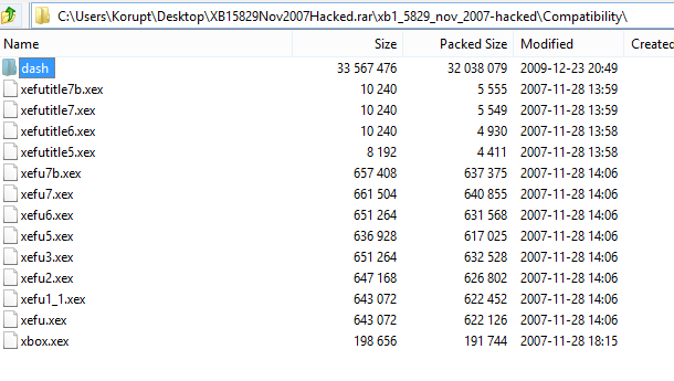

    I am pretty sure with the Xbox Original modded compatibility files everything is playable In disc or xbe format. It would be a modification on the HDD in the HDDX partition, but I have never used them on a retail unmodified console so I have no idea if it's something that can be detected for XBL banning. JTAG/RGH/RGH2/RJTAG and XDK work with it fine.

    The hacked files are .xex's so nope wont work on a retail since the signatures are broken.

    I am not sure what compatibility files you have, none of the ones I have used on my devkits are xex based. They are 3 files inside the Xbox1 file: cache, udata and tdata of which are bin and xbx files, not xex's.

    Right. So if I am incorrect, please feel free to correct me, but aren't those title cache and title data what makes the already existing Xbox Original emulator on retail or dev function with ALL games and not the some odd 60% MS allowed to be played on the 360? So if no one is messing about with the xex's in the flash, which if they are stored there a retail unmodded console couldn't get to anyway, wouldn't the hacked comp files be enough on a retail without causing a ban hammer to come-a-swingin'?

    But arent these all .xex's that were modded/hacked? im sure a retail can't run these.

    It's in the flash on devs only. On retails it's in a separate HDD partition. And no, there are hard coded restrictions in the XEX which I think must be a list of tested and supported title IDs. xor's hack just lifts that restriction and never hits the code that kicks you out I'd imagine. I never did a diff on the compatibility files but if you get the version from the XEX and grab the originals from a recovery you should be able to check.
    Point is, it's a binary modification. Not an unsigned data file modification.
    What others are mentioning above is an actual app called "theloader". It was never released publicly.
