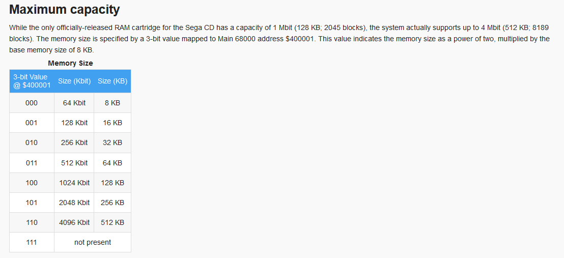

    You are incorrect about the size.
    It is a 1Mbit cartridge, The first file I uploaded was the entire cartridge.
    The second file was the cartridge, plus the empty space that was left in the megadisk's RAM, which is 16Mbits.

    Nah. Spot on about addressable memory size. You're confusing that with cart size. The question is where is that 128k cart located in that 16MB of space. If it's a $0 then you dumped it when you used your cart dumper. If it's at $4000000 like the source you cited seems to say then your dump of $0-$200000 missed it by a mile.
    You can check by comparing the first 16k of your first dump with the first 16k of the dump after you formatted. If they're the same then it's not at $0.
