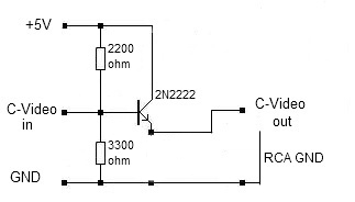

    I used this schematic [​IMG] except I used a 2N3904, which seems to be a common replacement for the 2N2222.
