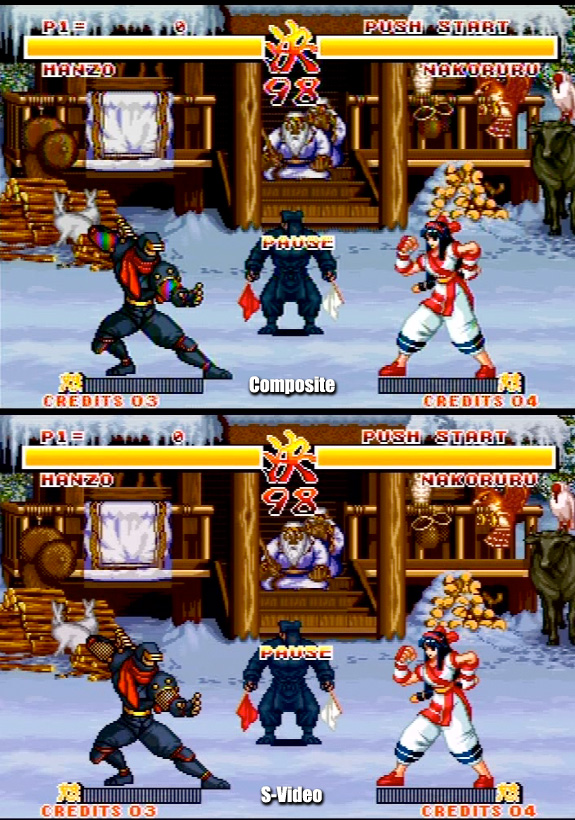

    The composite is horrible but if you upgrade the video it makes a world of difference.
    Here are some screen shots I did via composite and s-video. You can clearly see the huge difference S-video makes. No rainbow on his sleeves. The composite below is from a 3-6 revision which has the best Composite output of all the Neo revisions.
