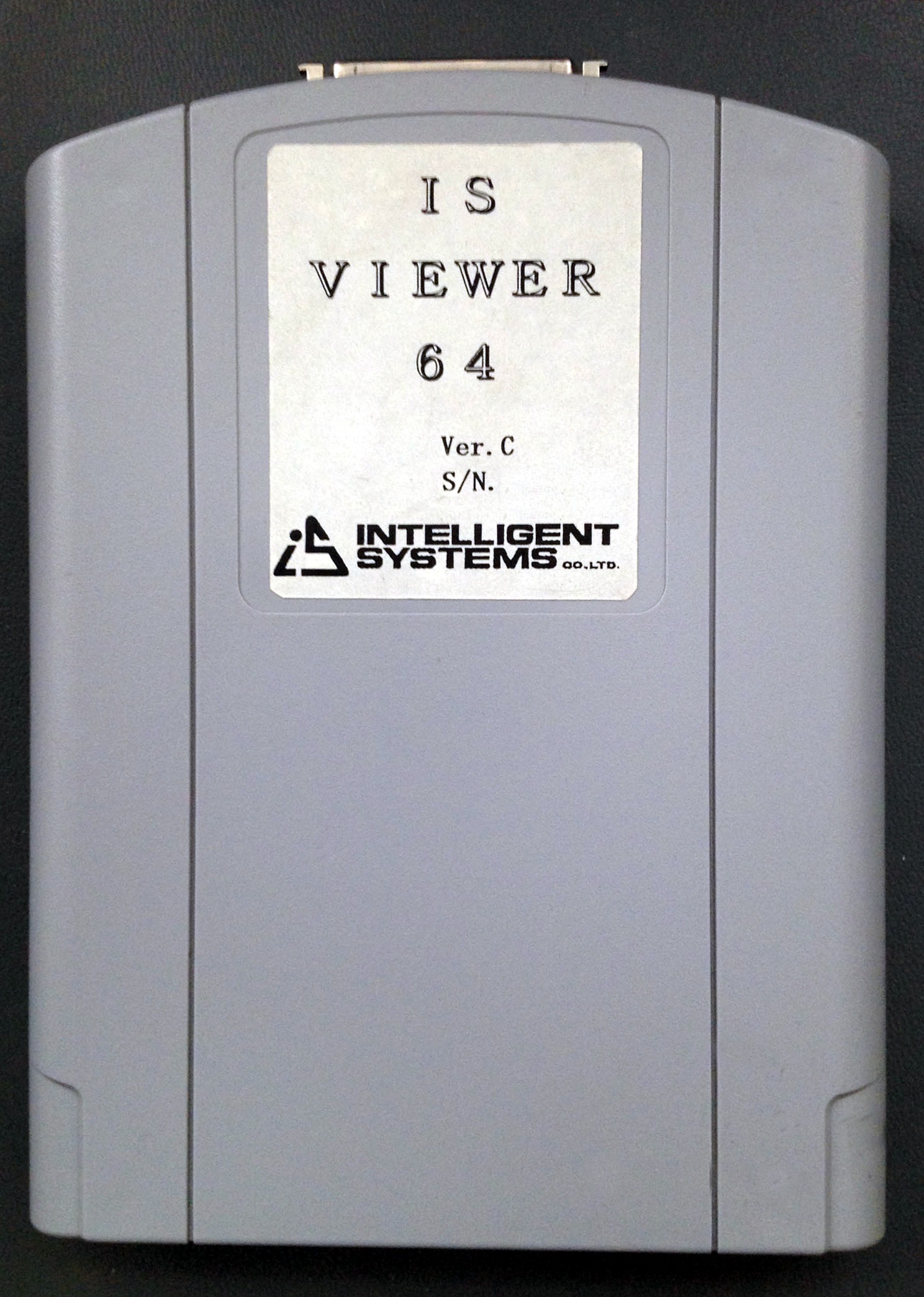

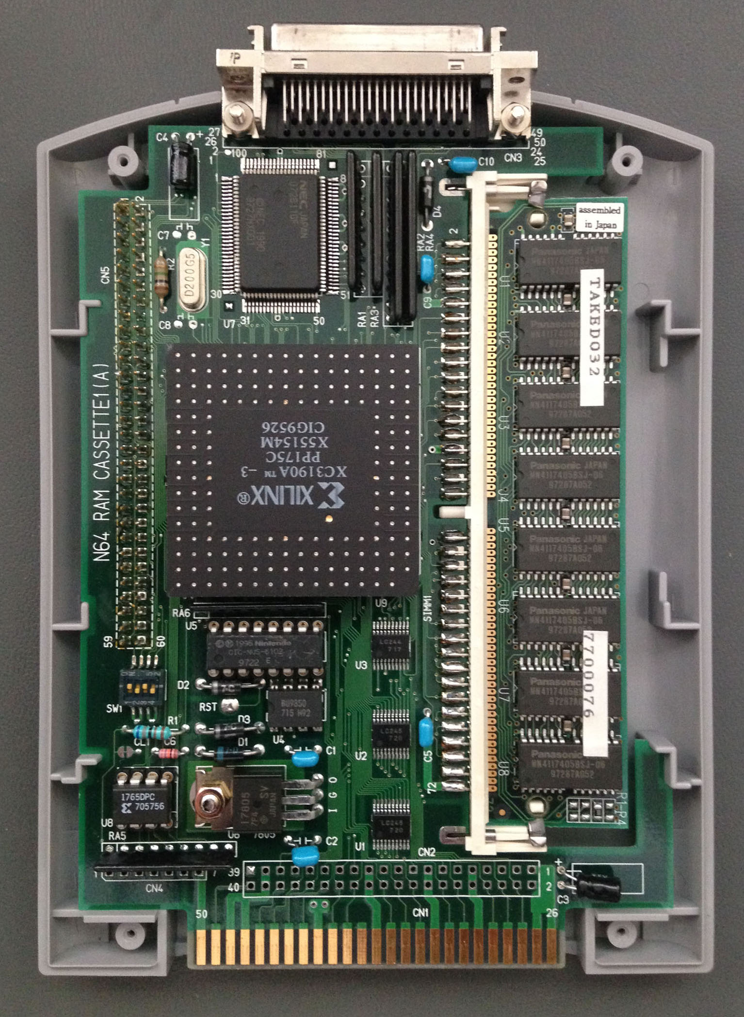

    First off, the IS-VIEWER64 is a RAM only based development cartridge. This means that each time you power up the Cartridge, all Game data must be loaded into RAM through the SCSI interface. Once power is removed or the cart is disconnected, all loaded Game data is lost.
    This Cart above is the 32MB version or possibly larger. I'm still verifying this. The SIMM RAM module is a "Panasonic MN4117405BSJ 32MB PS/2 EDO SIMM RAM Memory module. ". There is also an added "N64 RAM CASSETTE" on this cart. You can see the RAM cassette contact pins on the left side of the board. This is essentially a small Daughter card on the bottom side with additional RAM. So I'm still checking to see if this RAM is applied to the ROM memory area, or if it is used for some other function. The DIP Switch "SW1" I believe controls the RAM cassette addressing.
    There is also a small Serial EEPROM device that is used to store the SCSI communication Firmware. This is device U4 on the version C cartridge. Model number "BU9850" which is a BU98xx Serial EEPROM device. There is also a small XILINX configuration device that is used to load the XILINX FPGA bootloader at power up. However, all of the game ROM data being tested, is loaded into RAM only.

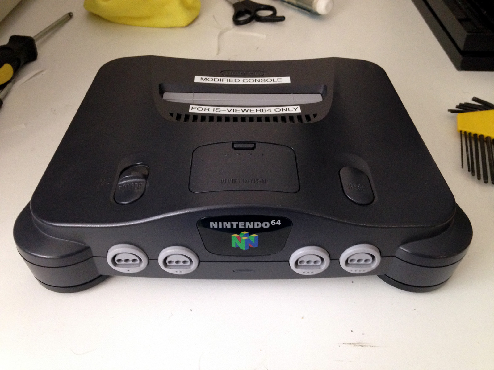

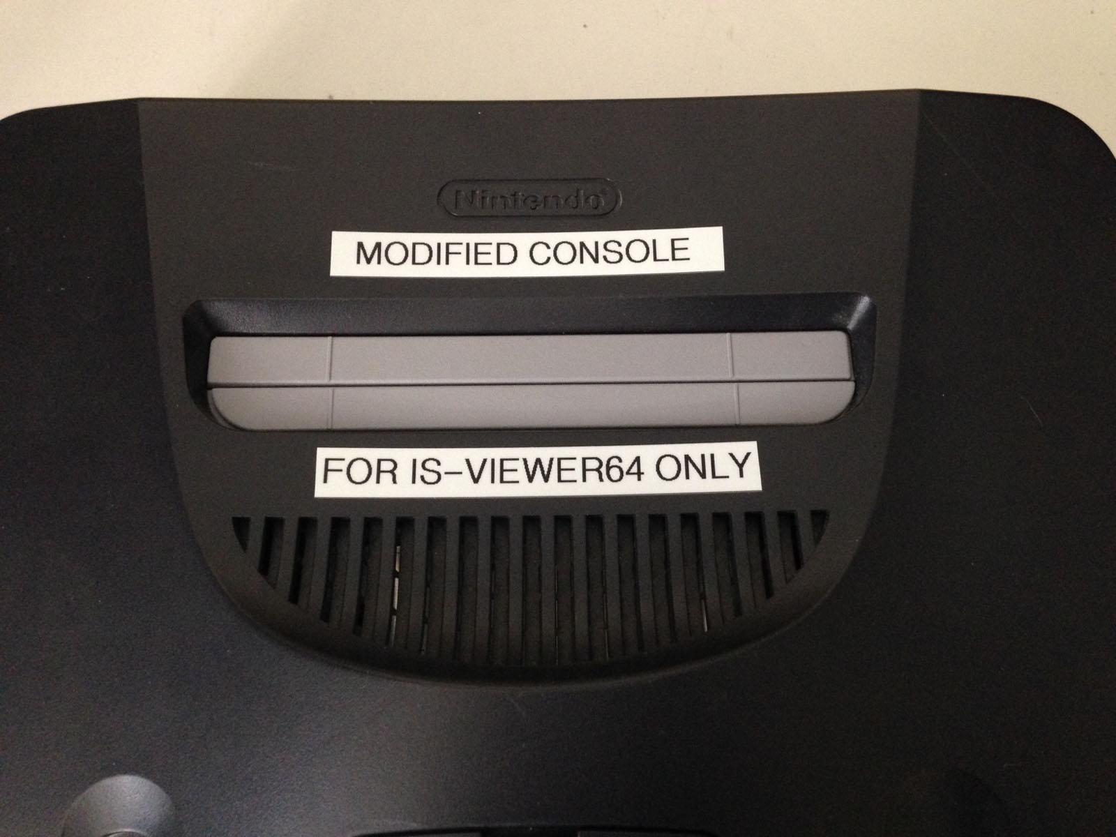

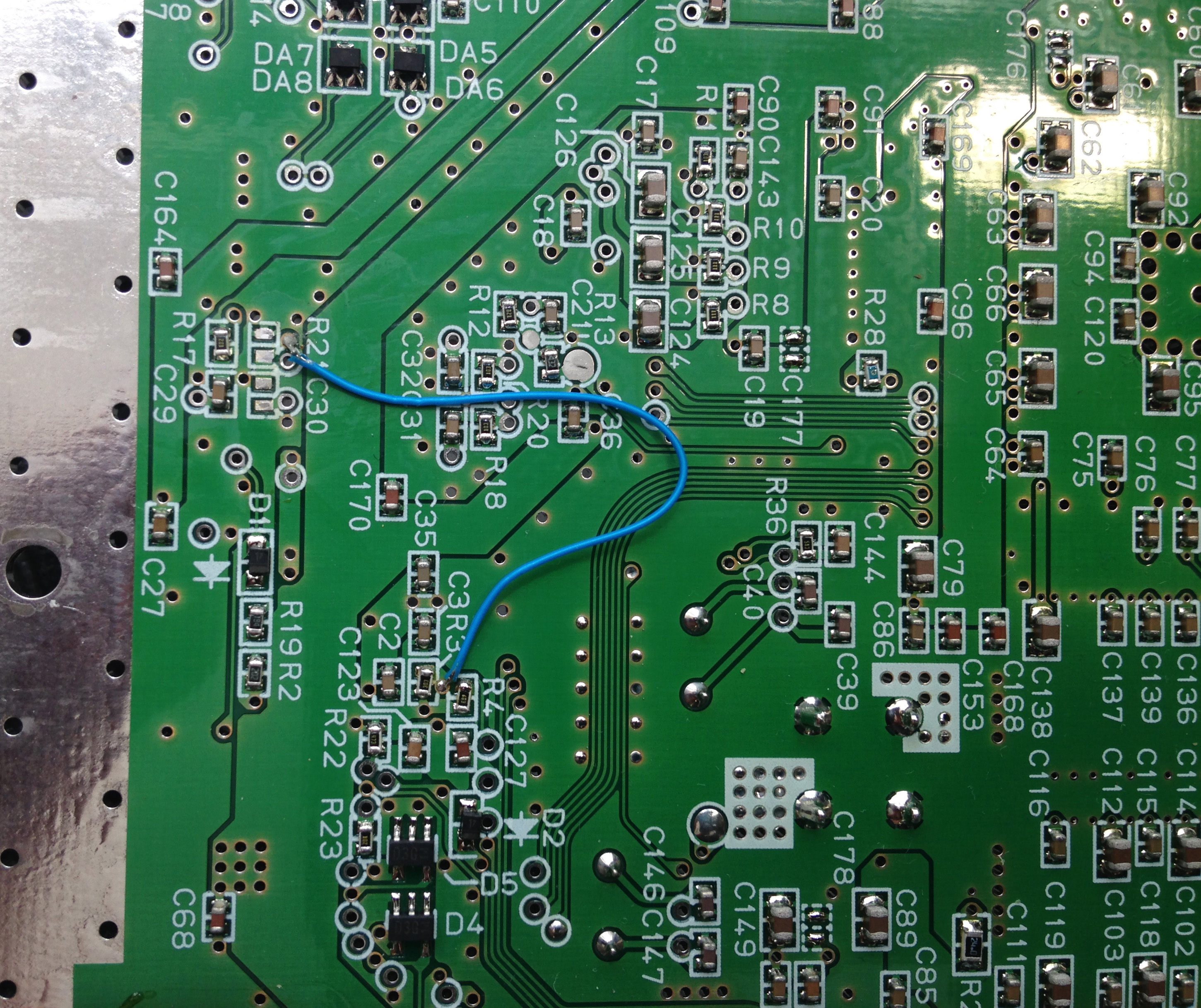

    Next, the IS-VIEWER64 requires a specially Modded N64 Console for it to work properly. This is similar to the Kmc PARTNER-N64 Debugging console Mod. My Buddy Mike who owns one of these IS-VIEWER64 consoles... I got him to pop it open and check out what the modifications were.
    The only modification that we discovered was a single isolation, and Bypass of the "L_AUDIO" cartridge edge and re-routing it through a Pull-up resistor to +3.3V. This mod is also performed on the PARTNER-N64 Debugging Console Mod, however its bypass wire is tied to a voltage regulator output instead of connecting it directly to a +3.3V rail. Same effect regardless.
    I performed this MOD on one of my spare N64 consoles and I was good to go.
    Also, a good thing to know... is that there were a few different versions of the IS-VIEWER64 that were released. The early releases like Versions: C and D of the cartridge, all required a rare "MDR50" SCSI cable as shown below:

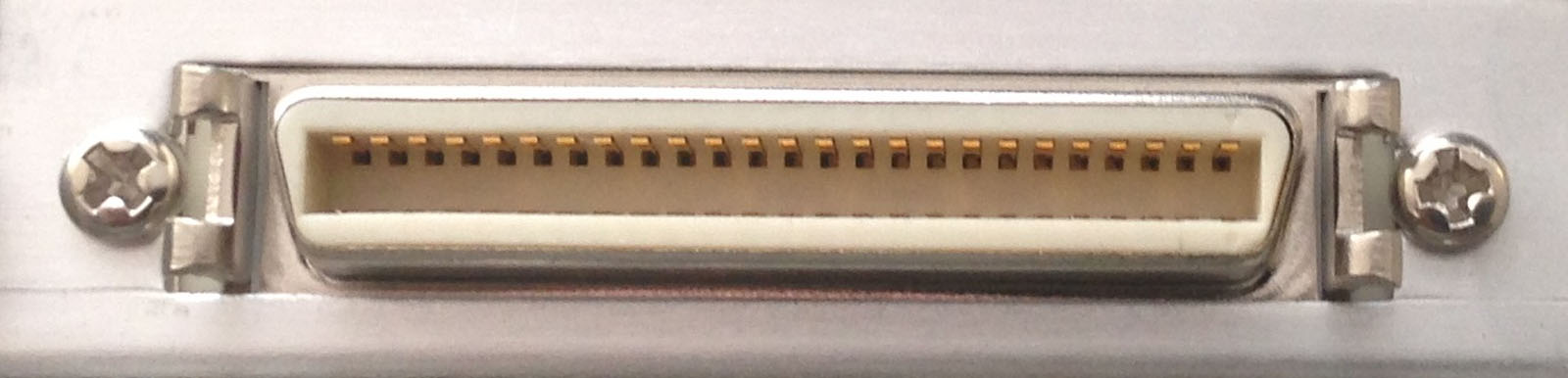

    The MDR50 connectors and cables which the early releases of the IS-VIEWER64 used, are not as common. One of these rare cables is shown here below:

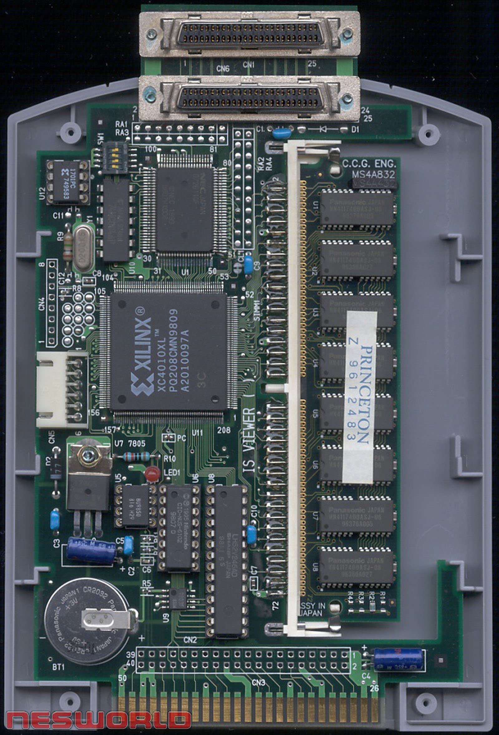

    The later models of the IS-VIEWER64 like Version: K (shown below)
    These carts used the more common HD50 connectors and also usually had a second SCSI port for connecting a SCSI Terminator adapter. This is a requirement for noise cancellation on SCSI cables. Especially needed for when using Long cables. The SCSI Terminators are simply externally connected Resistor Arrays, decoupling capacitors and a Diode...all crammed inside of a Dongle. Sometimes the Resistor arrays inside the dongles are implemented using a more specialized device called a "Active SCSI Terminator IC". This is simply a resistor array chip that is targeted for SCSI buses specifically and specially designed for noise bus cancellation.
    Notice on the PCBA below, the Resistor Array components close to the HD50 connector are all un-populated. RA1, RA2, RA3 and RA4. The earlier versions of the cart, these resistor arrays were in fact installed. This is what's called "On-Board Termination". This is also why the earlier carts only had the one SCSI connector. Because they were using "On-Board Termination".
    This version of the cart also has the standard N64 cartridge SHARP RAM chip LH52V246A with the accompanying button cell battery.

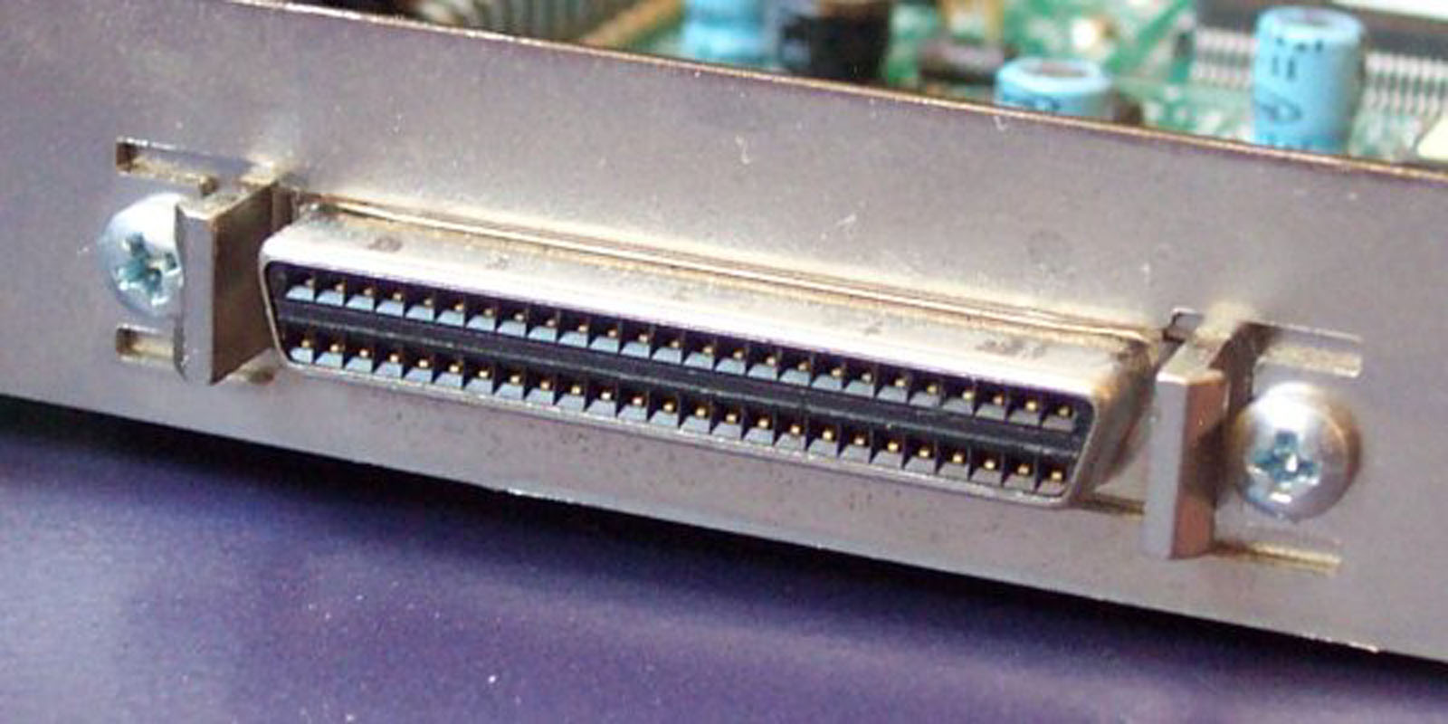

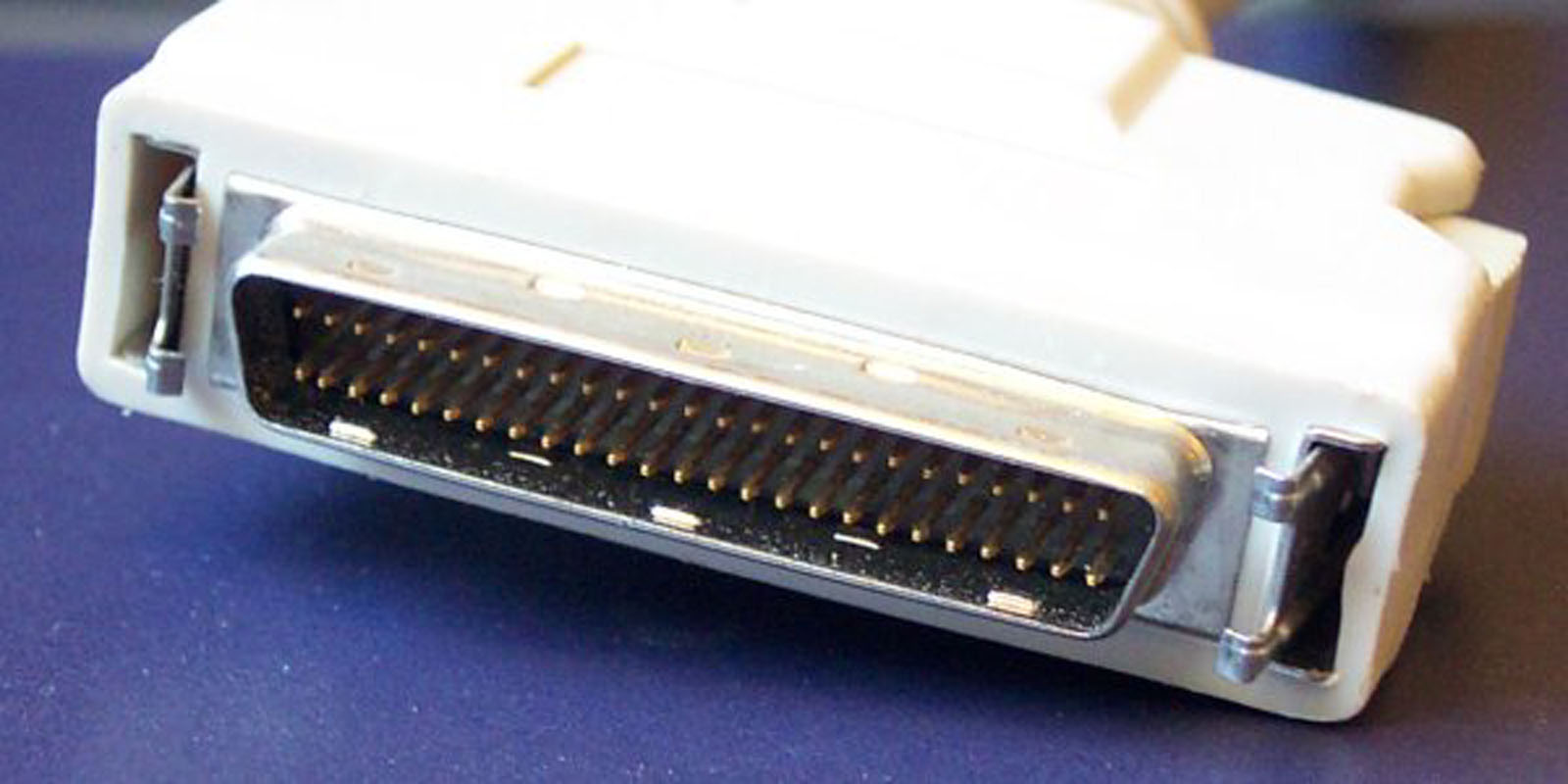

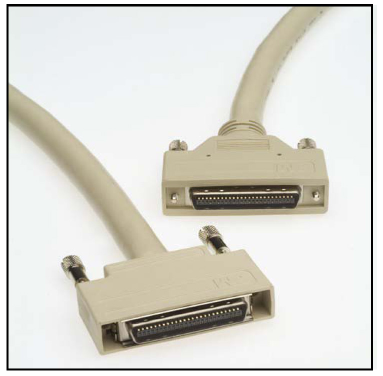

    Now, you can still get around the rare cable issue by using some adapters that will convert from the MDR50 connector type... to whichever Standard SCSI interface card you are using on your PC. The more popular version of SCSI interface is the "HD50" or High-Density 50 pin cable. The two connector differences are shown below for your review:
    HD50 High-Density connectors.
    HD50 Male connector:
    HD50 Female Connector:

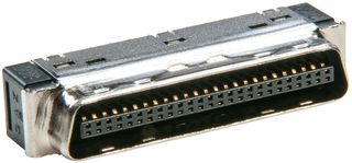

    MDR50 stands for "Mini-D Ribbon" or "Mini Delta Ribbon" with 50 pins/contacts.
    MDR50 Male Connector:
    MDR50 Female Connector:

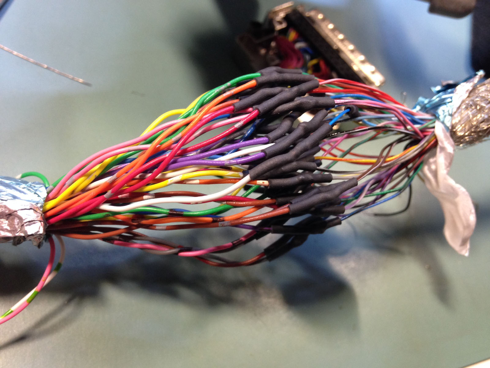

    So after figuring all this out....

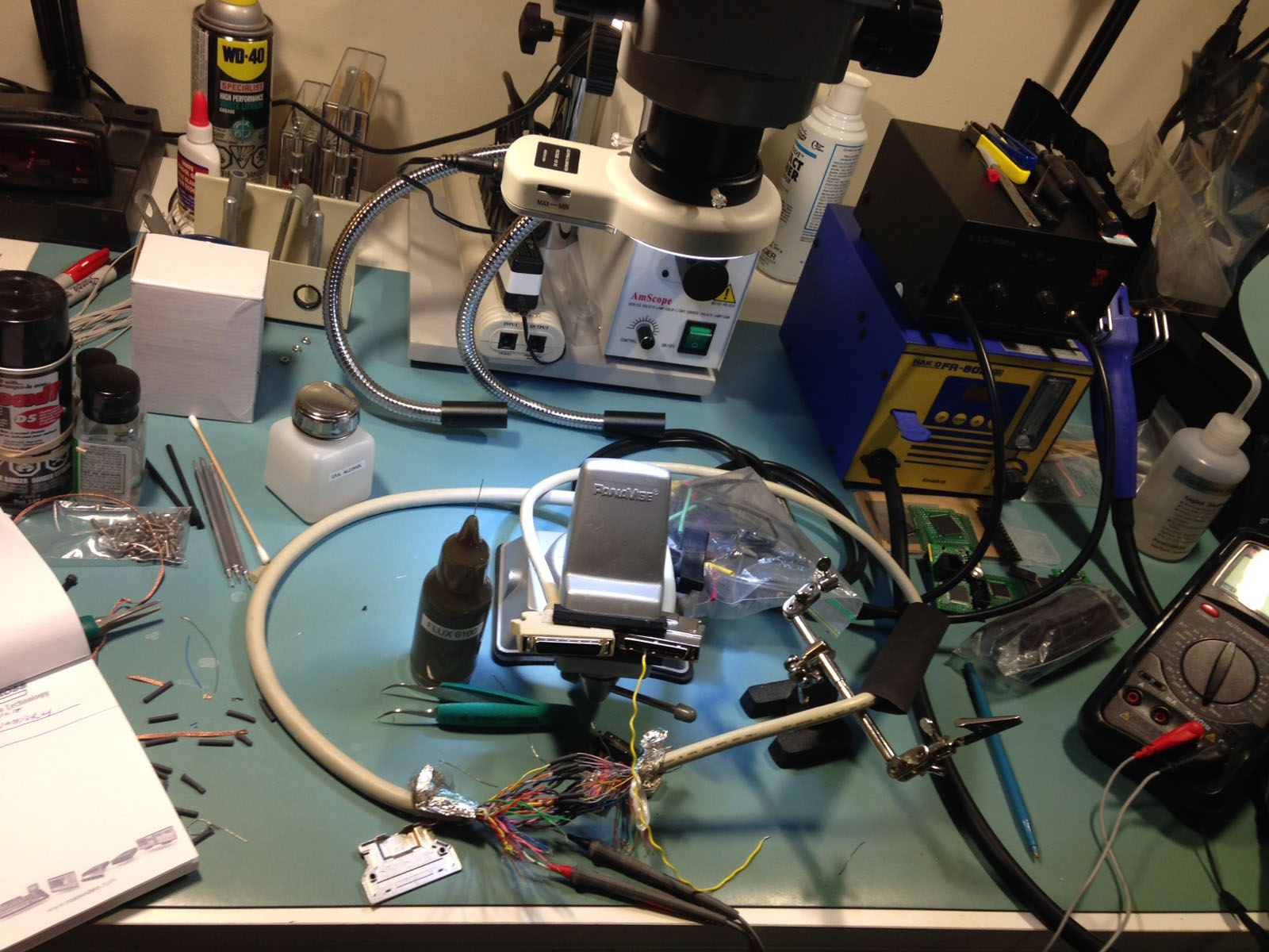

    I got impatient and decided to map out all the Pinout connections between the MDR50 and HD50 SCSI interfaces. This is usually 1 to 1, however it depends on the cables that you are using.... if they are STP (shielded twisted pair)...and also if your SCSI interface is "Differential" or "Single ended". So you just have to make sure you get the right interface and pinouts between the two interfaces that you end up using.

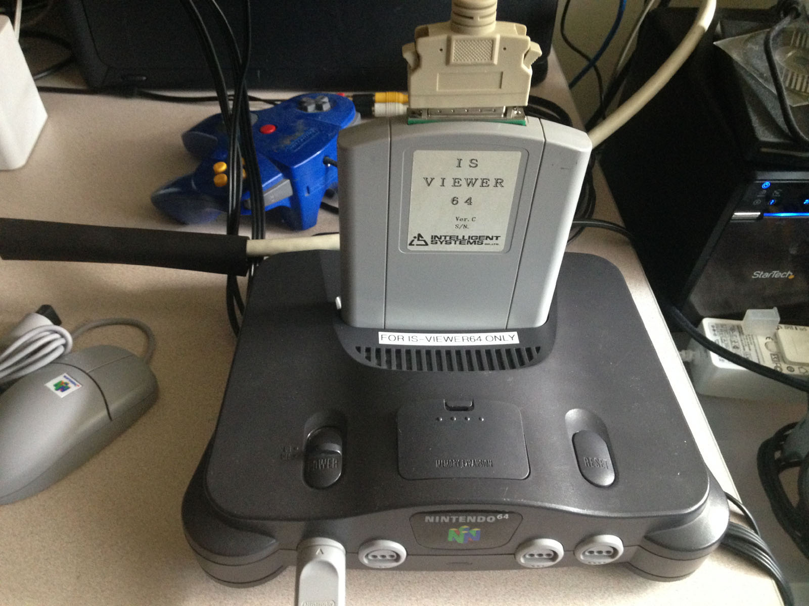

    Anyhow, I got it all mapped out based on my hardware and soldered up my own custom cable in the Lab.
    I then setup and configured my SCSI-2 interface card on my PC, and got everything setup for Windows 98.

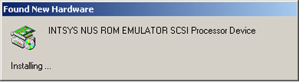

    After rebooting....Right away Windows detected the IS-VIEWER64 Cartridge hardware.....
    I was super psyched at this point!! (*#*&@@!!!
    I then realized.....CRAP!!!
    A Special "Intelligent Systems" Software Driver is required by Windows. This provides any application software being used, the ability to communicate with the IS-VIEWER64 hardware using SCSI-2 protocols.
    DANGNAMIT!!! (*#@*&@!!:eek:
    So this is where I am at....
    Success with the SCSI interface....but stuck on a blasted Windows Software Driver.:confused:
    I'm betting there's an IS-VIEWER64 Floppy Driver Disk out there somewhere....

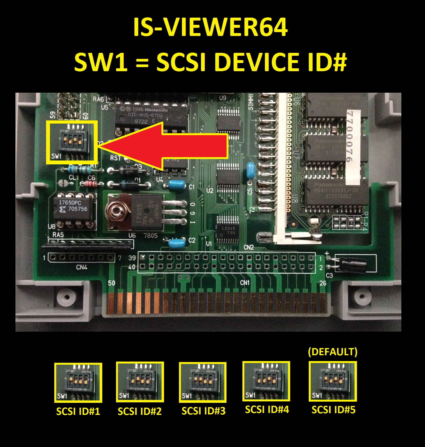

    I just wanted to add a note here for future reference...
    Something I recently discovered during my Debug Testing with my IS-VIEWER64....
    On the cartridge PCBA there is a DIP switch labeled as "SW1".
    This appears to be the same switch used on both models of IS-VIEWER64 that I have seen so far.
    Anyhow,
    I discovered that this "SW1" is used to set the Cartridge SCSI ID# on the SCSI BUS. As there have been several references made in the online manuals and in other documentation, about how Game development Studios could have multiple IS-VIEWER64 Cartridges installed and connected to a single Development Station.
    This allows the developers to have the IS-VIEWER64 cartridges located at different locations within the Studio for WIP code demonstrations.
    SCSI-2 Narrow permits up to a maximum of (x7) devices on a Single BUS. So (x7) IS-VIEWER64 cartridges per Dev PC please.... LOL. ^_^
    I'm not sure how many Game Studios actually had that many systems....but in any case. I've tested this and have managed to allow my DEV station to detect the IS-VIEWER64 with various SCSI ID# settings.
    Some examples in the image below and for future reference:
