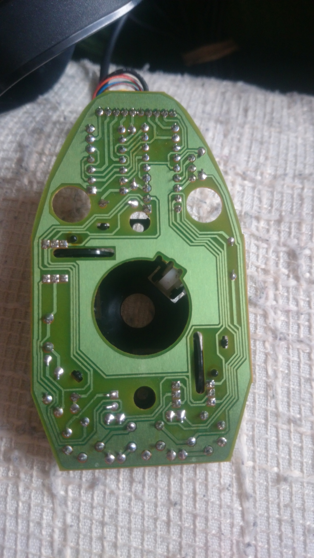

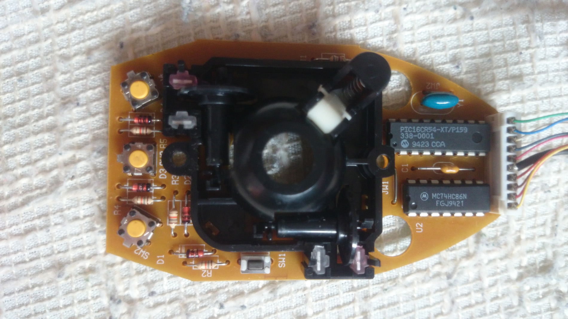

    Finally I bought a Mega Mouse, very cheap, indeed. I had made some photos of the inside:
    When I had time I'm planning to make a board schematic with any electronical design application (Proteus, etc.).
  4. Bad_Ad84
    1,308
    Well, unless you can dump the pic - its not much use.

    I think I can read the pic with a pic reader. If I can dump the code I will upload it.

    I just pulled mine out and popped it in my GQ-4X programer. Code Protect = On.
    Shit...
    Yus likes this.

    I would be really surprised if it wasn't ....

    I'm far from an expert, but a little googling suggests that you need to decap the chip and zap the part of the die that contains the write protect bit. I'm not sure how this would even work on a write-once chip like this.
    Or you could try to functionally reverse engineer what the chip is doing. With a basic device like this, it's probably pretty straightforward.
    Both of these options are over my head at the moment. I just thought I'd try reading it on the off chance it wasn't protected. I don't think there is enough of a demand for the end product to justify pursuing this further. There was barely enough initiative to get the Saturn mod chip cloned. I'm pretty sure you can thank BadAd84 and company for that.

    You could reverse engineer it by building something that sits between the mouse and console and logs everything that is sent/received to a PC and then play a game that uses the mouse. If you can figure out all the data packets the mouse is sending back to the Genesis hardware, it should be possible to rip bits from an existing mouse (even an optical if you could find one with sufficiently-hackable guts) and build your own mouse from that.
