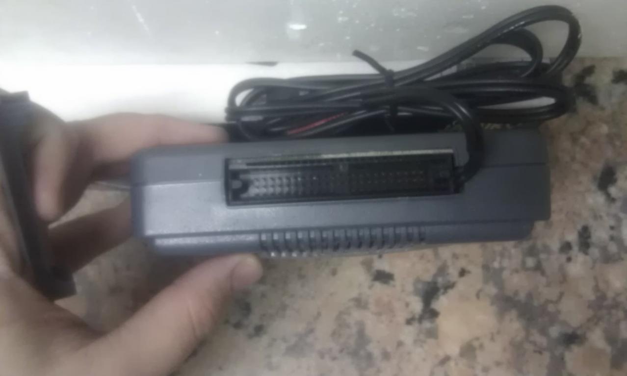

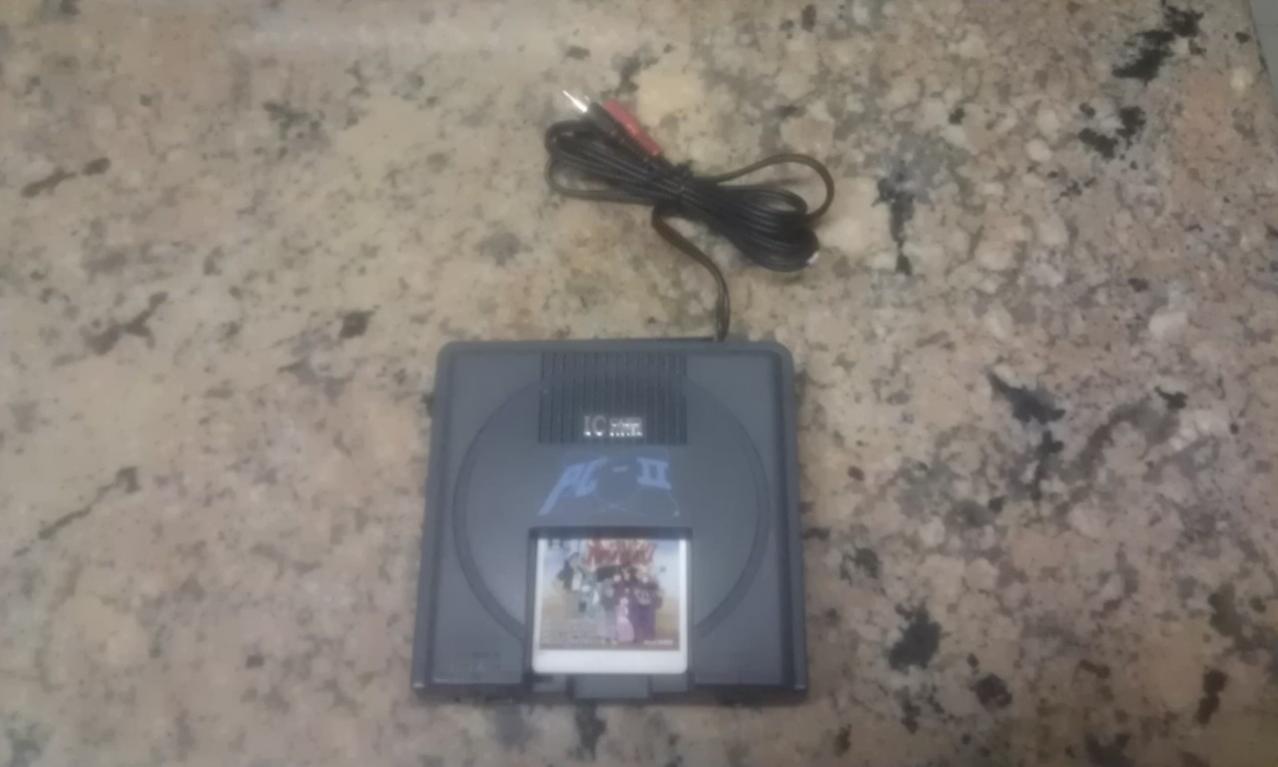

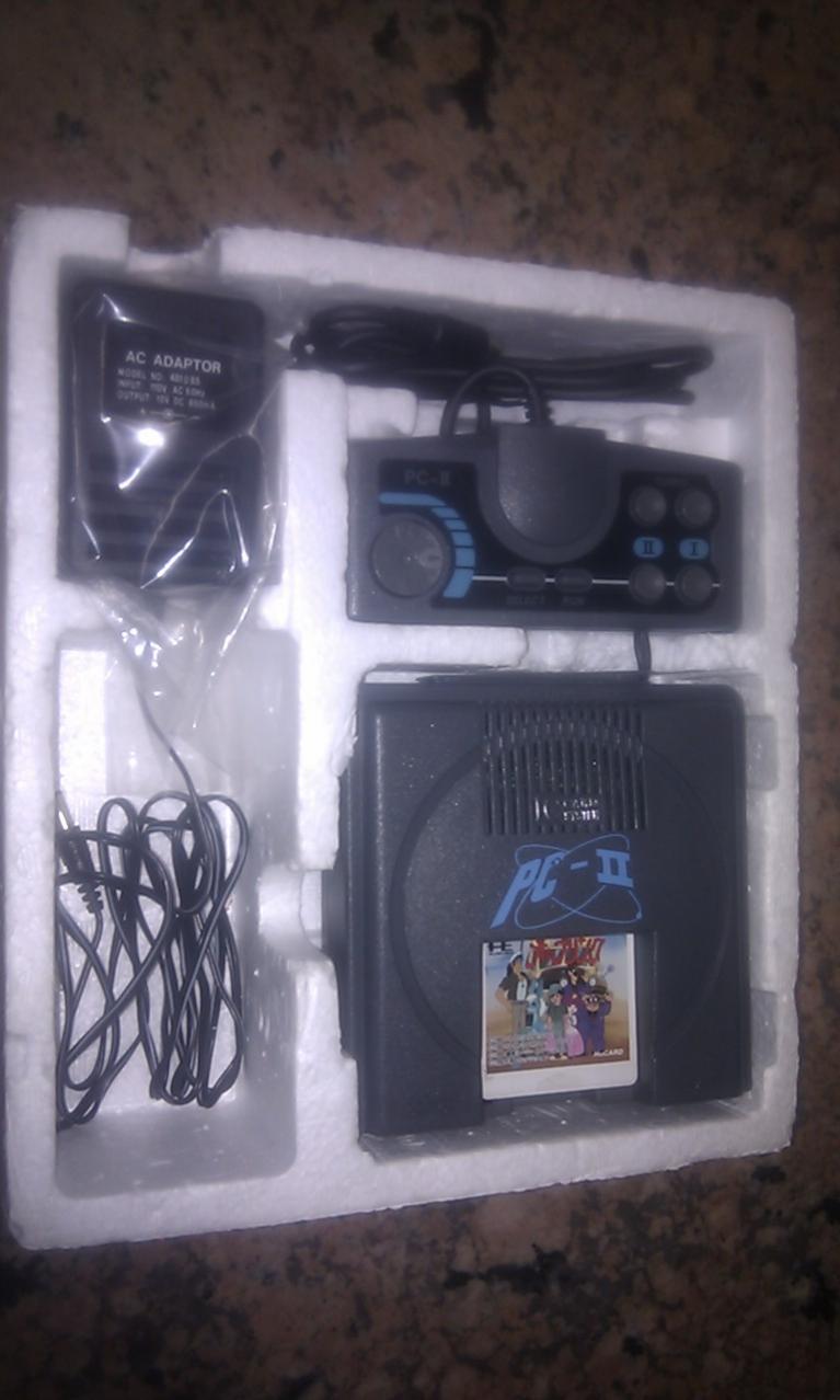

    Hi every one, I hope Im in the right section, but Ive recently been given a Jamiko PC-II IC Card system console , but I dont know anything about PC Engines and would like to get to know a bit more about the console, for starters if its an official PC engine or a Clone system as I cant find much on Jamiko.

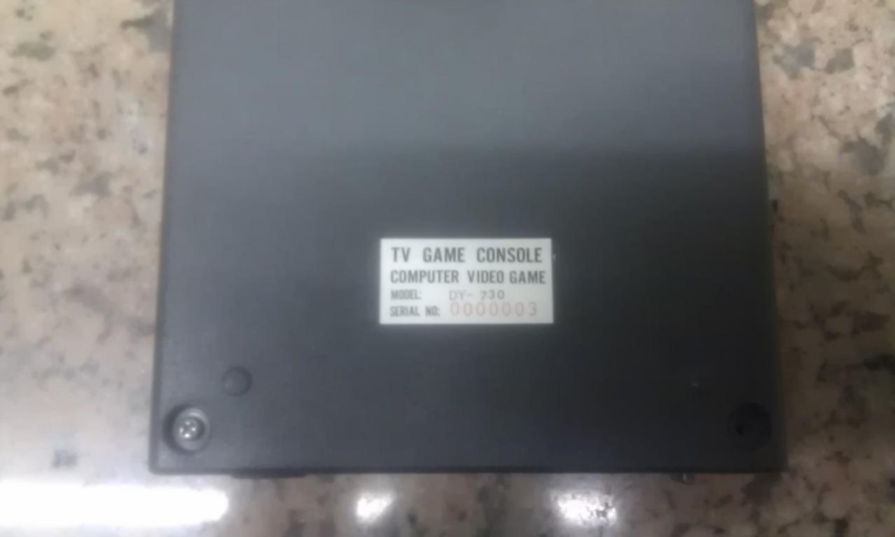

    Other Strange thing about it is that it has a AV cable coming directly out of the console where the expansion port is, and the serial number is very low (00000000003) I honestly have no idea about PC engines so any info would be great :)
    Heres some pics:

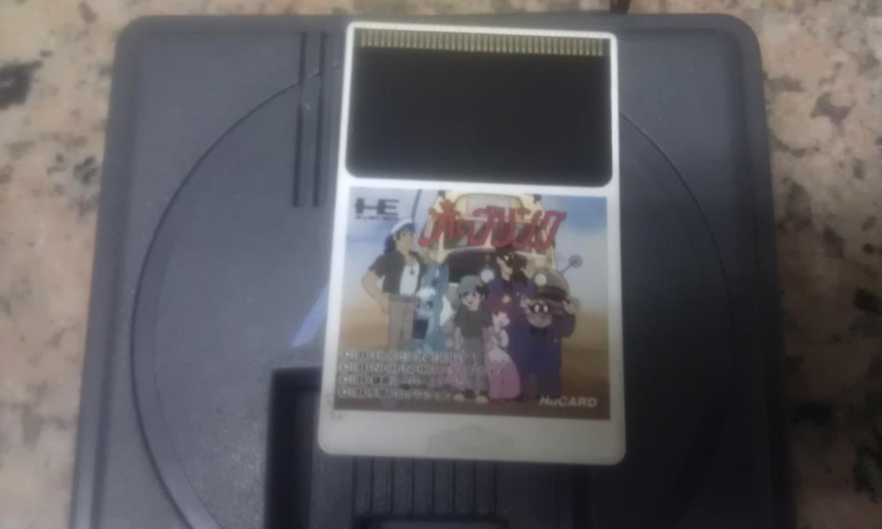

    Oh and allmost forgot it came with a game.

    My initial assumption would be that it is a clone but only because of the controller, which has actual turbo(?) buttons above the normal buttons. I've only ever seen controllers with sliders to control the turbofire and controllers that lack a turbo function.

    So its a clone then :)

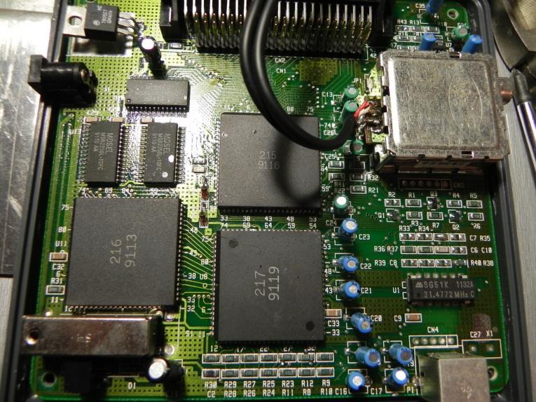

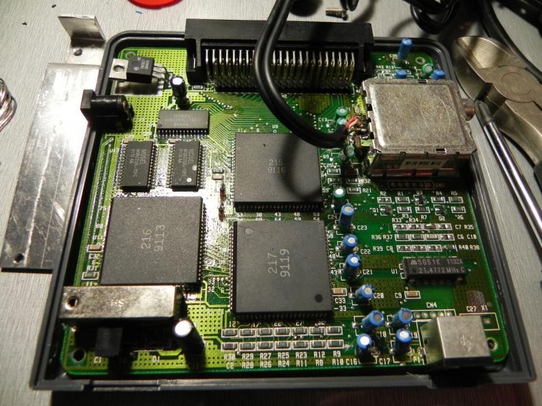

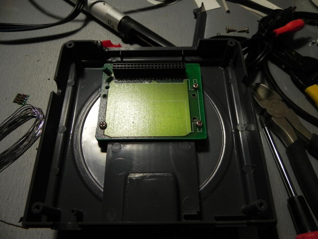

    Sorry it took so long to respond (worked flew me out due to an emergency) None the less I disassemble the console , it only had four screws holding it together , and poped open surprisingly easily.
    The Expansion port appears to be connected to the IC marked "215" but its hard to tell because most of the traces lead to random Via's ,not all of them are visable(the PCB has to be a multilayered one)
    You cant see what chips they used as all of them are only numbered with no other markings, the transistor had a huge heatsink connected to it (its on the left of the console)
    The AV out was definatly after market , as they cut into the case to actually get the cable to fit, ts connected in parallel to the RF Box, Im probably going to remove it and fit something better :)
    I know my only concern was that it might have been a system on a chip or similar bad clone, but opening it has put me at ease a bit it seems pretty well made and the controllers actually feel pretty decent , I actually review famiclones on my channel and somewhat collect them, some are pretty good, others terrible, its just with this one I dont have much to compair it to :)
    Ps Does any one know anything about the game that came with it??

    This is an original design due to the PLCC chip packaging (still common in bootlegs). To me it doesn't look particularly well-made, but it's interesting. I don't think it's by whoever made the other PCE clones.
