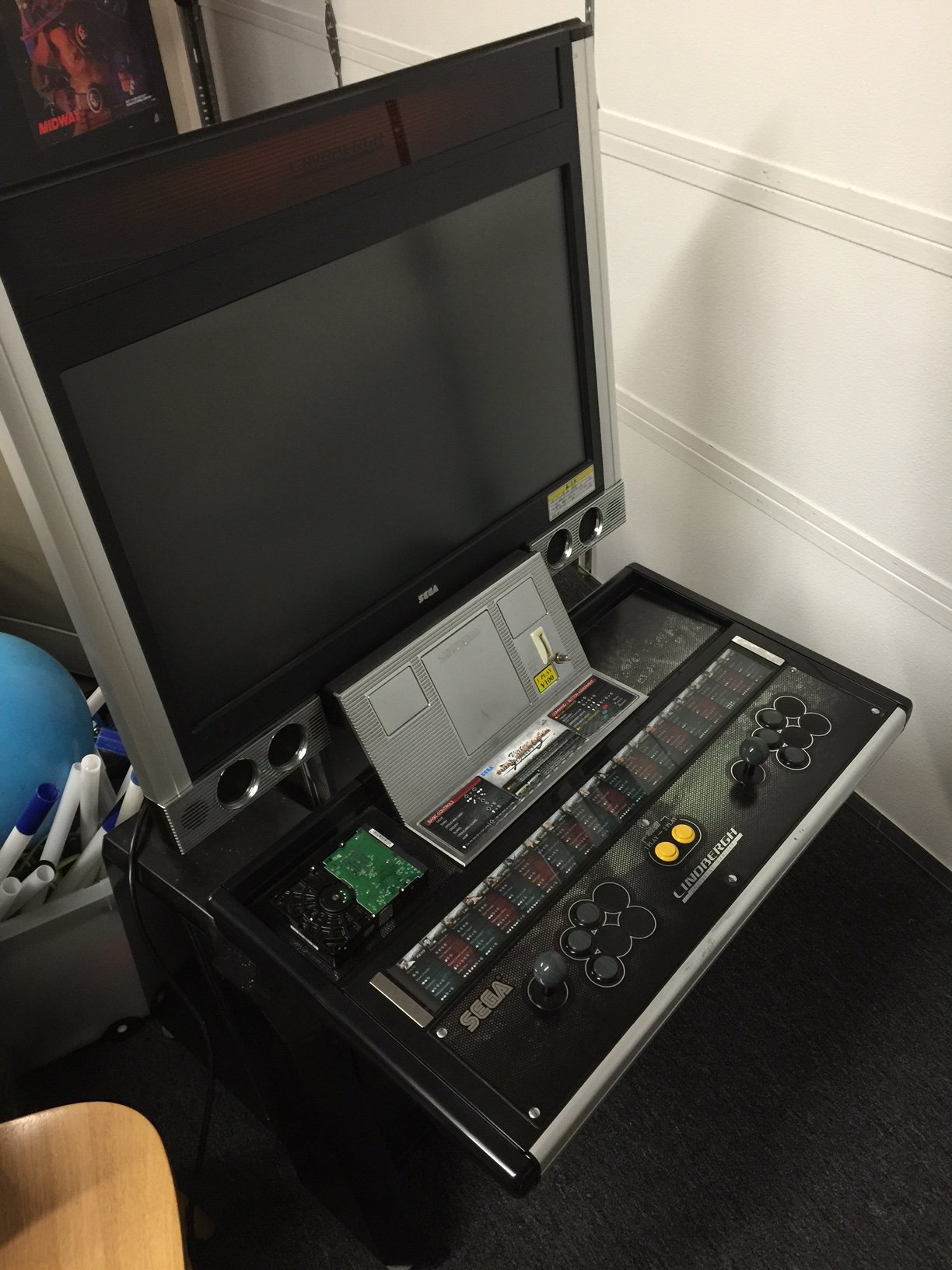

    Yep bought a Xbox 360 hd-dvd drive just for that reason. I'm not sure how to get a key chip though, can it be any key chip? I would love to get VF back on there so the cab panel and marquee match what's on screen, at least some of the time. Oh and if this works, got a pic attached here too. Marquee isn't attached but ive got that too. image1.JPG

    Nice cabinet, I love those Sega HD ones. Really wish I would get one with Virtua Fighter 5, and of course a Lindbergh Yellow to run VF5 (sure wish they would announce Virtua Fighter 6 already).
    Is the key chip socket of your Lindbergh Yellow empty? It can be seen in the picture below right (not my picture) under the left power connector. If yours is missing the key chip, that black thing will not be there, just a hole to insert one.
