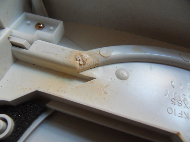

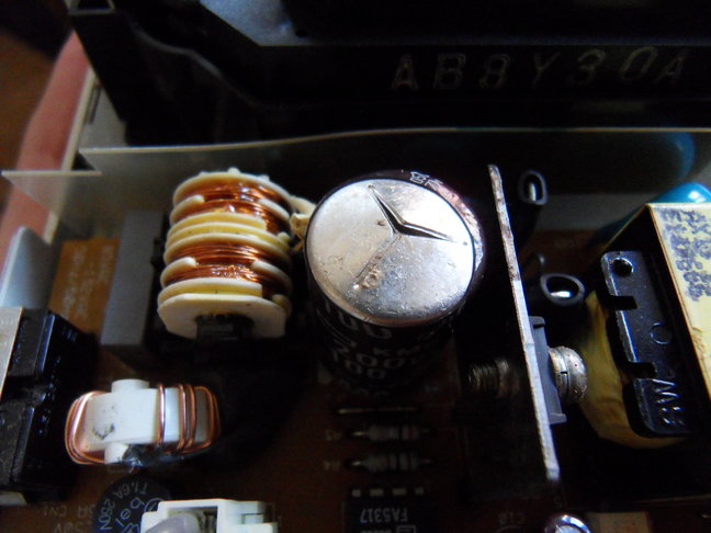

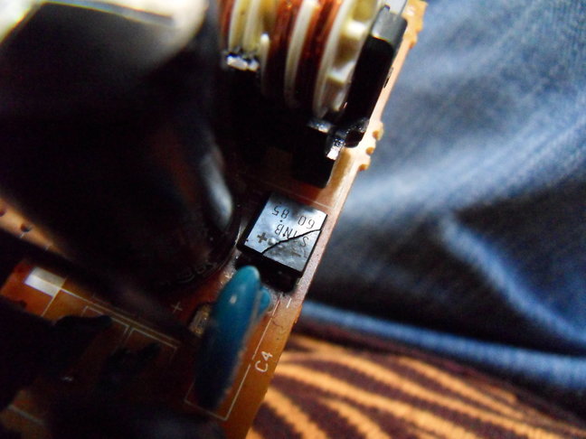

    Picked up a Japanese Dreamcast a few years back. Didn't work, but I had a US system to play. Just decided to open it up and have a look at it and found the following. The large tubular 'componant' on the PSU looks like it fried, as it has left a corresponding scorch on the upper plastic. Also on the PSU board there is a small chip next to the large one. The board underneath it is blackened, and the chip above looks like it's cracked. I think I know the answer....just get another system. But I was just wondering if it was actually repairable.....just as a little project. I have attached some pictures so you can see what I mean. Any advice will be gratefully received.

    Seems to be your PSU is fried.
    The cheapest solution is:
    - The tubular component is a capacitor, you can easily replace it.
    - The S1NB is a rectifier, you can replace it http://www.diotec-usa.com/01s1nb.PDF
    Eventually you'll have to change the fuse.
    But the safest is to buy another PSU, if possible a 110/200v to avoid another blowup.
