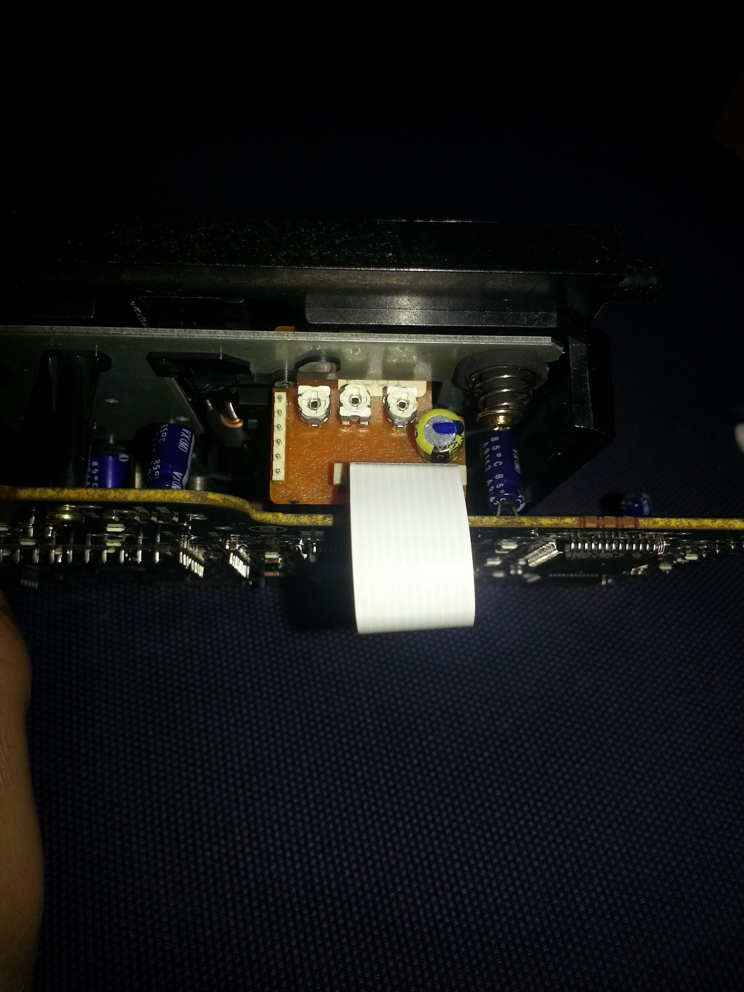

    I see there are 3 parts inside the Mega CD: The CD reader, the board where cables are connected and the board where chips are soldered into. There are capacitors on each of those three parts. Should I change the capacitors of every boards?

    if you are capable enough, you might even want to replace the two capacitors on the optical pickup circuit board (if it's SONY KSS-240) ...
    These capacitors have a expectancy of service life around 30 years. So they're well around their limit.
