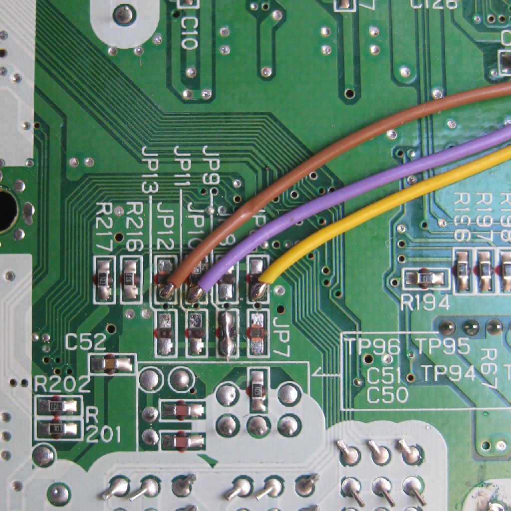

    Just a quick question, I've got my hands on a japanese Sega Saturn V11 and after fitting a 220V PSU from an old PAL Saturn, I've tried to install the switchless region mod. Somewhere along the way, my train of thought derailed regarding the correct jumper setting. As of right now, it looks like this:
    The Problem is, it reads japanese games just fine, but EUR/PAL games still come up region locked.
    What are the correct jumper settings for this JAP-NTSC model?

    I'll withdraw the question, I didn't realize that JP13 was closed via a trace, after cutting the trace, everything works.
