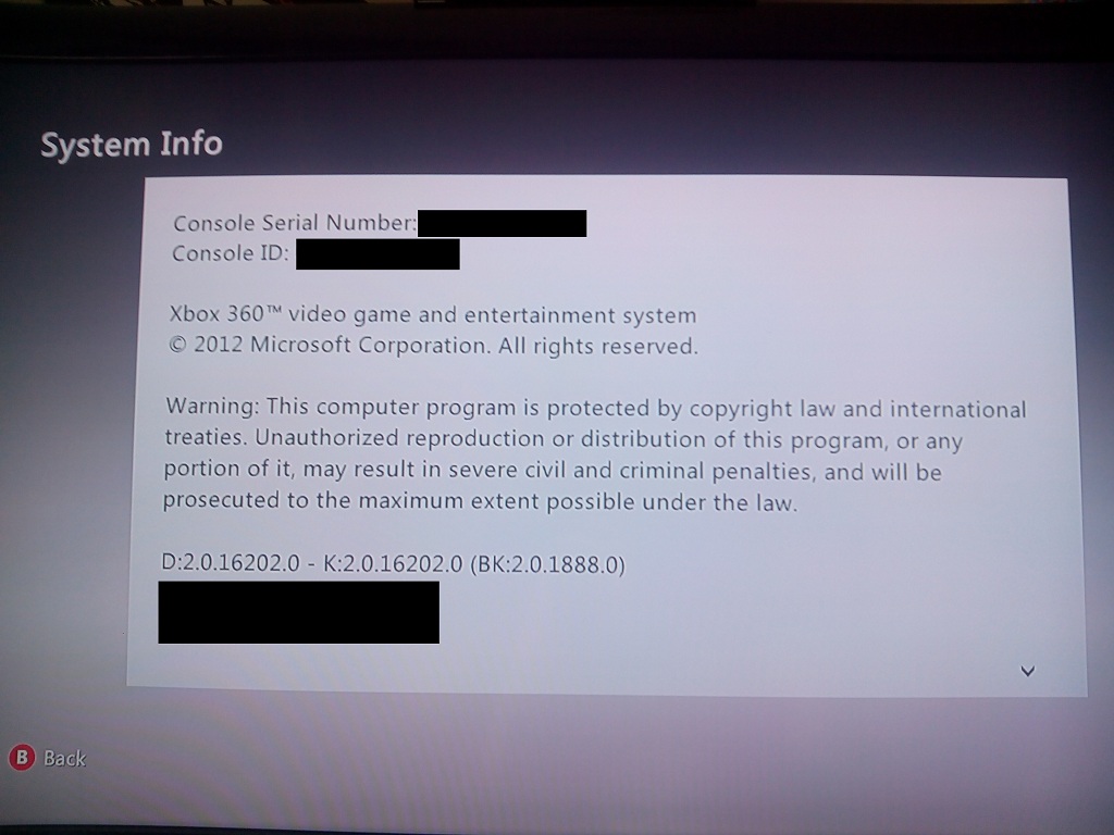

    It has the NXE dash, it's surely not up-to-date though. I've included the image of my system information:
    I contacted the service with my MFG and Dashboard versions and he replied saying R-TAG is the best option. How is it best to tell if I am actually getting the R-TAG mod done?

    16202 is the fourth latest dashboard, I wouldn't say it hasn't been updated in years, maybe a few months. R-JTAG is definitely the best option, after the mod is done, you can by the boot times. If they RGH the console then it is almost guaranteed to have a boot time of over 7 seconds, if it is an R-JTAG then it will have instant to 2 second boot times. The better way to tell would be to simply open the console, if it is RGH then there will be a small chip on top the video port labeled, "Xecuter Coolrunner." [​IMG]
