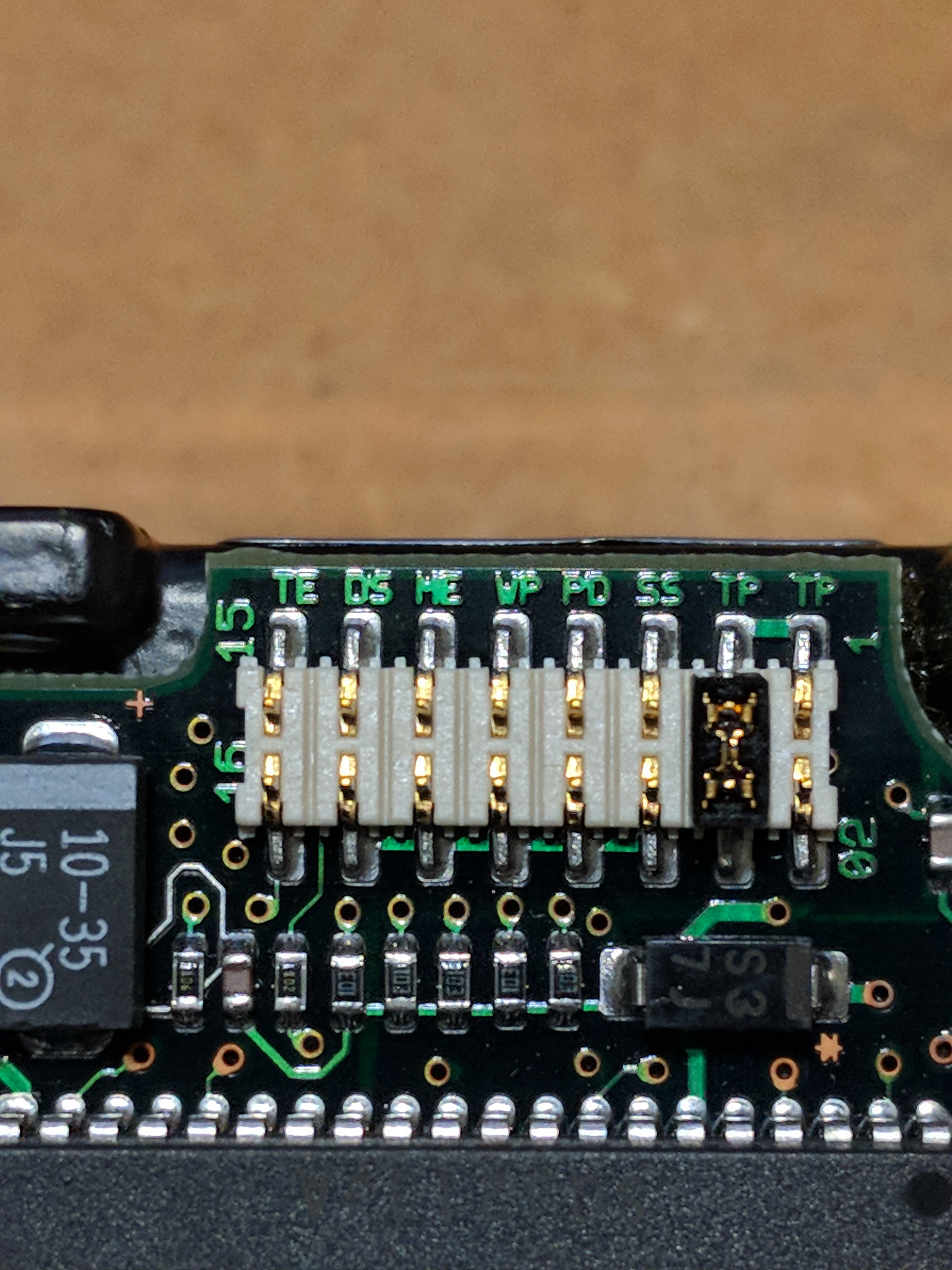

    This is the jumper setting on my drive.
    The model number is actually ST34555N.
    The lable on the drive shows a bunch of options that can be enabled with the jumpers, the one that is enabled is called: TP from drive.
    There is another jumper area to set an address, my drive does not have any jumpers there, so it's address is 0.

    Just checked on mine, it's the same with the ST34520N hdd:
    - J2: "TP from drive" jumper set, the rest not
    - J6 (address): no jumpers at all
