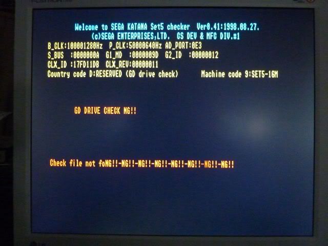

  6. MAkJapan
    MAkJapan Robust Member
    Dec 3, 2009
    274

    The only thing I have been able to do with the ratary switch is to make a self test and see gives error when the system try to test the GD rom
    It is the only thing that goes red!

    You mean this ?
    Don't worry, I have that too, I think the test just needs a special GD-Rom to pass.
