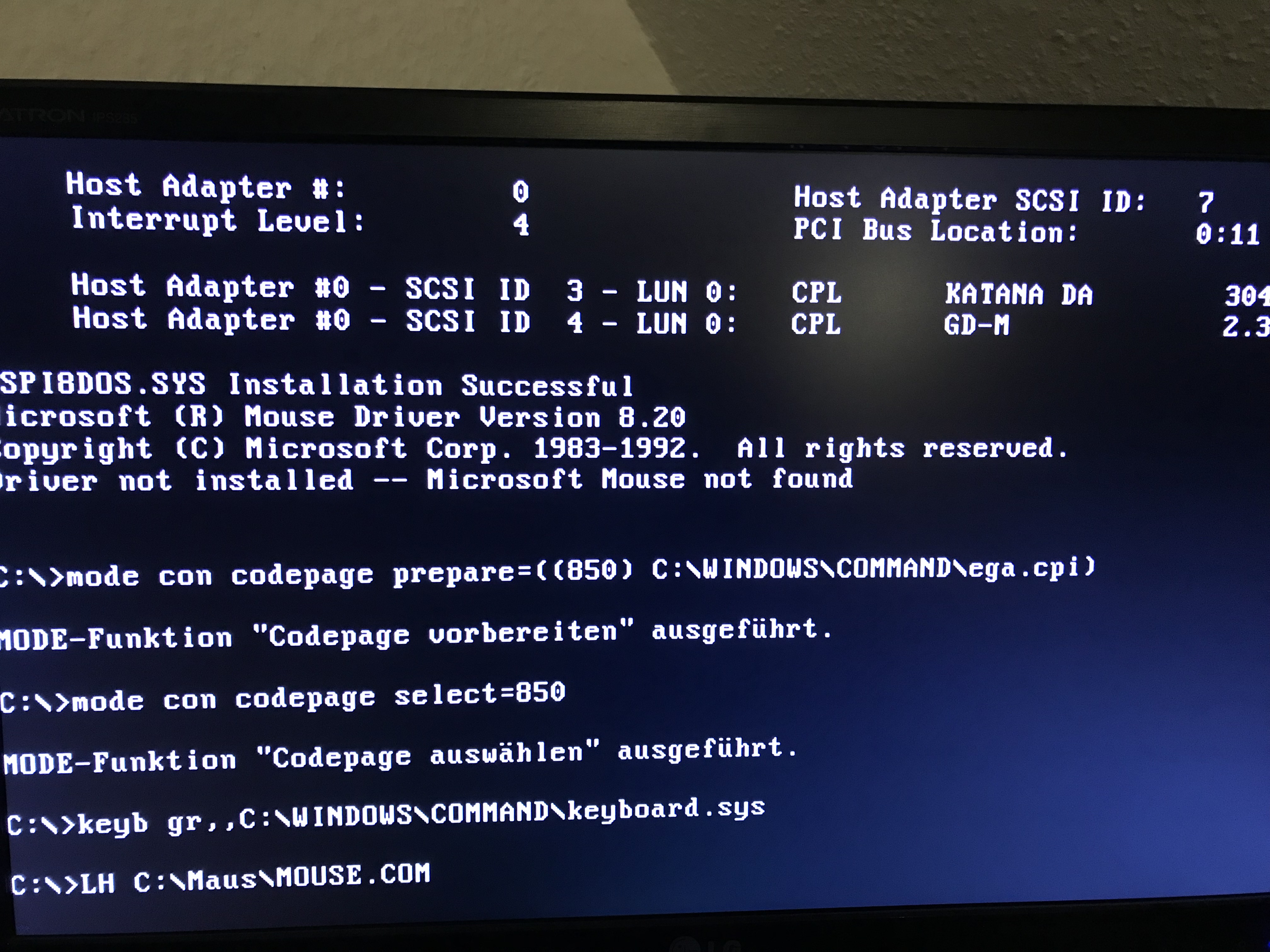

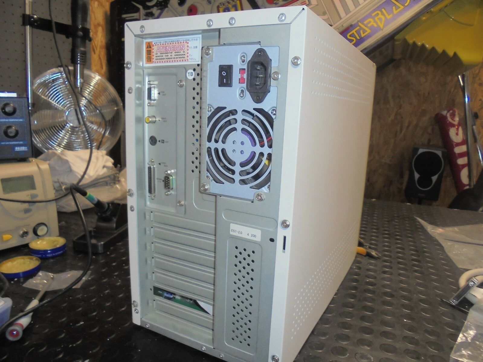

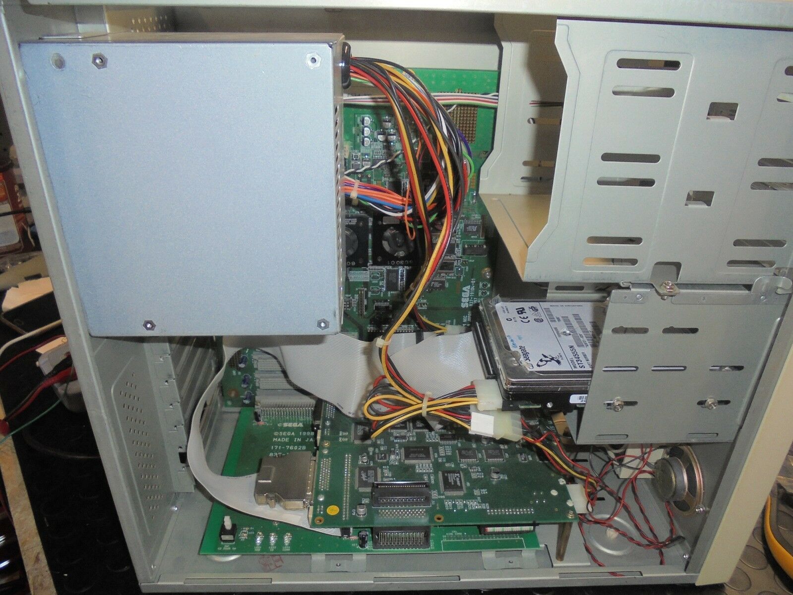

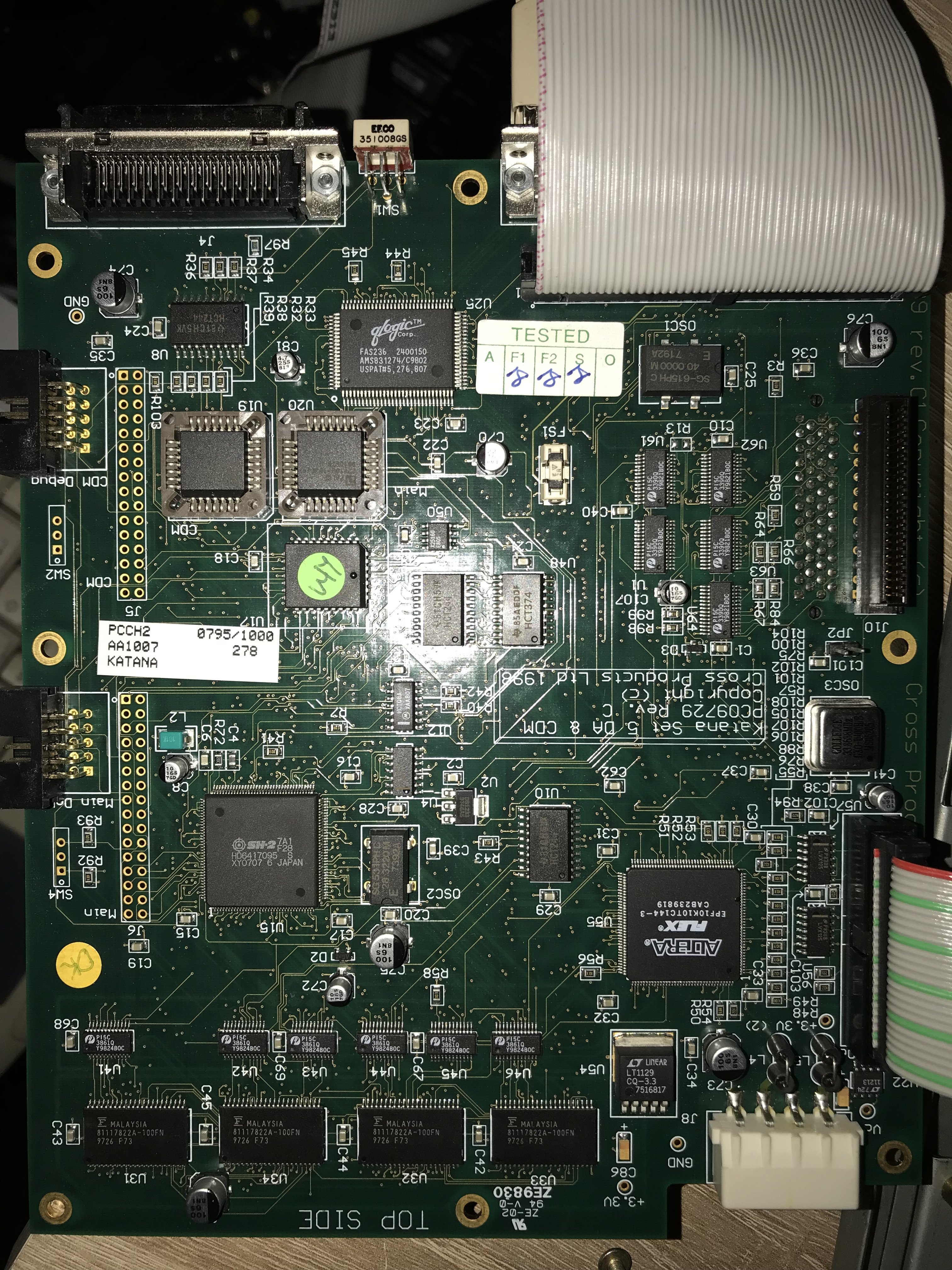

    Today i got the Kit. First i checked the connections. The I/O Board is a two Layer PCB with a Cross DA board on top.
    Strange that the Cross board is markt as SET5 as you can see on the PCB.
    The HDD on the system is dead. So i have to get another scsi drive. Manual say 4GB Disk with 2x2 GB FAT32 partitions. Im not sure if the controller also handle larger HDDs because 4GB Disks are fragile as hell and a working one stupid expensive..
    But ok.

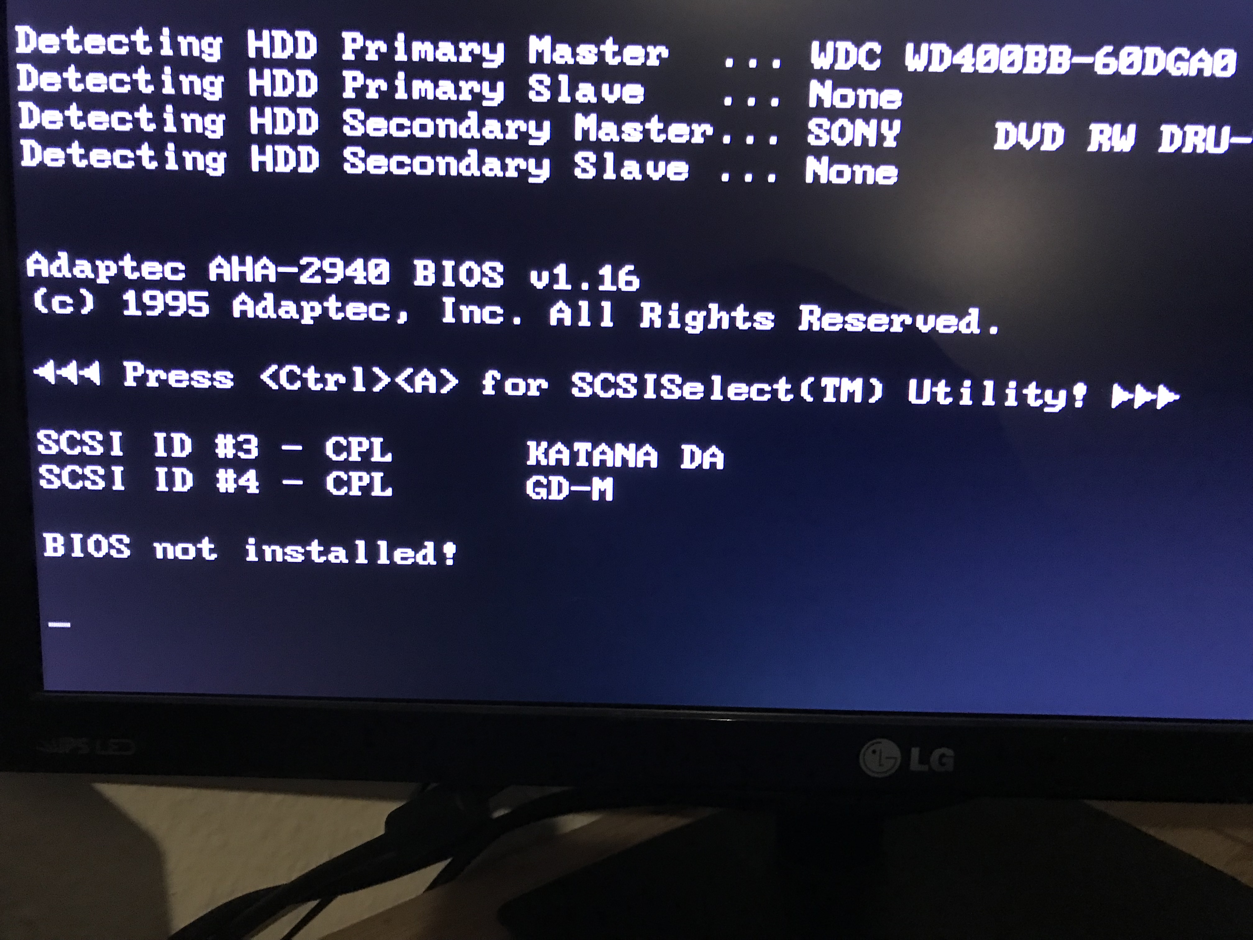

    My Host PC used a Adaptec 2940U PCI Controller with the latest WIN and DOS Aspi Drivers from the adaptec site.
    The Cross IO pcb has two scsi interfaces with ID 3 and 4. So i connected the 2940 on ID3 and terminate the ID4 port with an active termi.
    Than i boot the Set4 ( no BOOM at all :D). The Cross board has some LED for HDD, CD and communication. They flashing during the startup and go out after couple of seconds.

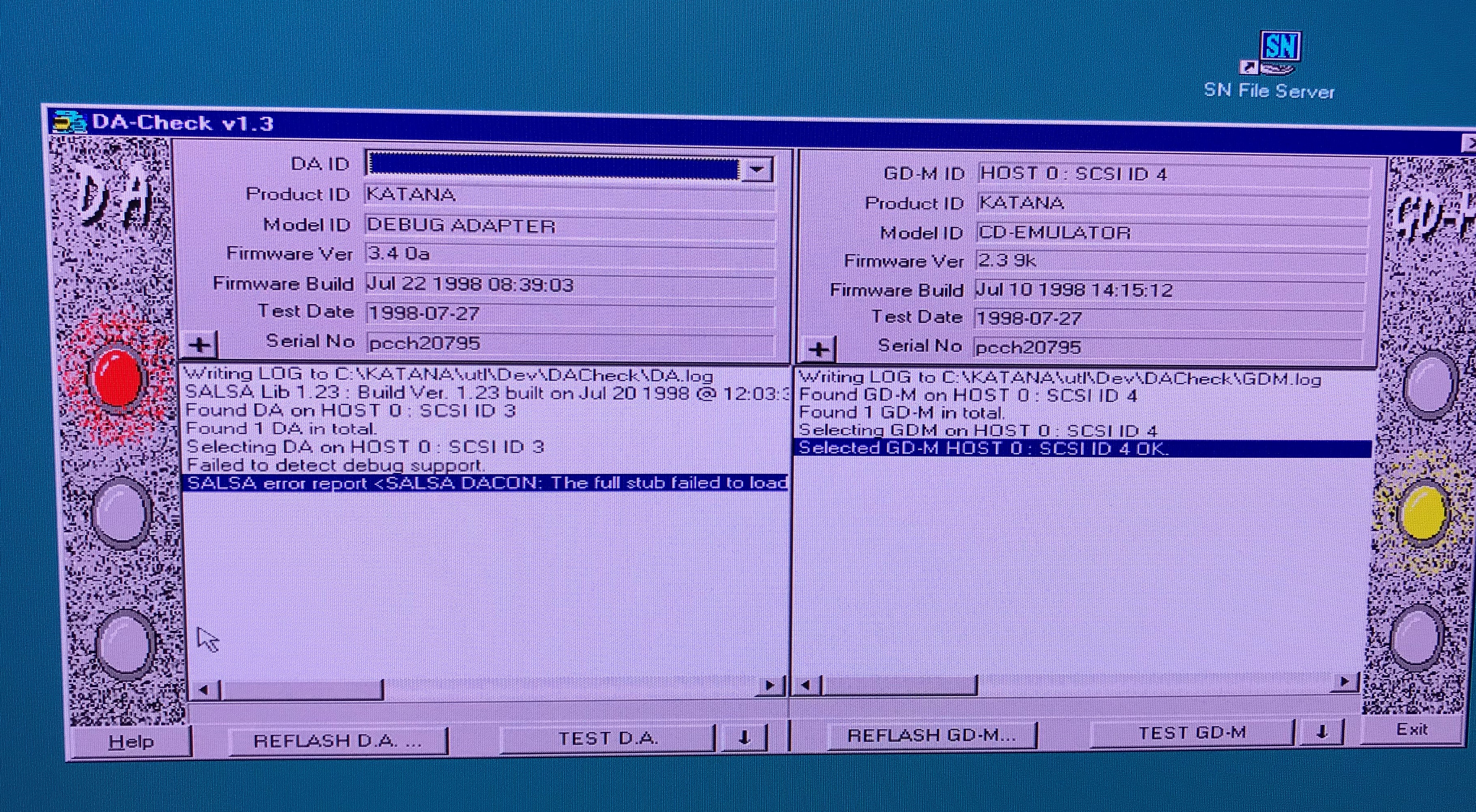

    The Host PC showing up the follow on startup:

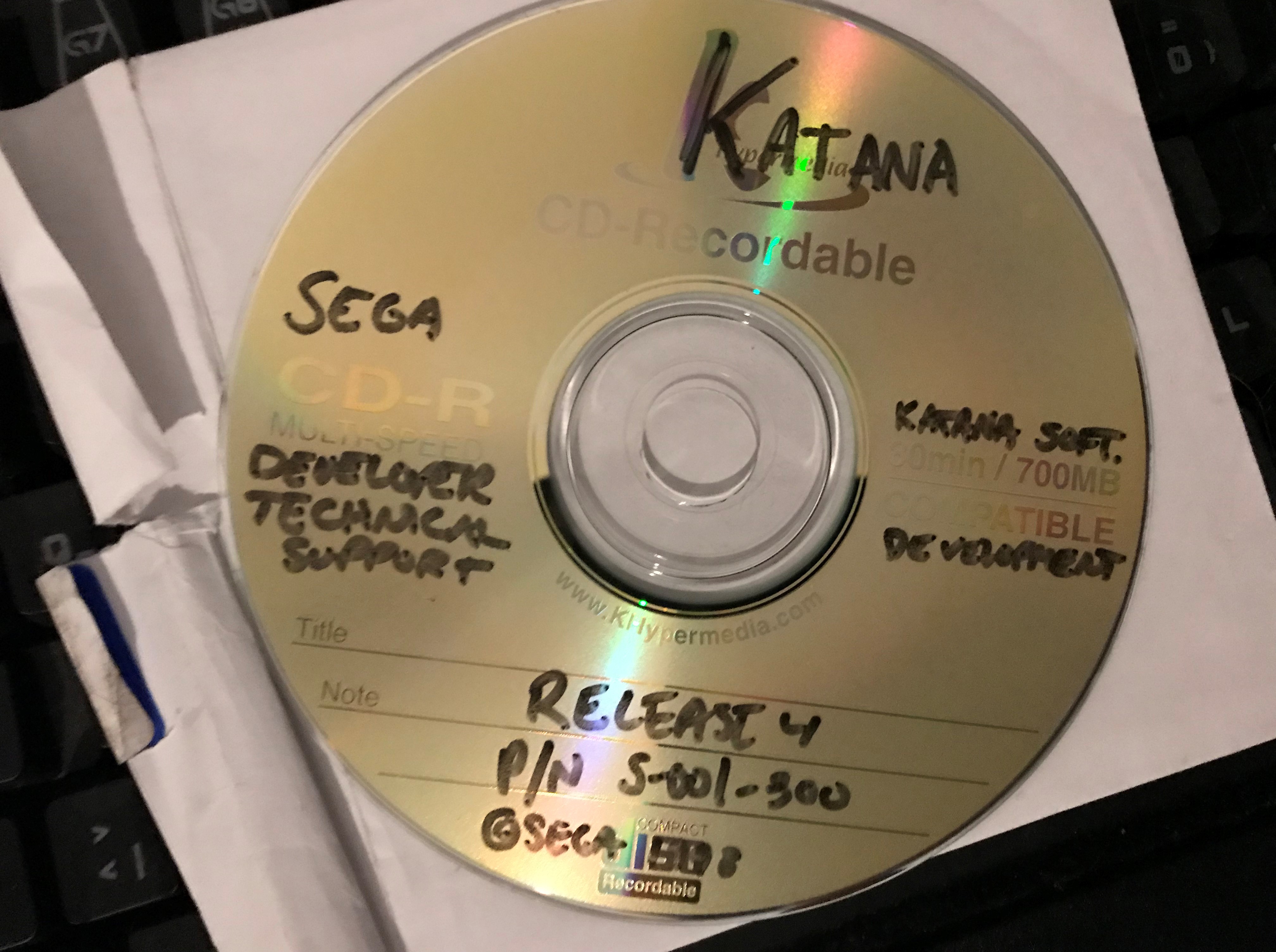

    On windows (win98SE) i installed the SET4 SDK. There also comes a disc with the kit with a different version i think 4.00

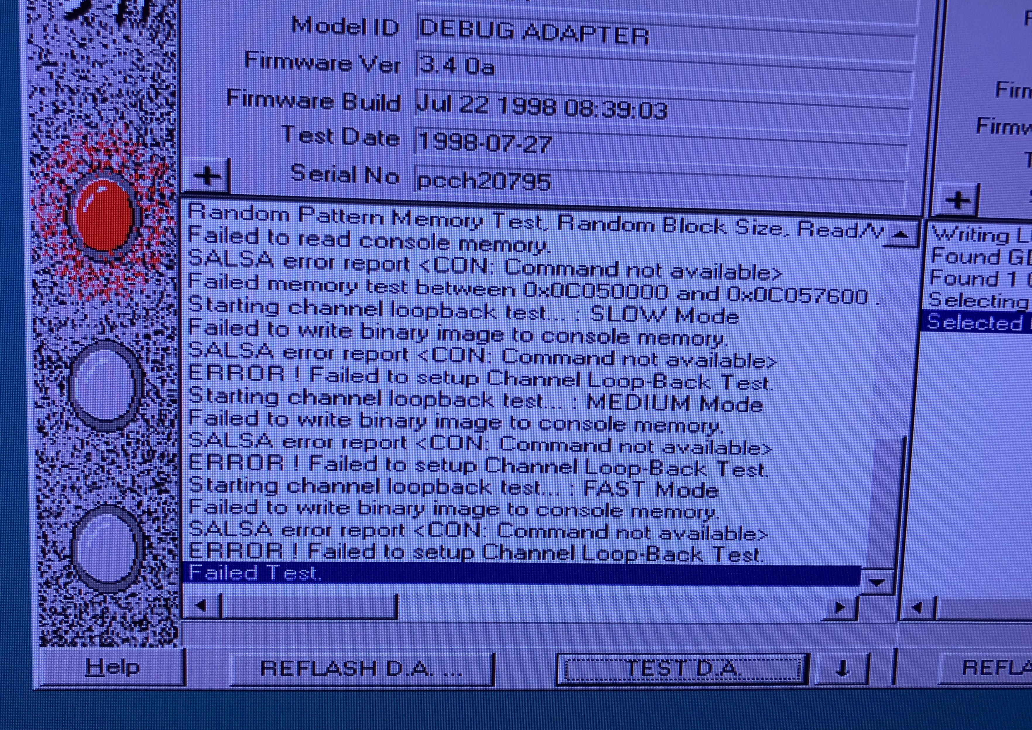

    So after that next step is DA-Check. But it gives me errors on the DA, the emulator looks ok cant test it without drive connected :
    So there a communication errors. I tryed flashing the DA and the EMU, works without problems. Anyone an idea what the DA errors can be?

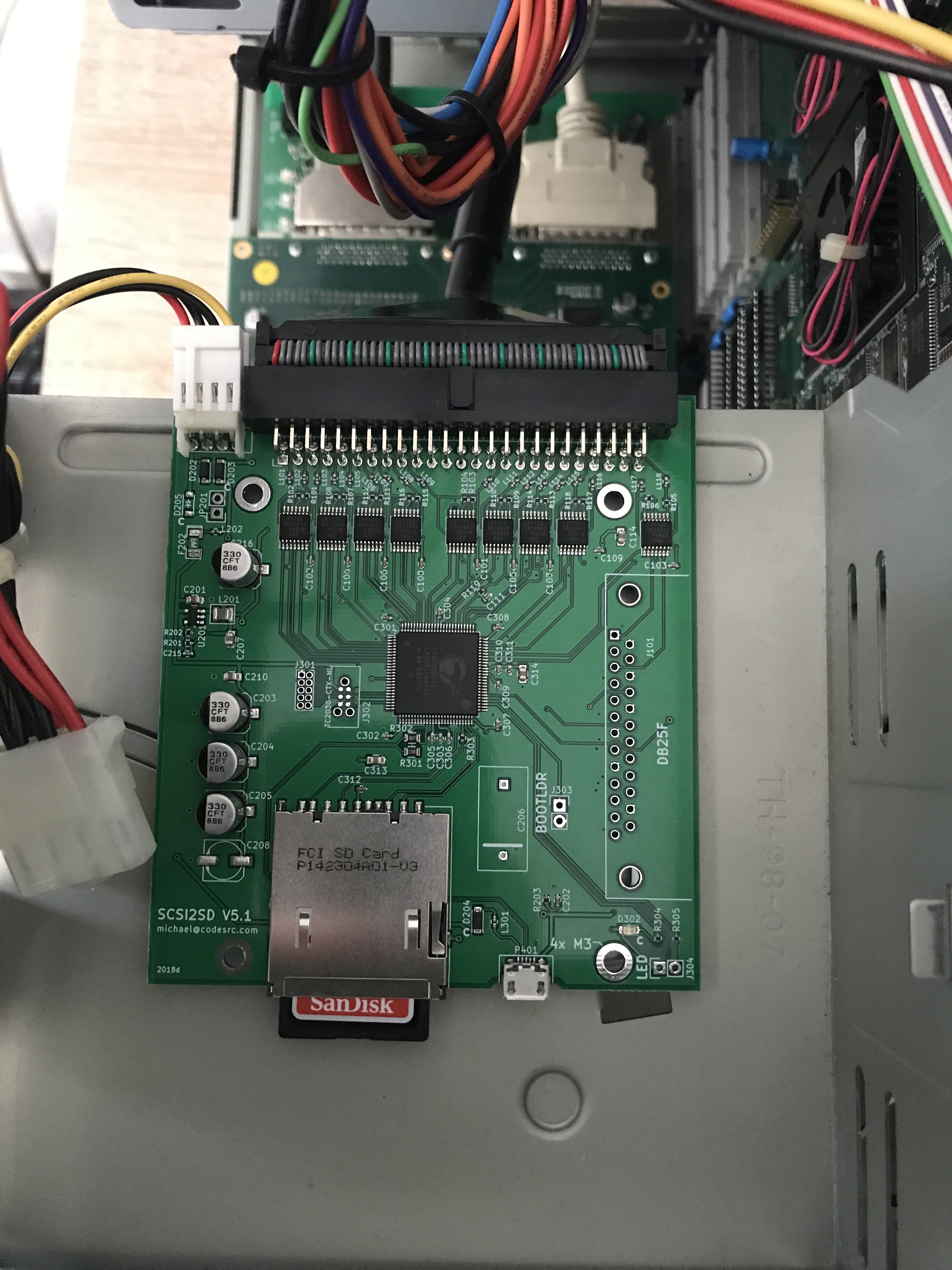

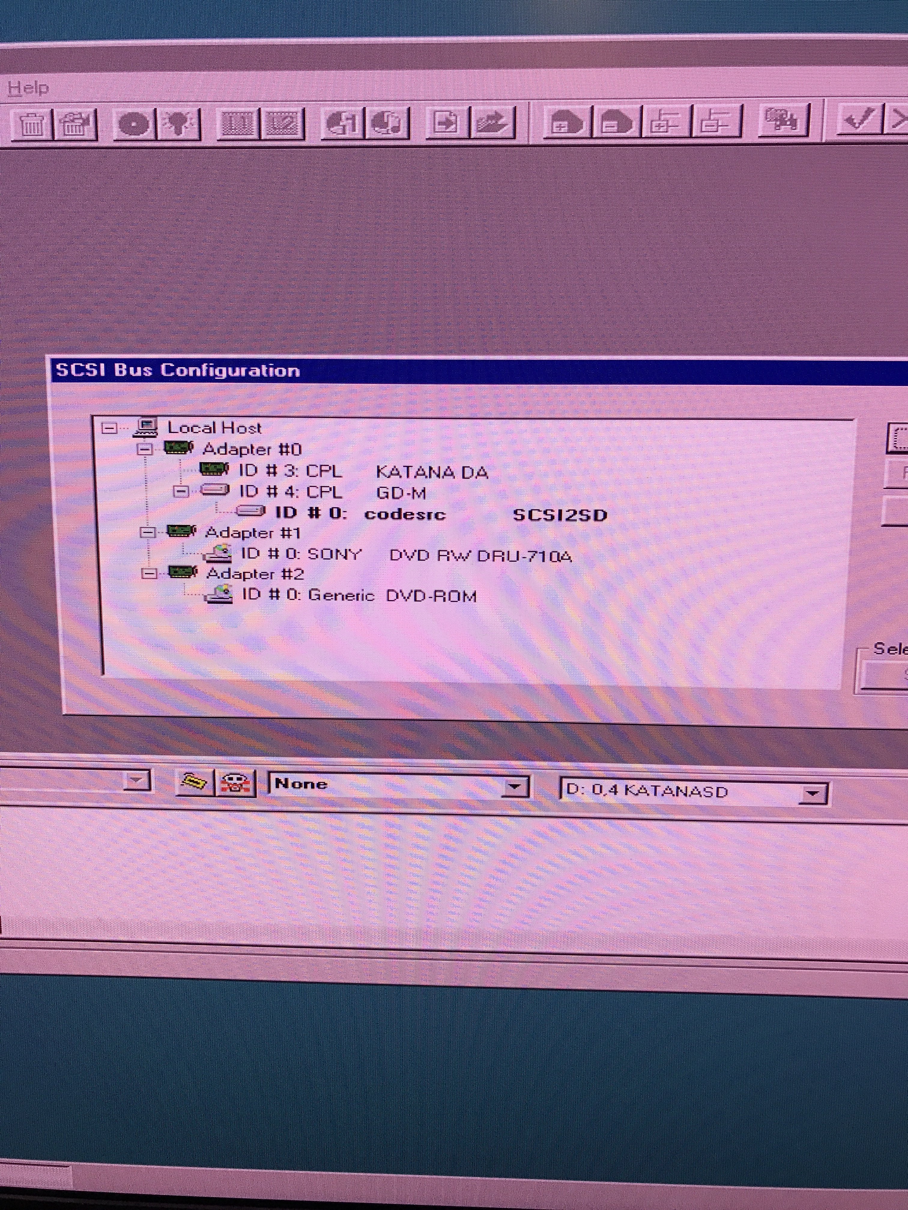

    Some update for those are interested.
    I replaced the hdd with a SCSI2SD V5.1 and GD-Workshop is working now

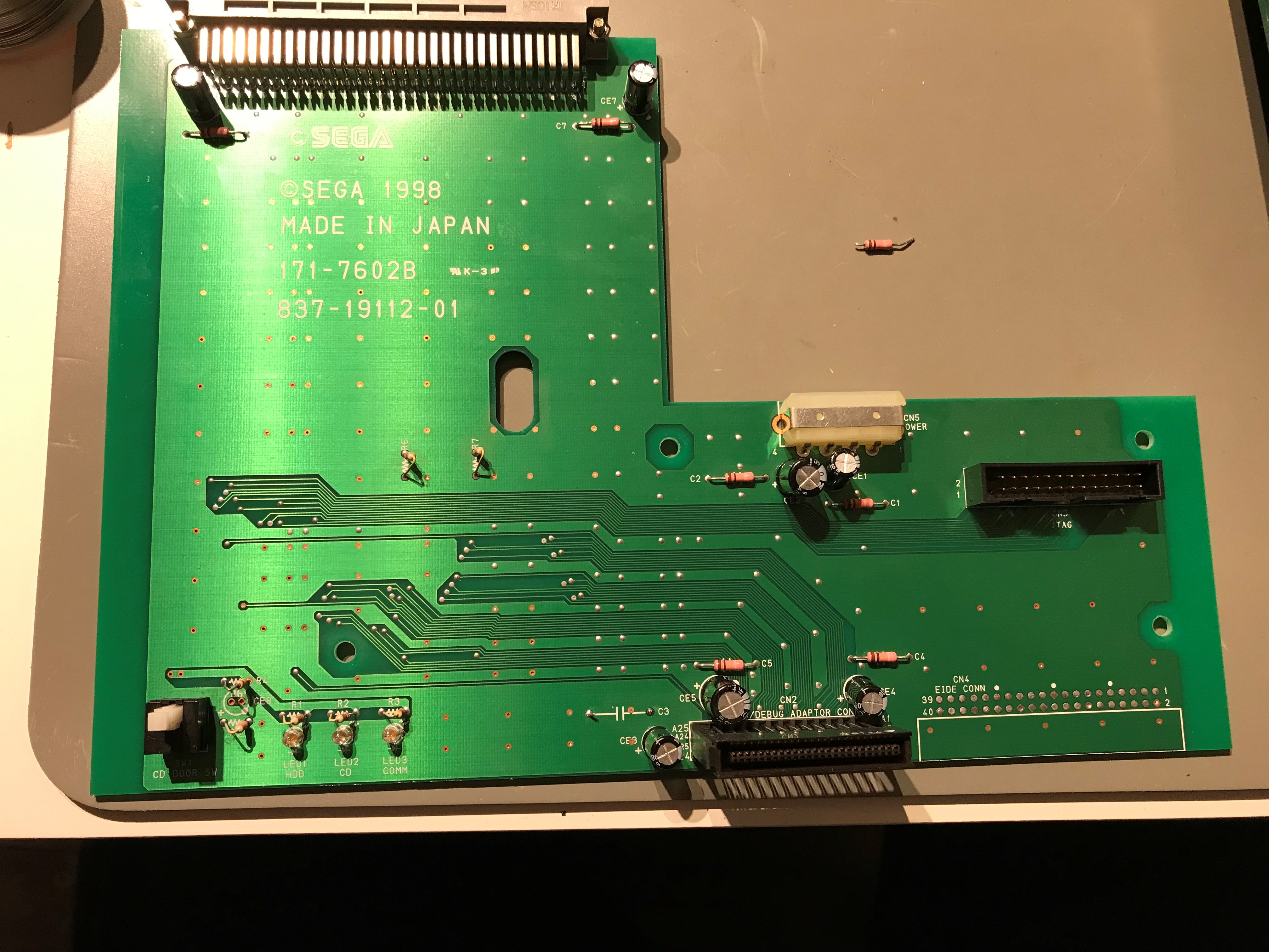

    After that i checked the lower interface board of the set4. Its between the set4 Mainboard and the cross board. The SCSI goes complete over the cross board and it work. So my DA problems maybe come from between. So i removed the cross board and build out the lower one. Both boards have a molex voltage connector so i start checking the resistors and boom most of them are gone.
    Only one on the upper left side has shown correctly 10k ohm, the other ones are start from - and go up till nothing.
    To be sure i desolder one of them and yes they are gone.
    So next step will be replacing all the resistors and caps on the lower board.
    Hopefully nothing more is damaged at all. We will see :)

    Resistors and Caps are new now on the lower board, but still have DA errors. On Startup DA-Check init the Cross board to switch the MB in Debug status and test the RAM on the Sega MB but here it comes to a crash. If anyone have a Set4 and can check with me the jumpers please let me know. I want to check this first before i go on the components, but will not give up..
    LuizNai and fafadou like this.
