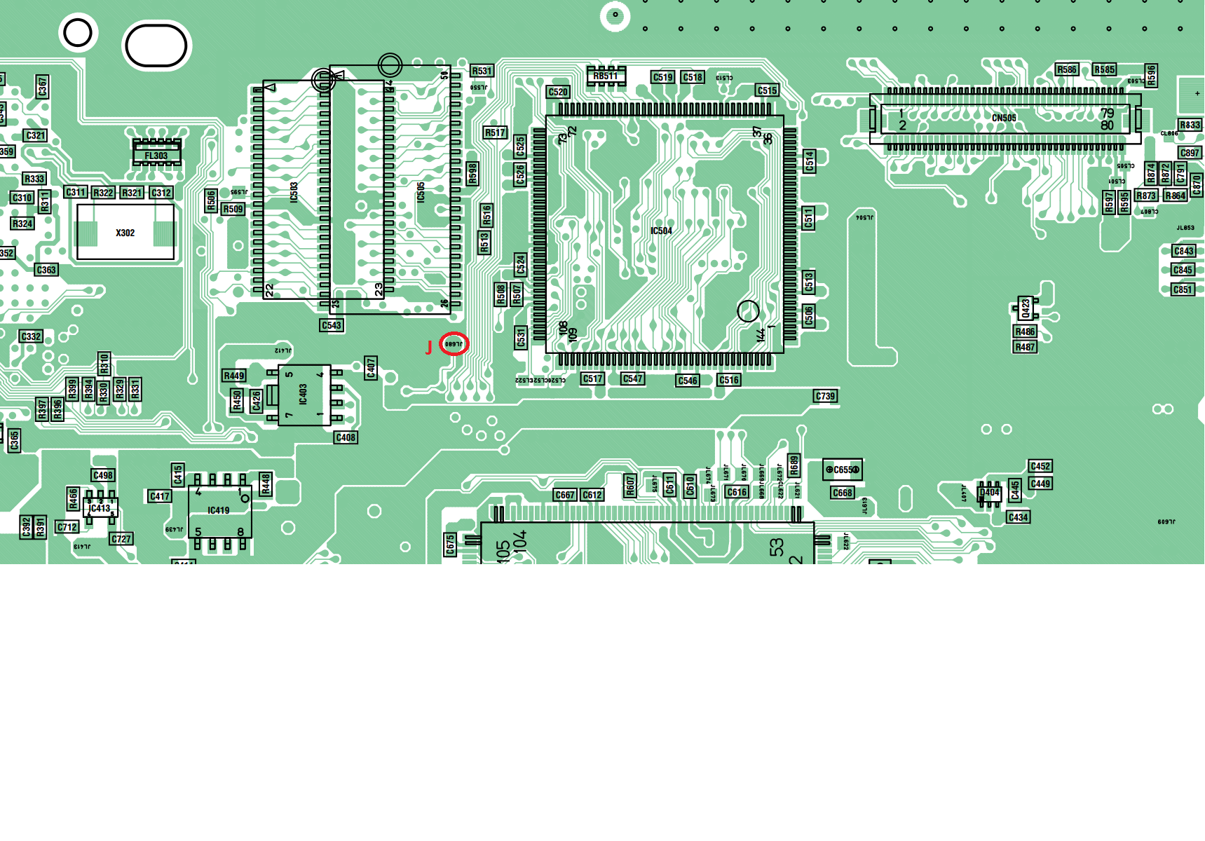

    J point (reset) - see attached picture.

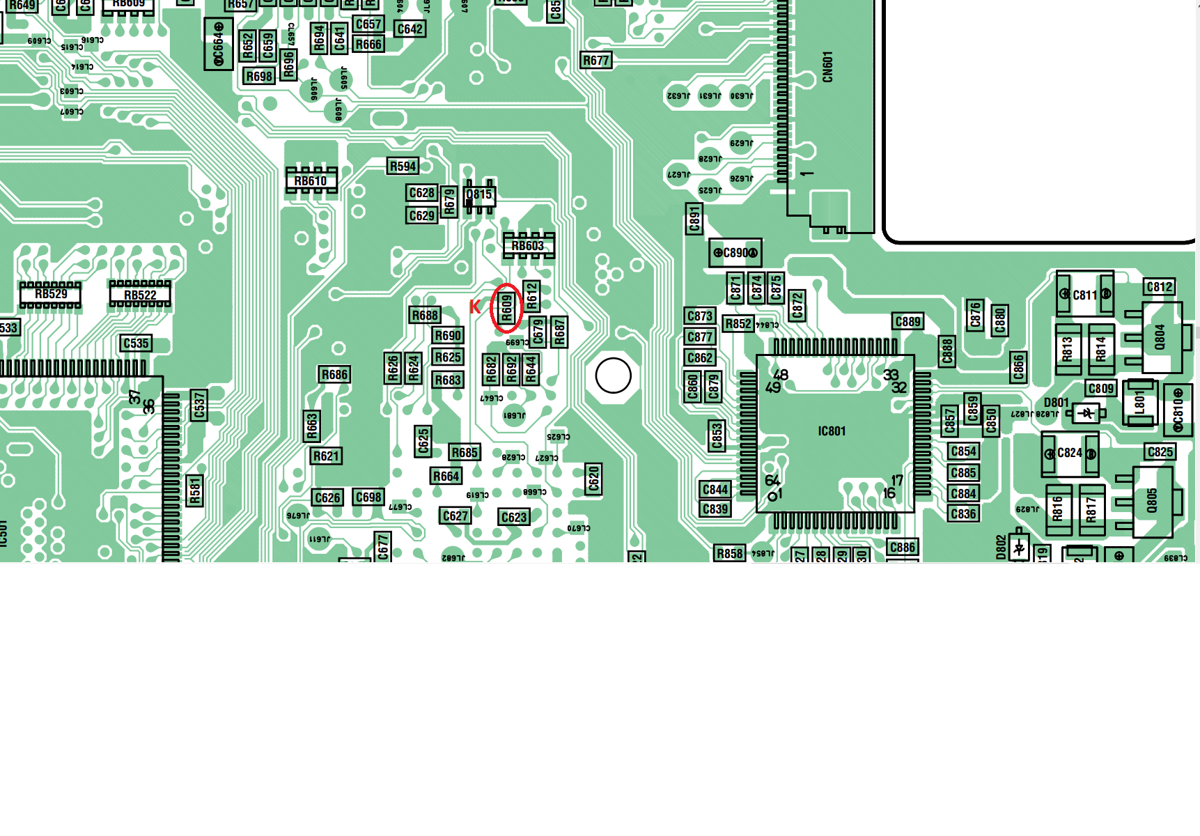

    K point (int) - see attached picture. I'm not sure which side of the resistor we shoul solder to. I think it will be easier to check it with continuity meter. Alternatively we may solder directly to ic605 leg 78. I would like to avoid it though, cause soldering to a resistor is much easier and safer.

    My findings:
