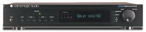

  14. mooseblaster
    Aug 27, 2006
    1,568
    Ooh, been looking for something like that.
    What's the model number of that bad boy?
  15. danhans115
    danhans115 Spirited Member
    Sep 15, 2007
    183
    Cambridge Audio V500,
