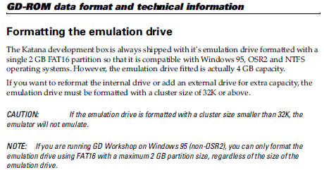

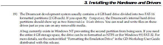

    I remember reading (years ago) something about, if you use win98 that you could see an extra partition on the Katana hard drive? Can anyone verify this?
