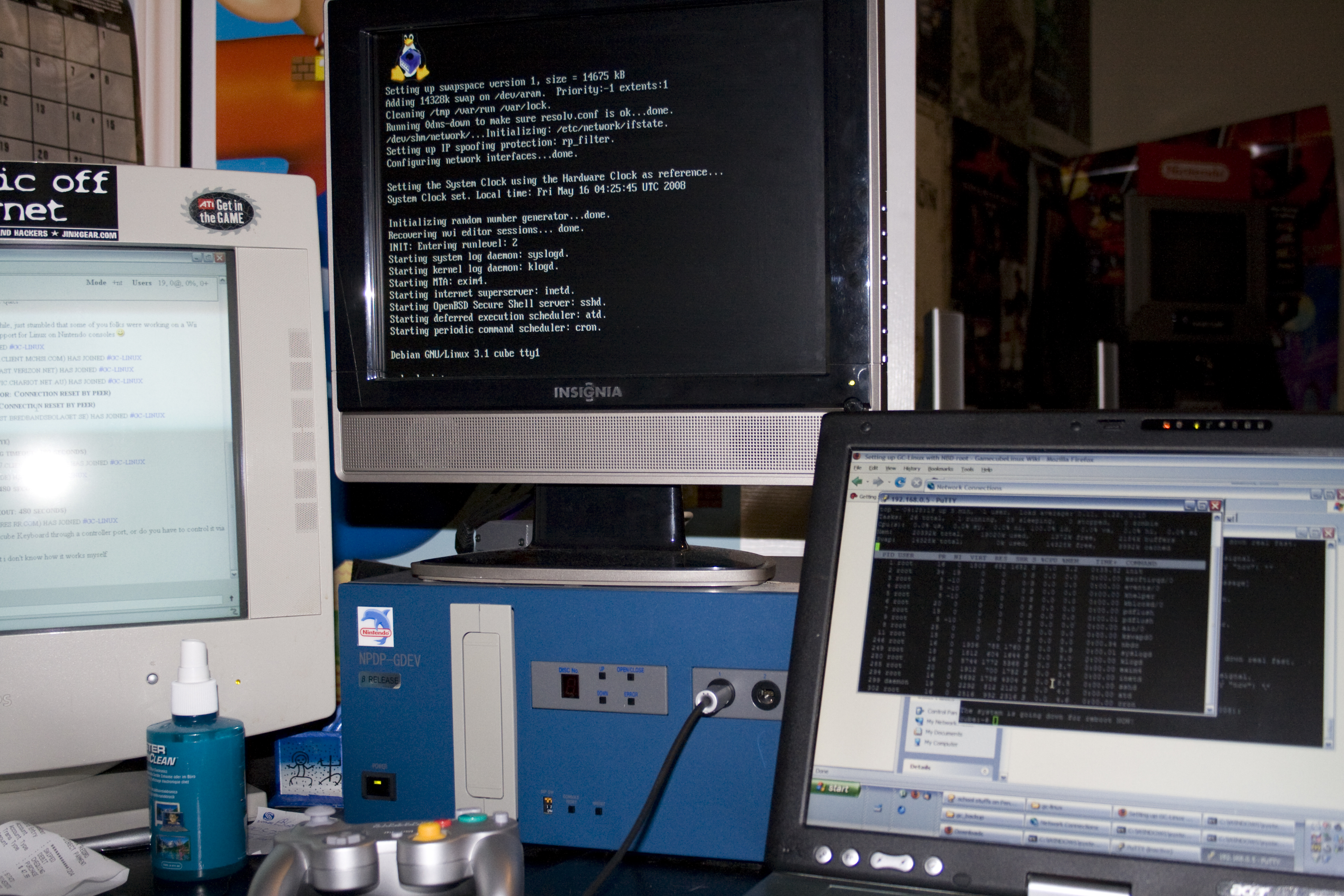

    Just for fun I wanted to try this out, and took a photo.
    Here we have GC Linux running on an NPDP-GDEV unit. I am using the NBD-root method for networked storage on the laptop in the photo, while the PC mainly to the left has the ODEM which I used PSUL from a streaming image of Phantasy Star Online to get the .dol file up and running. Had to do it this way because I don't have an SD card adapter.... yet :p
    Basically I followed the instructions for using it with a regular GameCube found at http://www.gc-linux.org/wiki/Main_Page
    Larger image: http://electricpickleonline.com/images/gamecube/gdev_linux.jpg

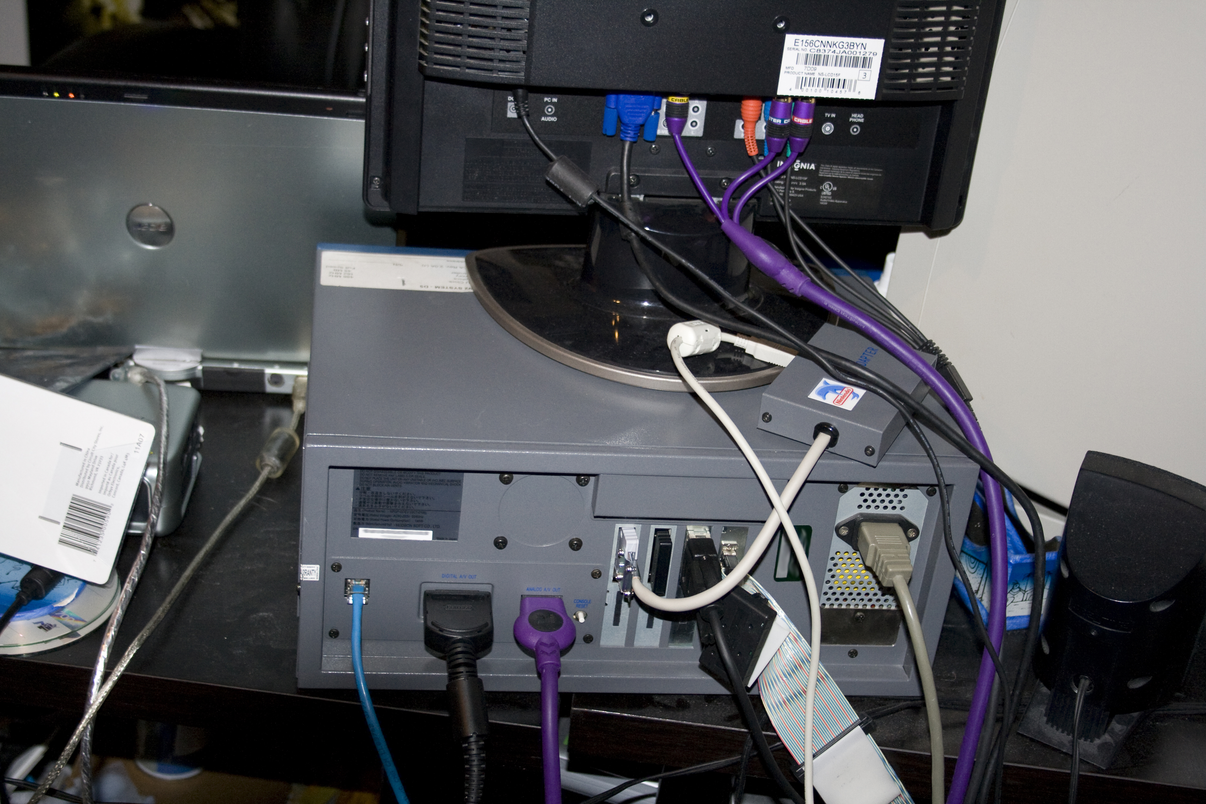

    and the back of the unit...
    larger image: http://electricpickleonline.com/images/gamecube/gdev_back.jpg
    I do seem to have a problem though, in that GC linux only detects 24MB of RAM, not the full 48MB. I have set the system to 48MB using the setsmemsize bash command, but to no avail. Is this number hard-coded somewhere in the linux kernel or boot dol file? If so, I'd love to change this to utilize double the memory :)
