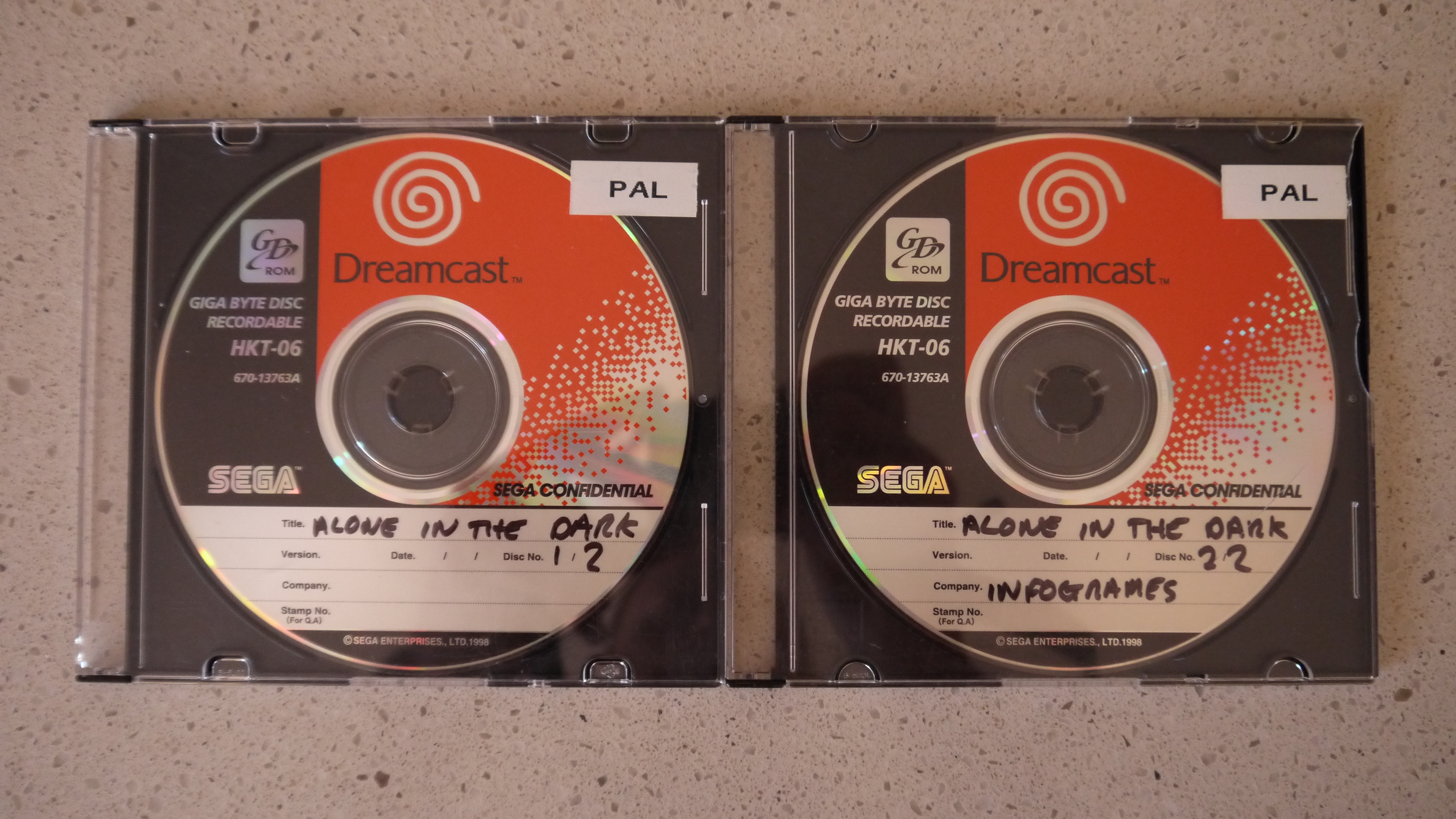

    Hello Guys,
    Here is my only one entry in this list. I haven't been able to play it yet. Alone in the Dark is one of the only Infogrames games that is not impossible to finish haha.

    You should be able to boot this via swap method bud and I know you can dump it with an SD adapter if you wish.

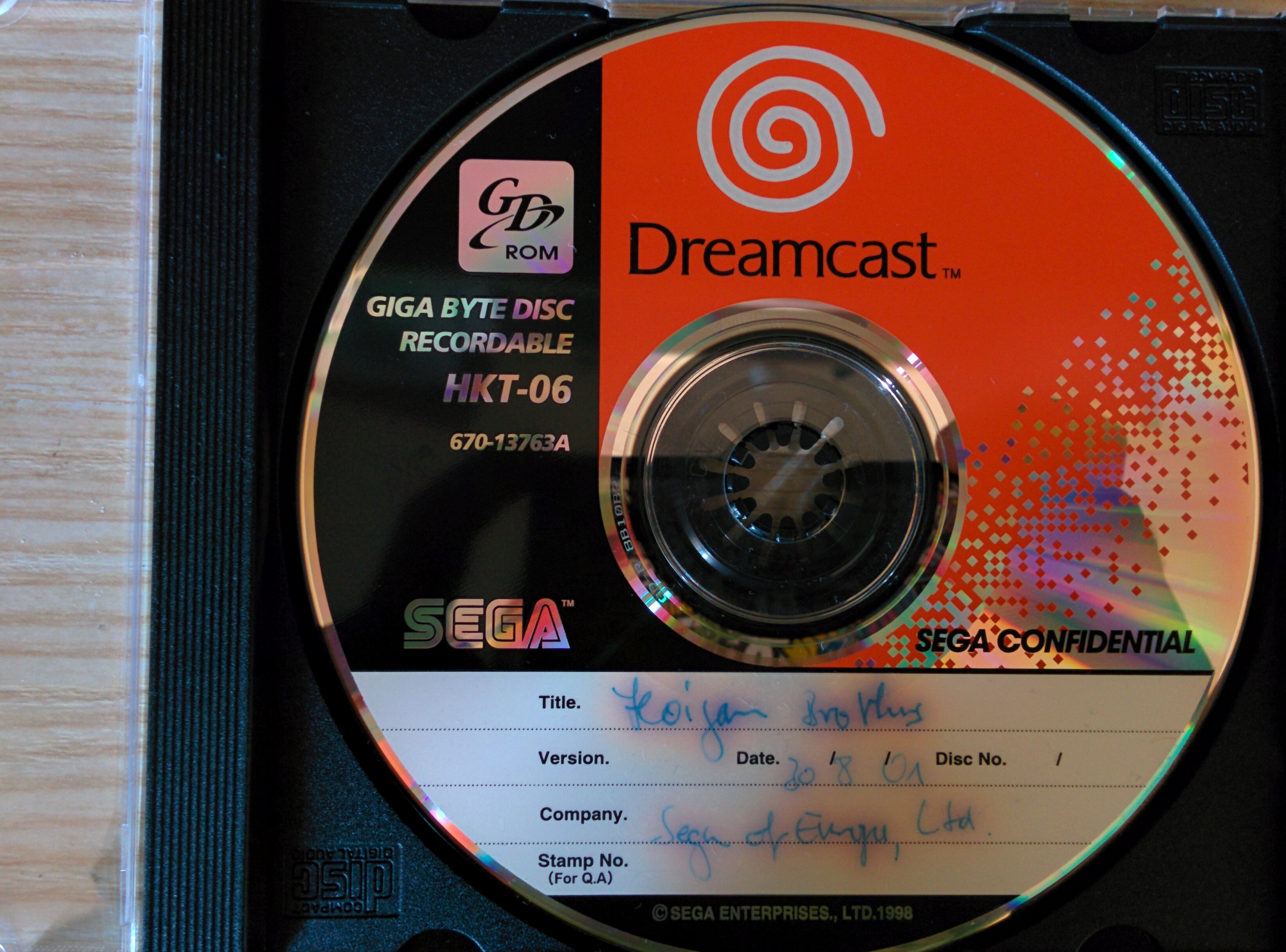

    My first game in a gd-r is on its way to my home. Not so rare but is a build of floigan brother from 30/08/01 so I think it's the same as the retail. I paid 70€, I think it's a good price ,and I always dreamed about one beta game on my collection but never had money to buy one. If it s useful for the community I will dump and release it, I have sd card reader and Japanese cake bios to do that

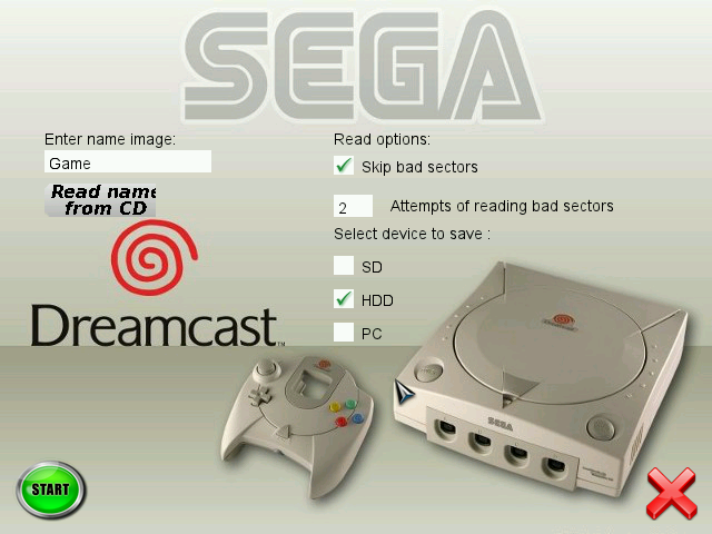

    The gd-r of floigan brothers from Sega Europe has arrived. I was able to boot it only with the swap method that implies resetting the dreamcast clock, I wasn't able to boot it with a bootleg system disk 2 and I even tried in many ways to fake the drive and find a bug in firmware like the one that permits it with the internal time reset. The system disk 2 without the ring data like the original is useless because it seems to work and boot but the console can't run the code on the gd-r because is not authorized (by the holly chip??)

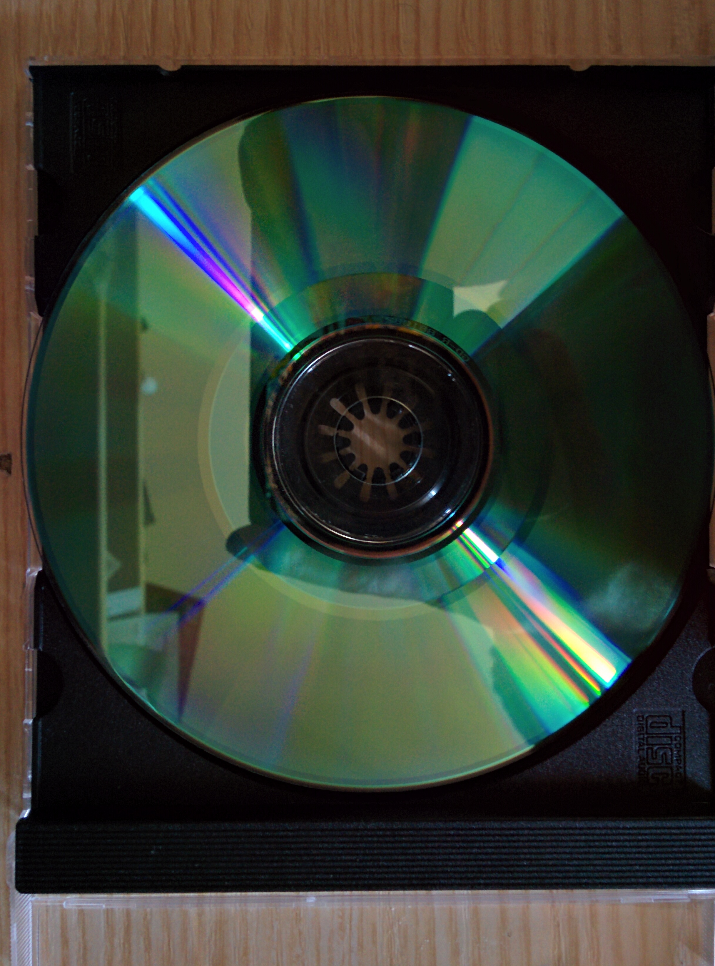

    The game seems pretty finished at first glance. The only difference I found is the missing online menu. Due to the late date written over the gd-r near to the commercial release I suppose it could be a final version exactly like the one on white label ( some of mine white labels and samples gd are missing online too) that is only meant to substite it, or an internal final review copy for Sega europe. Is anyone interested in a dump and release? But you have to help me because if I try to rip it with dreamshell to sd ,I immediately get some bad sectors and after some minutes the drive goes to standby. The disc is perfect and has no scratches over or under,and it plays perfectly without a jump in the audio or strange sounds from the laser,so it must be something in dreamshell.

  19. megavolt85
    megavolt85 Peppy Member
    Jan 8, 2015
    311
    use skip bad sectors option
