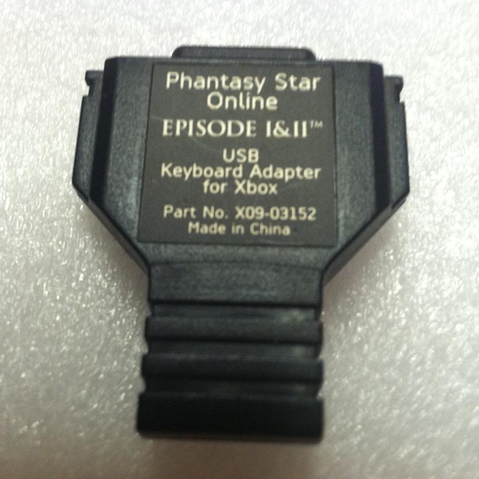

    Phantasy Star Online Episode I & II
    When the game came out, MS provided a USB adapter for FREE + $6.95 S&H to use a Keyboard with this game.

    Oh, if we count homebrew I bet there's a bunch. Iirc Quake2x works too, and probably most emulators for systems that had keyboards (e.g. Amiga, Atari ST, Speccy) do. But retail titles would probably be of more interest. Come to think of it, I never even tried wether the msdash works; at the very least there's a couple text input fields (e.g. song names when ripping cds) that could've benefitted. And now I see there even was an official adapter...
