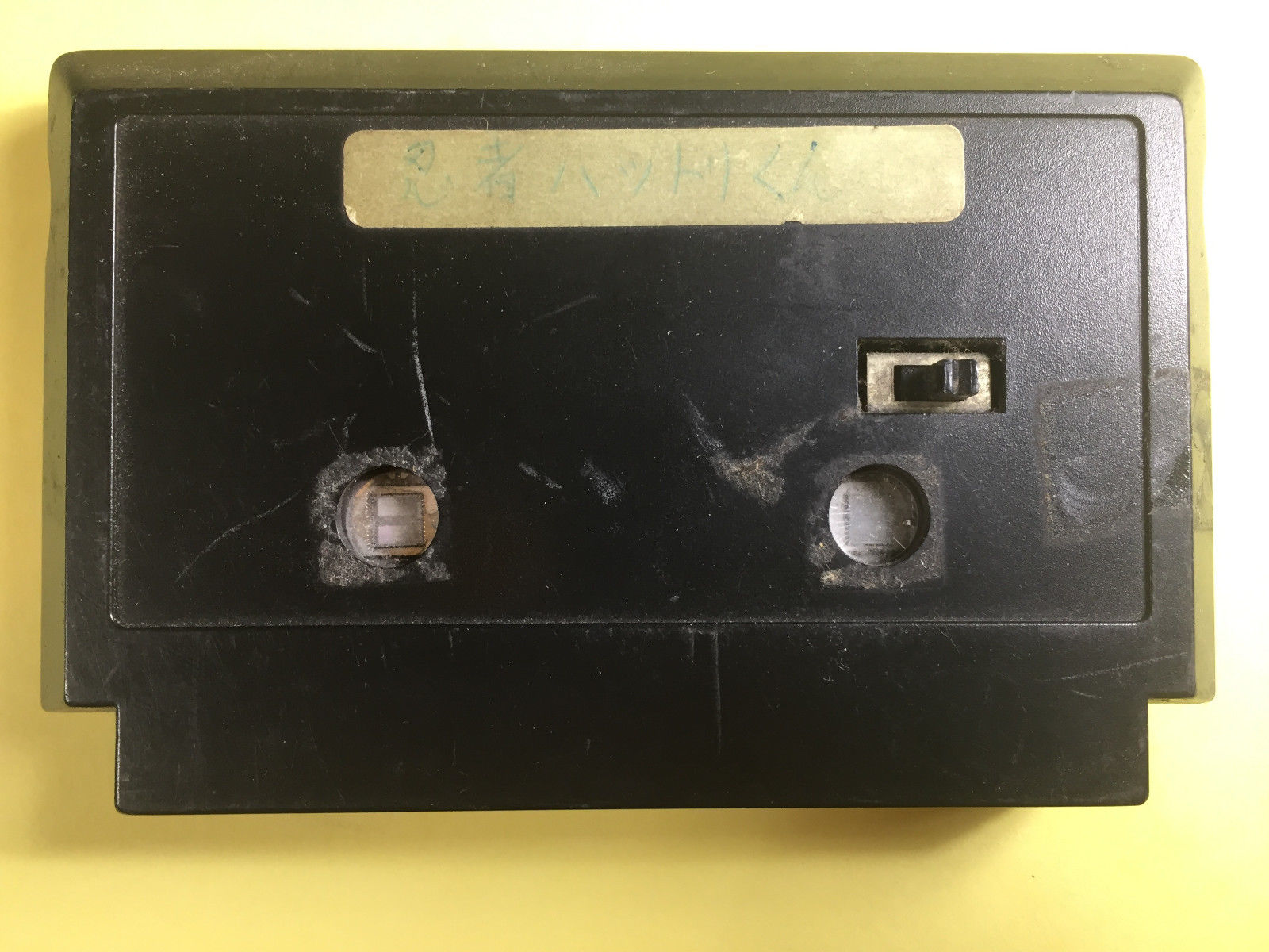

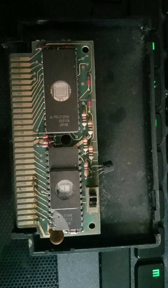

    So I've recently acquired this prototype cart for a Famicom game called Little Ninja Hattori-kun. To my knowledge, there wasn't any standardization for test cartridges for the Famicom, so companies would typically fabricate whatever hardware they needed at the time. My question here is twofold: does anyone have any idea what the switch on the board actually does? Information on games with these switches seems very scarce, but I did come across a thread here that said that they might be used to delete data of the cartridge, but if that's the case, then why leave the eproms exposed? Also to my knowledge the game is identical to the full release, however on the off-chance it isn't, I'd still like to dump it, so if anyone could perhaps point me in the right direction for that, I would super appreciate it.

    It's not a prototype cartridge, it's a cartridge that you use with a Famicom cartridge copier. The switch is to switch between the two eproms once they've had games copied to them.

    I see one at least once a month on Yahoo Auctions, often with cartridges like yours but with Mitsubishi stickers over the eprom, but this is the only thing I could find through Google.

    Of course there was. Companies were just cheap and made their own from retail games.
    If someone sold that to you as a prototype get your money back.

    These supposed Hattori-kun prototypes seem to show up fairly often. I guess it was a frequently copied game back in the day. To date I only know of one (presumably) official prototype of the game which has all power ups immediately selectable and a couple graphical differences from the final game, one of which appears to match the screenshots in the manual.
