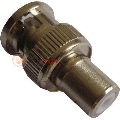

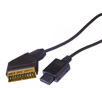

    In order for me to hook up, say, my SNES to a PVM-20M4U monitor (as this seems to be the one I'm likely going to shell out for), I'm going to need three things:
    A SNES SCART cable:
    A RGB-Scart cable/adapter:
    And three of these RCA-to-BNC adapters:
    Am I wrong here, or is there anything else I need to know about these things? I'm not gonna pretend that I actually know more than I've read in the last hour, so I'd appreciate a helping hand if possible.

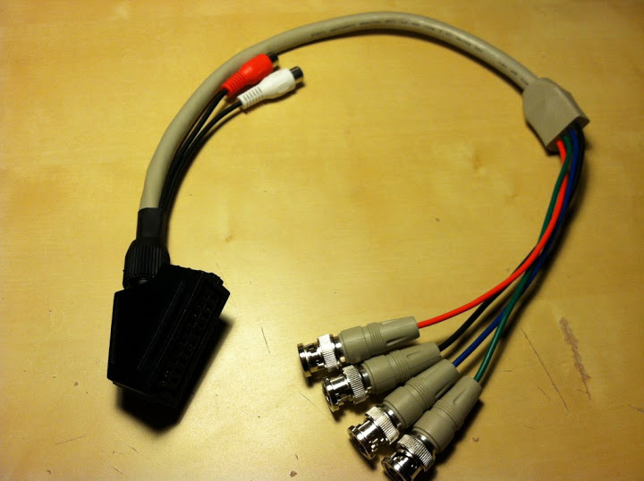

  11. APE
    Needs something for sync and I only see RGB there, assuming it merely converts SCART to RCA.
  12. Kamon137
    Kamon137 Rising Member
    Jul 18, 2011
    66
    Oh, right. My bad.
    So what I'm looking for is more along the lines of... a RGB-Scart cable like this, with a female to female SCART adapter?
    Sync? I'm afraid I don't understand.
  13. RetroSwim
    Dec 10, 2012
    605
    26
    As well as the Red, Green, and Blue signals, the TV has to know when to start a new scan line, and when to start a new field or frame. These signals are "sync" signals.
    In SCART, the composite video signal on pin 20 is used as a source for these signals. When using BNC cables with monitors like these, they need an extra cable, in addition to the R, G and B cables.
    That Scart-RCA adaptor is designed for component video (Y/Pb/Pr), where the sync signals are merged on to one of the signal cables. The PVM will accept such signals, but your consoles don't output them that way. (Actually later ones do, like PS2, Gamecube and Wii)
    The cable pictured there with the SCART plug and 6 RCA plugs is exacly what you need, just use that with some RCA-BNC adaptors and you're cooking.

  17. reprep
    reprep Gutsy Member
    Jun 8, 2012
    475
    i assume you don't have a rgb scart or any kind of rgb input. so the cable you linked won't work. it is a passive cable, you need an active scart to component transcoder to actively use your component inputs.
    also ntsc gamecube doesn't output rgb at all. there are some hacked component cables to output rgb, but i don't know if they are worth the price. pal gamecubes output native rgb.
    the cable you are looking for your snes is called "ntsc snes scart cable" or alternatively you can get "pal gamecube scart cable" for your snes too. don't worry, both are the same thing. the cable you shouldn't buy is "pal snes scart cable".

  20. la-li-lu-le-lo
    No N64 model outputs RGB without modification. For the earlier models the mod is fairly simple, whereas later models require a CPLD and the mod is more complicated. The PC Engine also does not output RGB without modification. The original SNES models output RGB, but the revision (the SNES "Jr.") requires modification to output RGB. Many people do this mod because a) the SNES Jr. is much more attractive and b) its RGB video output is much better. NTSC Gamecubes do not output RGB, unless you modify a component cable.
