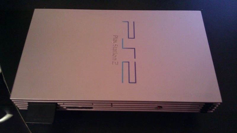

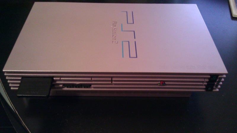

  5. ASSEMbler
    Pic please? never seen that console
  6. sonoranreptile
    sonoranreptile Member
    May 6, 2010
    Here it is. Found it at a second-hand store. One of the employees there lived in Japan for a couple of years and brought it back to the states. I picked it up for $80 in trade. Again thanks for all the help!
