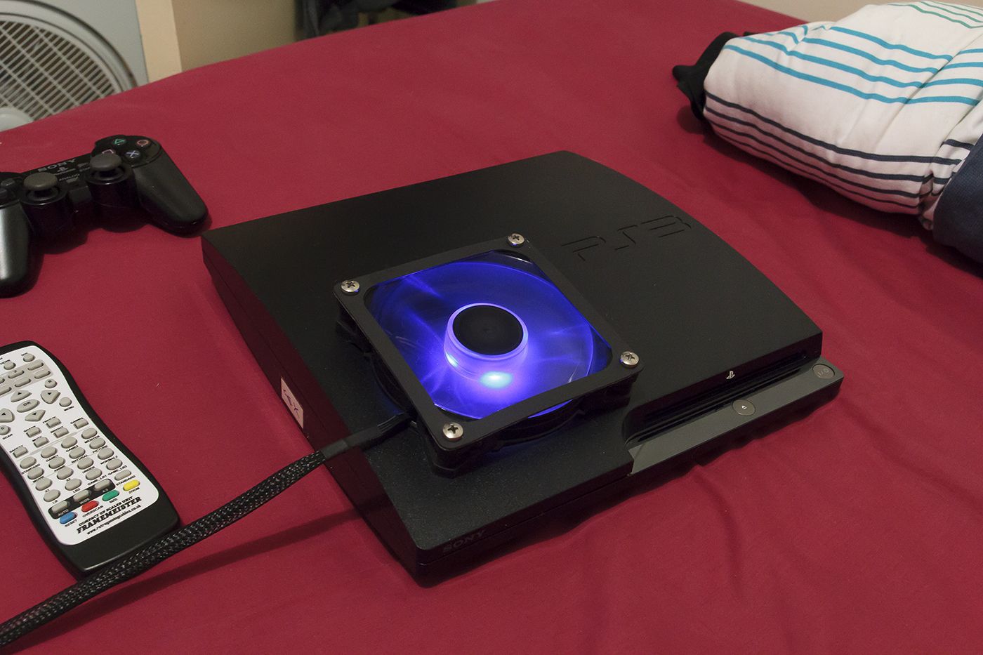

    i have Slims and do the below mod , i get around 41c and 41c for both processors and run the internal fan at 65%. You might want to try and test with the top shell off and see if it makes a difference , if it does then a vent or fan will help reduce temps.
    also i remove the Sony Thermal Paste and i apply Arctic Silver

    What do you get with just the new thermal paste and no fan?
  4. s8n
    s8n Enthusiastic Member
    Dec 10, 2011
    524
    74
    that's something i haven't tried but i've tried internal Fan stock speed , stock Thermal Paste and no external Fan/Vent and i was getting around 65c

    i softmodded (PS3xploit) a bunch of my Slims not long ago and i removed the top part of the shell while flashing CFW. Then i installed webman and changed the fan speed to 65%. I also installed multiman and i checked the temps and they were really good , from memory around 43c. To me the PS3 isn't getting good enough ventilation and the stock fan speed is too slow. Just a hole for more ventilation and raising the internal fan speed will give great temps
