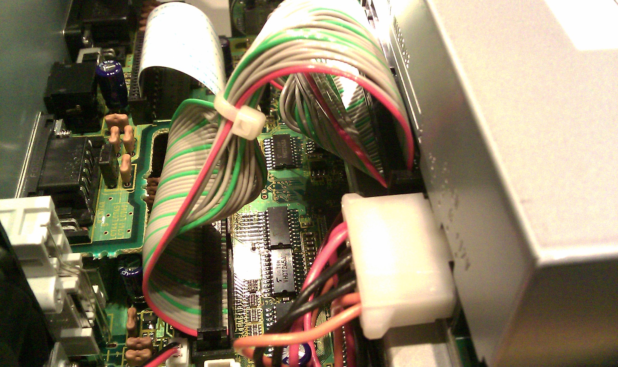

  17. TrailBrake
    TrailBrake Active Member
    Sep 13, 2011
    38
    Here is a shot of the inside of my system. DVD-ROM jumper is set to master.
    I tried a different IDE cable today, but it didn't help things. Still the same "Please Wait" error, and the CD doesn't boot.
    So far I have tried three different brands of CD-R media, using both Nero and ImgBurn to burn images of IMSA racing, 2Dshooter and the Cadillac DVD. None of them boot.
    Maybe this system is has an issue with the motherboard

  19. dutchconsolefreak
    dutchconsolefreak Peppy Member
    Sep 8, 2005
    319
    Also took two pictures of the jumper and IDE cable.
    Jumper setting seems to be the same, although i can't see it very clearly on your picture. IDE cable is definitely connected in a different way.

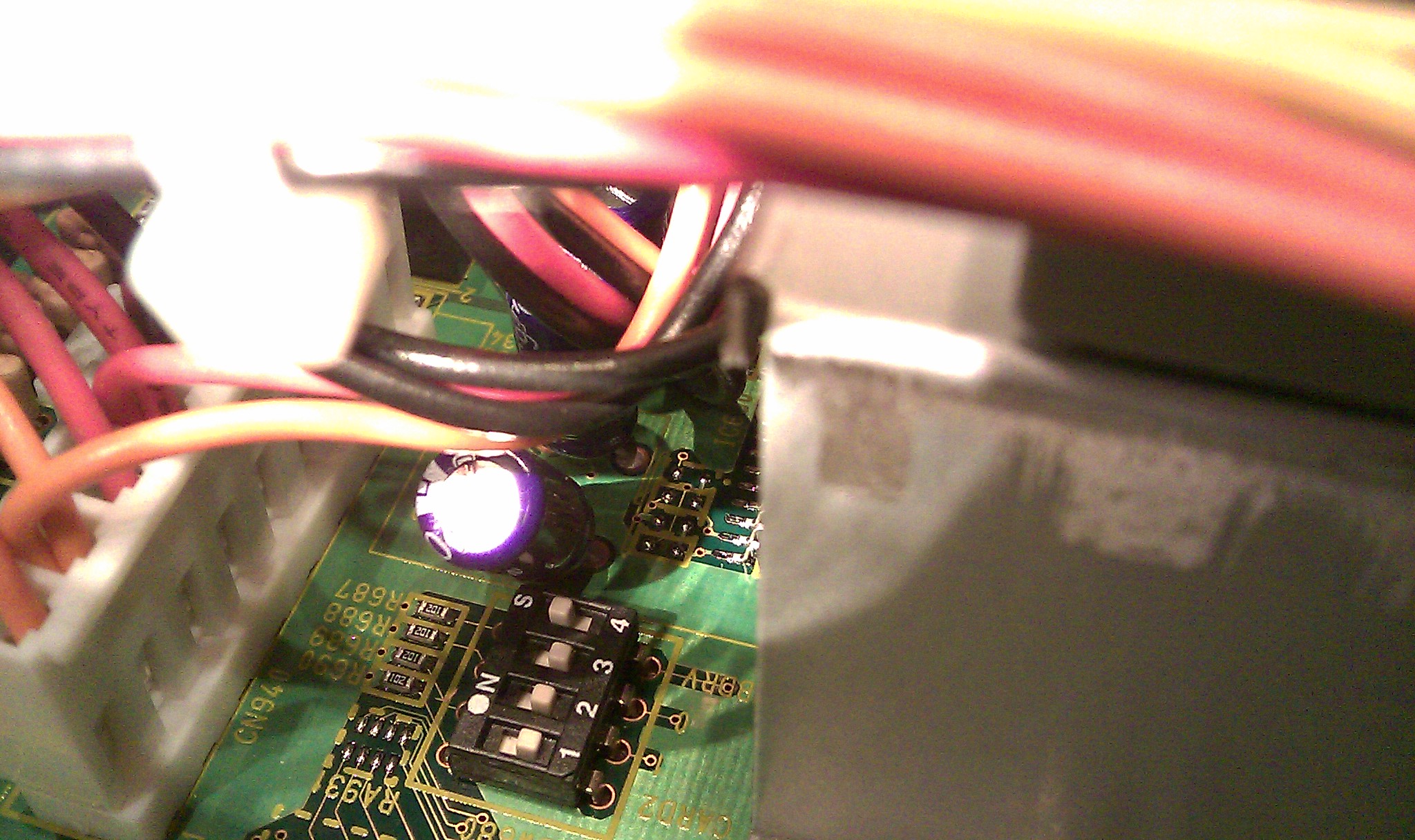

  20. TrailBrake
    Sep 13, 2011
    38
    Thanks for taking the pics, here are a few more of mine, in closer detail.
    I have the letter 'N' above dip switch 4. You appear to have the letter 'S'.
    My pins are in positions:
    1 (down)
    2 (down)
    3 (down)
    4 (up)
