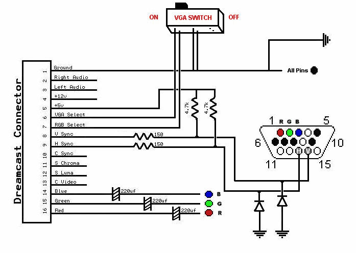

    Hey everyone!
    So I've made a Dreamcast VGA box using a breadboard and before I start soldering it to my broken VGA box, I would like to know how to enable 15KHz RGB mode on the Dreamcast. Is it just linking pin 7 to ground or is it more than that? Any help will be highly appreciated!

    Yes, that seems to be the case:
    I have not really experimented much with the Dreamcast and I do not know things from the top of my head. I did manage to successfully force VGA resolution, which I guess I did by shorting pin 6 to ground.
