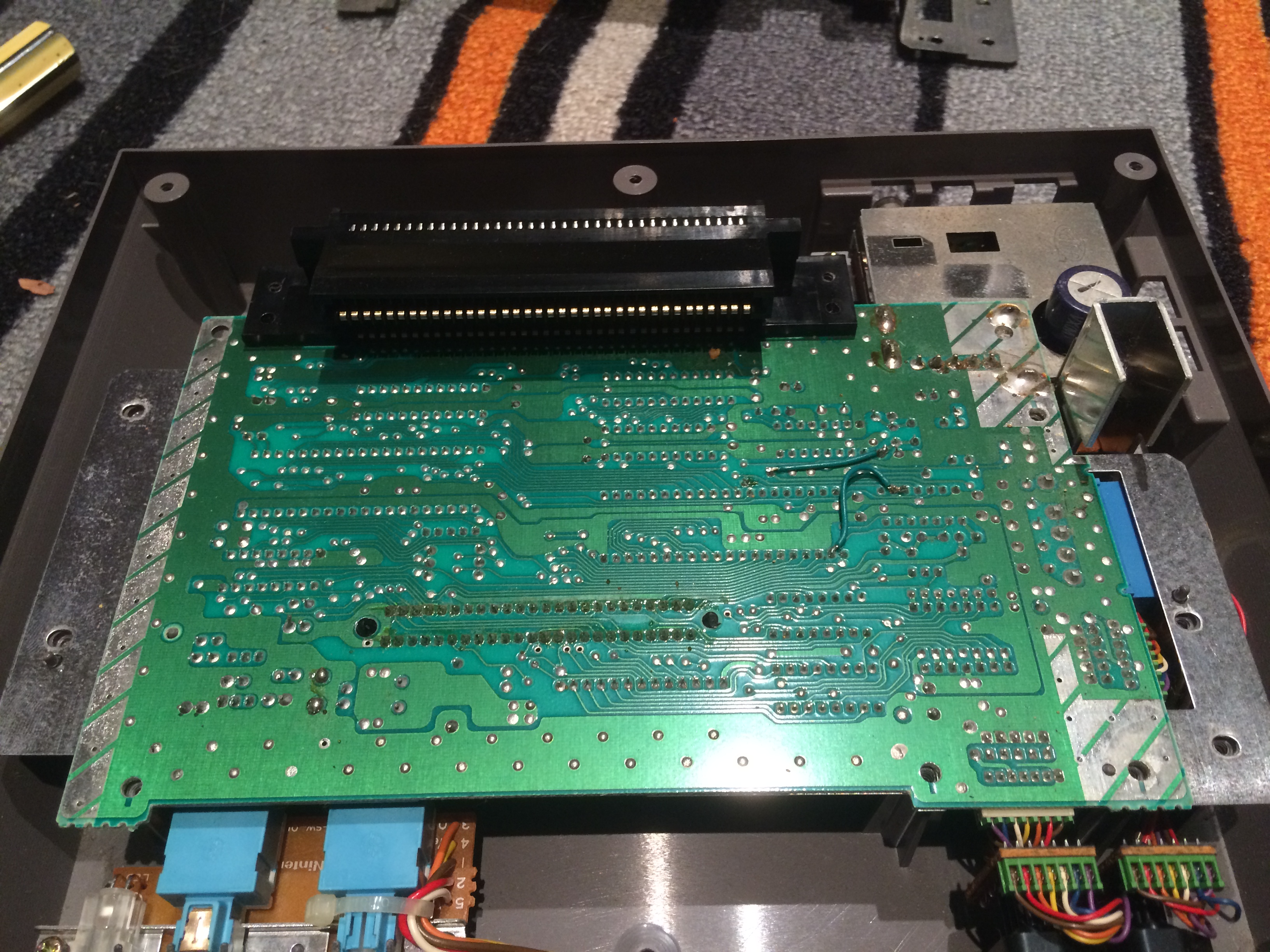

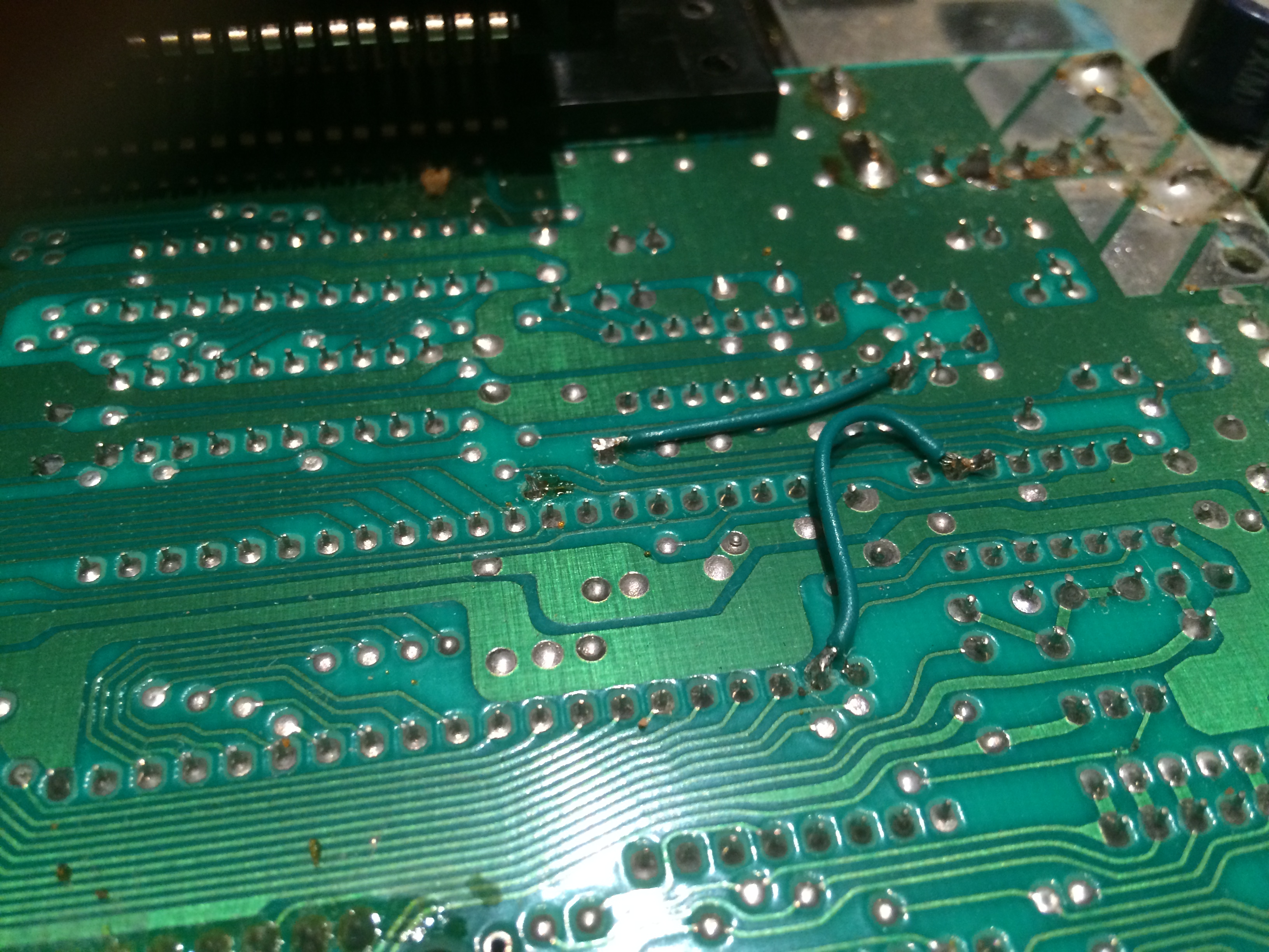

    My curiosity got the better of me, and decided to open it open and check out the motherboard, and it definitely looks like something's been added to it.
    The 10NES doesn't appear to have any lifted legs either, was this common practice back in the day?

    I bought a NES PCB only from ebay and it turned out to be an Asia NES, with a very similar modification to disable the lockout chip. I have since replicated this "non destructive" method of disabling the region protection on NES consoles which I rgbmod and sell (NTSC and PAL).
    I thought I may have been the only person who had run into this apparently-factory wiring..
