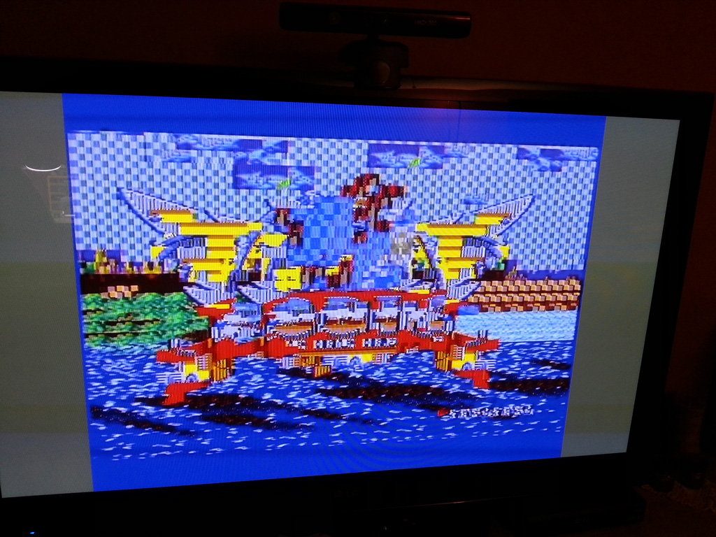

    I got this image on one of my Mega Drive 2.
    VA0 PAL motherboard
    Game is good, works on my other machines
    Connector is good, resoldered and continuity checked
    Capacitors near video encoder replaced
    Traces seems good,
    continuity checked where they looked bad
    Same image with both RF and composite. Sound is good though.

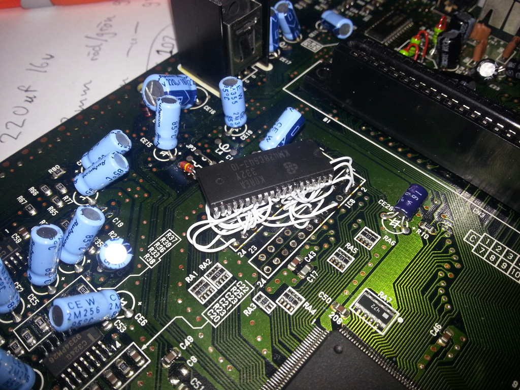

    Any drop in replacement for these? 65256BLFT is a bit to expensive to make it worthwhile :/
  4. MaxWar
    Aug 13, 2012
    1,486
    Are those ram chips SMD or through hole on this model?
  5. Da Bear
    Da Bear Active Member
    Feb 2, 2012
    33
  6. bart_simpson
    bart_simpson Dauntless Member
    May 13, 2011
    768
    18
    Yes bad video ram you can get them but will need a hot air tool.
    and new chip i may have a spare you can have just cost you the postage,

    Unfortunately I confused the chips, the ram was through hole while I said it was SMD.
    No problem thou!
    Works great! :D
