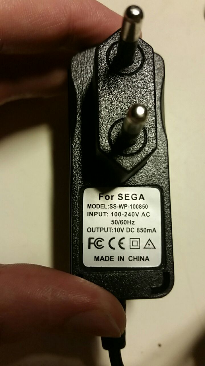

    I ended up buying a third party psu, because I couldn't find a fitting plug for the other psu I have.
