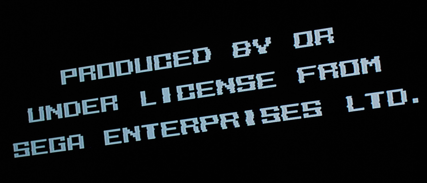

  20. JohnV
    JohnV Newly Registered
    Oct 13, 2011
    help
    As you think because of what there can be such bounce of the letters. At inclusion it occurs, then вс ё is stabilized. And it not on all screen and in parts
