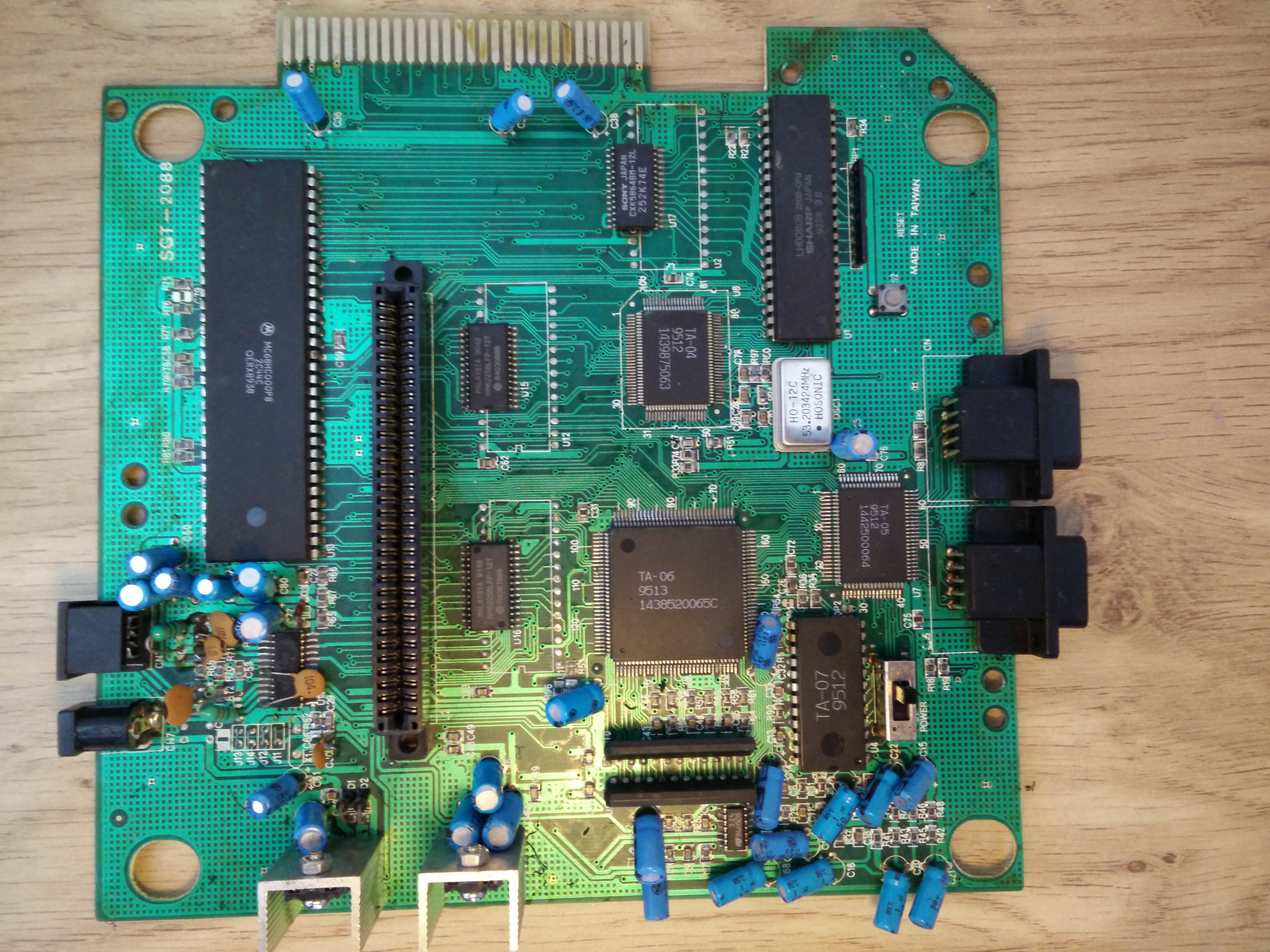

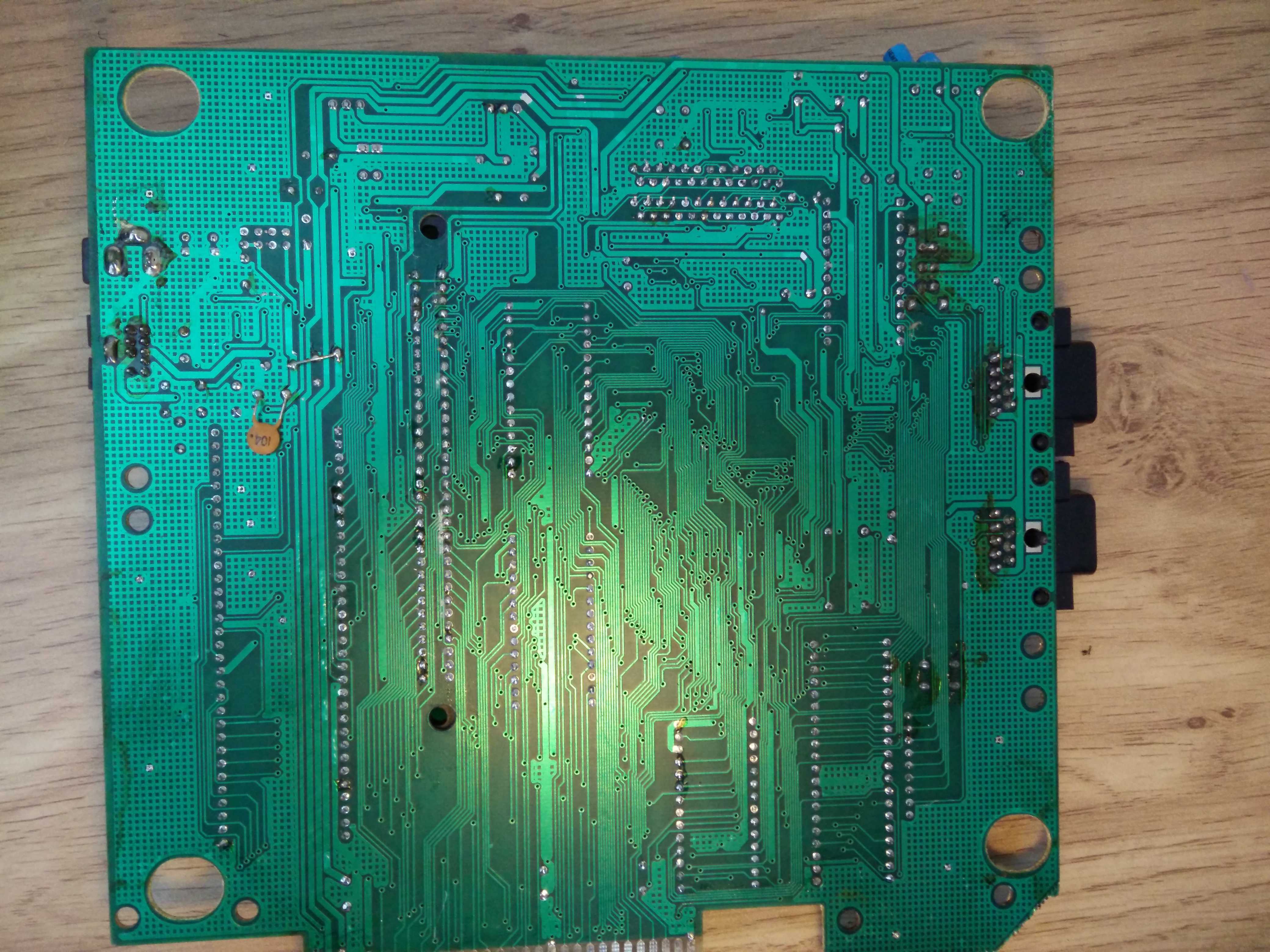

    Hi everyone,
    I have a Megadrive 2 Asian Pal Clone which runs at 50hz.
    I would like to be able to have this system running with 50/60 eng/jp switches or if at all possible switchless mod.
    As the board is different from an original I do not know how to achieve this. I am still trying to identify some of the components. If anyone knows how to do this and is willing to share then I thank you

    With crude deductions I have Identified the clone chips -
    TA-06 9513 - Sega 315-5313
    TA-04 9512 - Sega 3155364
    TA-07 9512 - YM2612
    So to get it running at 60hz I looked up the pinout for the Sega 315-5313 - http://console5.com/wiki/315-5313
    with pin 46 for video mode pal/ntsc.
    Does anyone know the chip/pin for Language selection?
  3. superg
    superg Site Supporter 2013,2014,2015. Tape Drive Donor.
    May 30, 2012
    1,041
    345
    I do believe I've had a similar MD2 clone years ago. There was a factory switch installed which I used to change the region.
    It could be that J11, J12, J13, J14 is what you need.
    I could be wrong but the PCB really looks like what I've had.
    meg4drive likes this.
  4. meg4drive
    meg4drive Member
    Sep 19, 2014
    hey, big thanks!. Indeed J11, J12, J13, J14 is what was needed.
