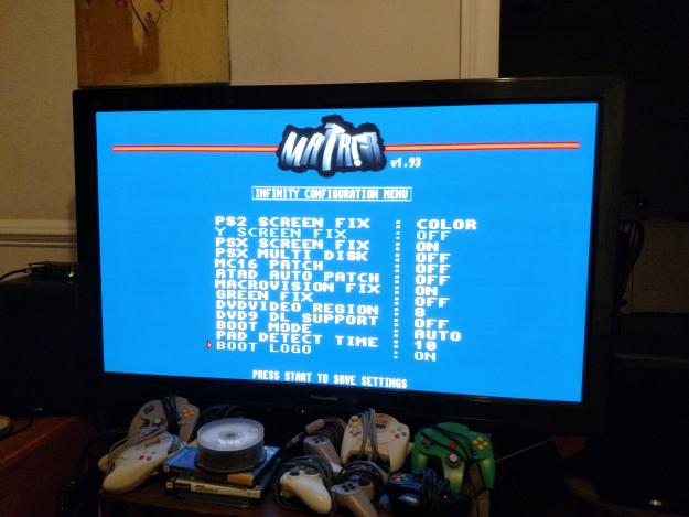

    I was using a HDDOSD install with no issues until I installed the Modbo, but they don't appear to coexist peacefully
    no hdd: ps2 boots all originals/imports/backups regardless of media type 100% no issue
    with hdd (with hddosd) installed: ps2 will not boot ANY optical media, even properly regioned originals. all HDD installed apps and games still work though
    with hdd and modchip disabled: full function of original NTSC-U media of all types, and HDD apps all good
    only way to get optical media to boot with the HDD installed and chip enabled is to hold select at boot with a ps2 game in the drive (for "fast boot") or alternatively hold circle with a ps1 game in the drive ("force psx mode")
    when I say "will not boot any optical media" what it's doing exactly is: 1) disc is recognized in browser 2) click disc and it attempts to load game 3) black screen, flickers a couple times, can hear HDD seeking in the background 4) returns to browser
    various threads on the subject I found in search were inconclusive, people suggested disabling "atad patching" which was already turned off as well as other "hdd related options" (what those are is unclear)
    I disabled every option in the menu to no effect, I attached a picture of my current settings (defaults)
    any thoughts? if they will not coexist I can remove hddosd and just launch opl/apps with the shoulder buttons, but hddosd is just so cool. please don't say stop using modchips :D

    Fixed!!!!!!!
    formatted the HDD using wLE and loaded HDDOSD from SUDC4 - and now everything works
    funny how that premade HDD image I was using before "worked perfectly" pre-chip... moral of the story INSTALL IT YOURSELF :D
