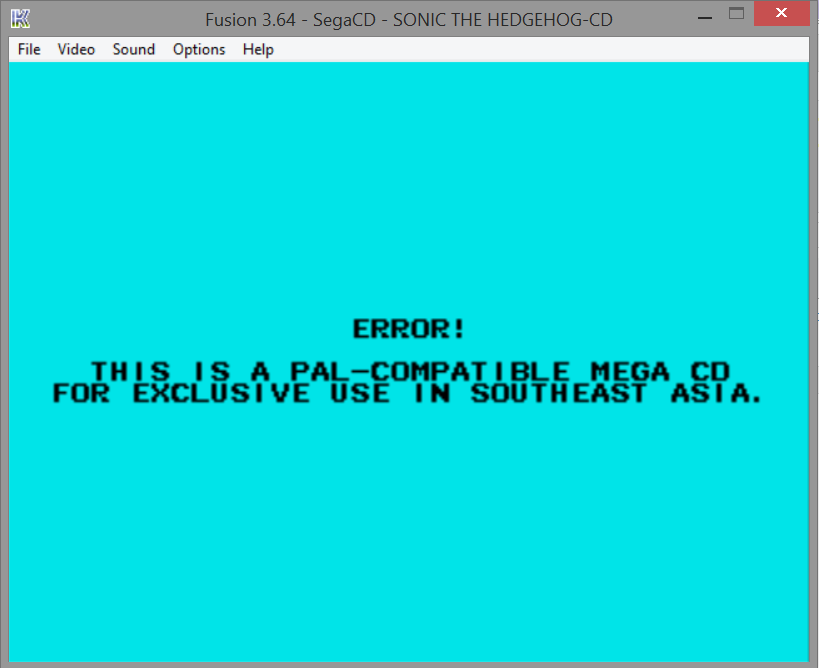

    Out of Curiosity, and wanting to see how i could corrupt a bios beyond Recognition, i opened up my rom image inside a Text Editor, and noticed the Region error message glaring at me and i thought "It can be that easy... just change a few characters"...
    Well, it was just that easy. it appears all of the text strings in the bios image are directly editable so, you can start with something like this:
    and change it to this:

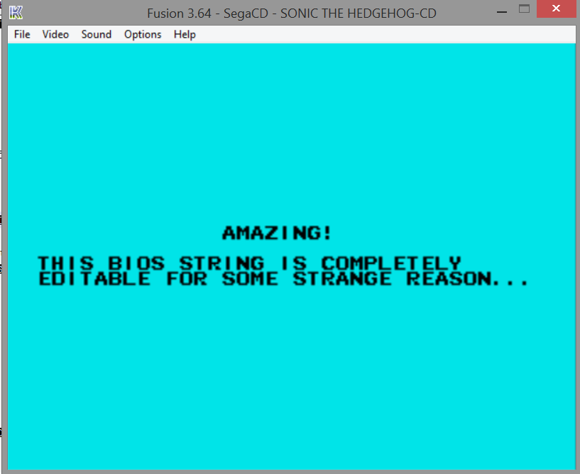

    This was done on a Mega CD (J(E)) - M1 V1.00s Bios Image at addresses 0x00000767 - 0x000007B4. I don't know if it matters, but you may need to take into account the following:
    Line 1 = 21 Bytes
    Line 2 = 34 Bytes
    Line 3 = 35 Bytes
    I'm assuming you have to stay in that zone, but if someone wants to try expanding it go ahead. It just seems weird to me that this is just some random plain text, non-encrypted data that you can just modify. Pretty cool!
