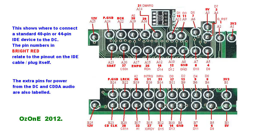

    Question 4: Is it possible to modify the maple ports on the dreamcast to run devices such as a hard drive, lan/wifi adaptor and other devices. I read that others have modified the modem port to run a hard drive but others have said that the maple ports were the way to go.

    There was a hard drive that someone made years ago that ran through a custom interface with the modem port. It was only useable with linux/netbsd for dreamcast because of the need for custom drivers to support the custom hardware.

    I found this http://mc.pp.se/dc/maplebus.html which might be helpful to anyone who wants to know how the maple bus works and why others were thinking about a possible maple bus hard drive.

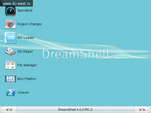

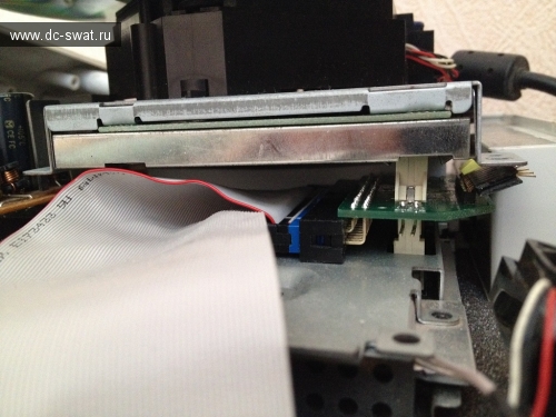

    SWAT has a dreamcast already running with a HDD attached to it, it has a ISO loader to on the Dreamshell OS.
    And the games run pretty good as he shows on his site, you can find the videos here: http://www.dc-swat.ru/blog/dreamshell/873.html
