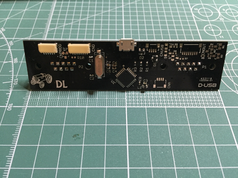

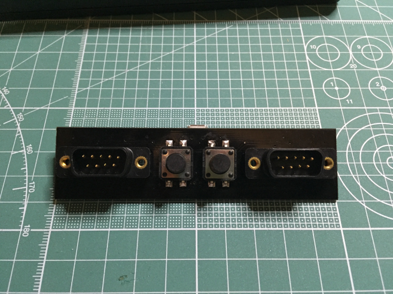

    Completed one of my side project which I named d-usb (word pun of d-sub :) )
    It makes two d-sub (9 pin) controllers appear as a keyboard.
    Features:
    -4 inches x 1 inches: fits in a floppy slot. I will finally have an i7 pc with front plugs for retro joysticks ;)
    - tested with Windows, macOS, Linux
    - compatible with megadrive(genesis) 3 and 6 buttons, sg-1000, mark III, master system, atari joysticks, etc
    - n key rollover
    - on the fly (no need to replug) reconfiguration of the keyboard key assigned to each of the joystick buttons
    - possibility to store a configuration on the device and overlay it with a temporary configuration
    - possibility to enable autofire on each key
    - four GPIO pins, reconfigurable for input/output
    - two additional on-board buttons (e.g. for coins/start)
    - analog inputs, seen by the pc as joystick axes (I plan to connect a physical plunger with a potentiometer for visual pinball)

    Thank you for your kind words. If there's interest, I can release schematic and firmware as open source. I can also sell some boards, either PCB-only or already soldered and programmed boards ( I have 10 copies of the pcb, but I won't probably need more than 3 of them for myself).

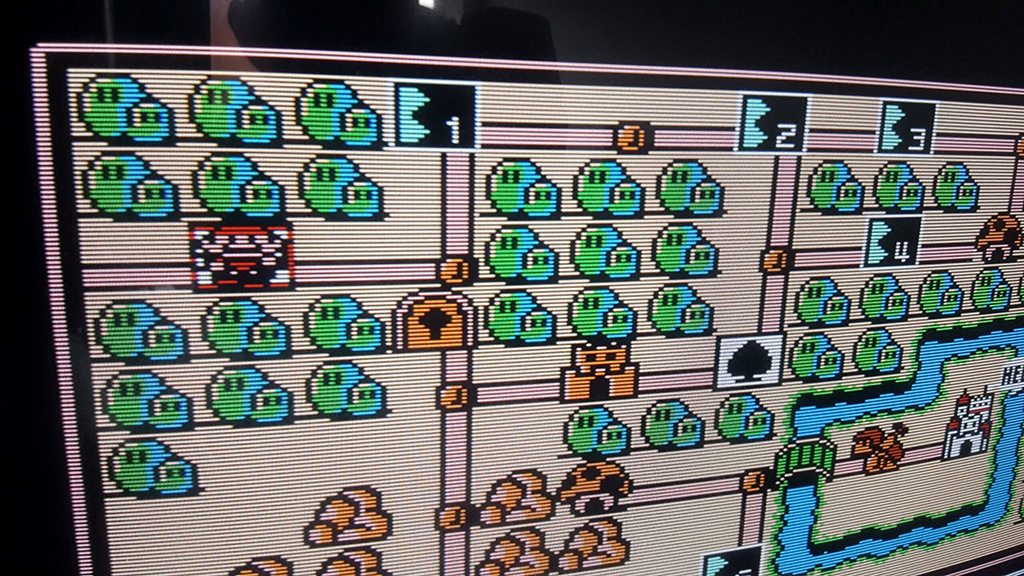

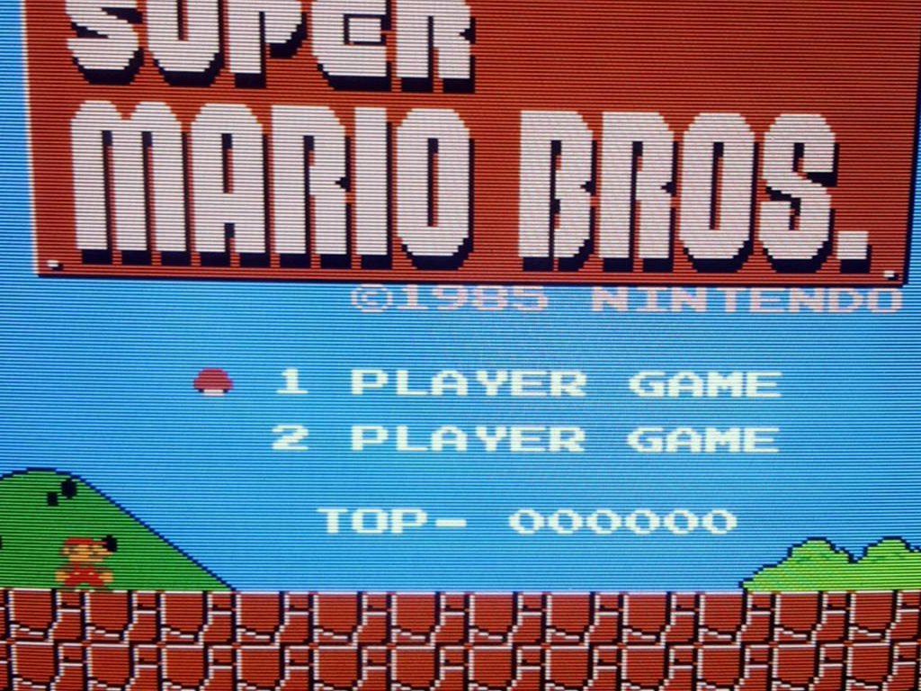

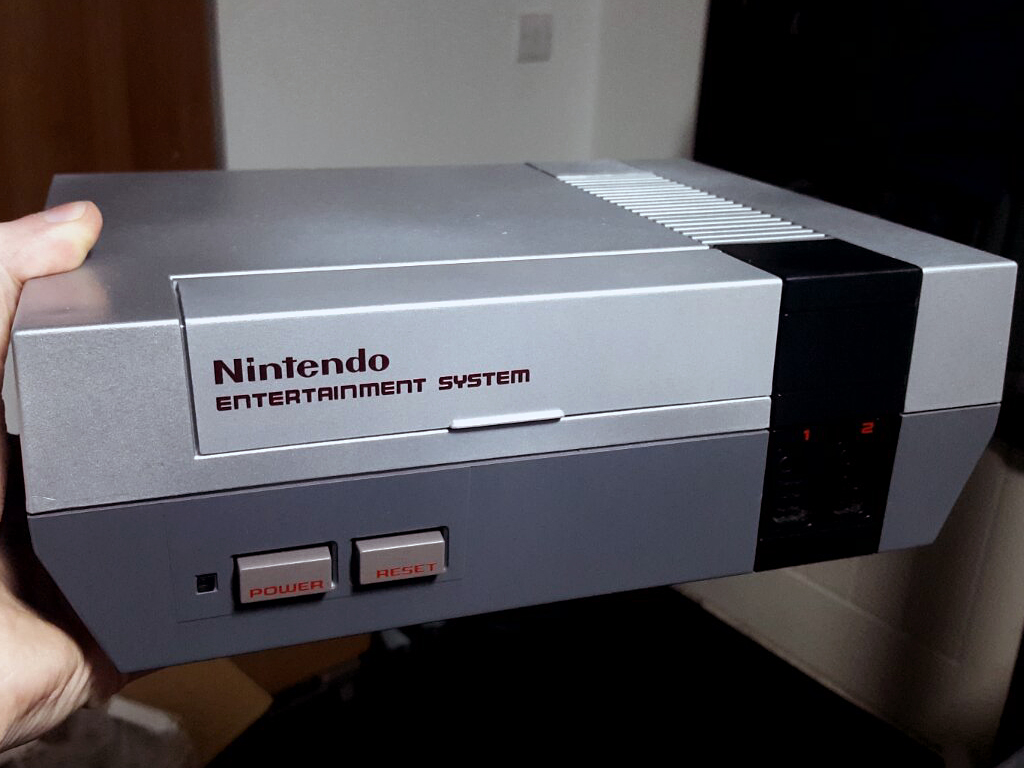

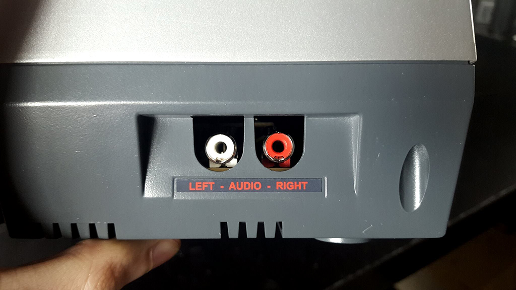

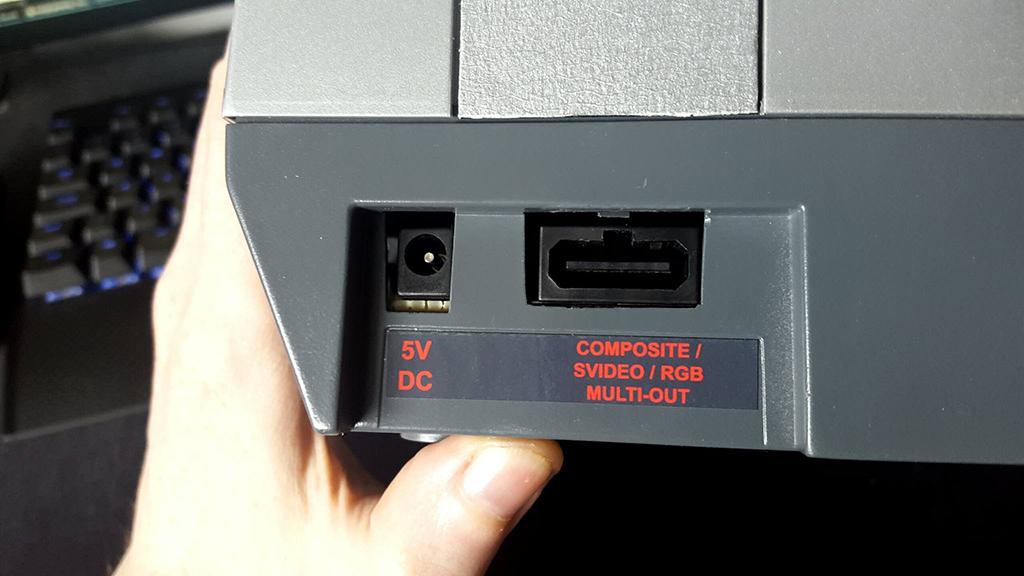

    Finally got round to RGB modding my NES that I've had on the back burner for a couple of months now. Almost finished painting it too.
