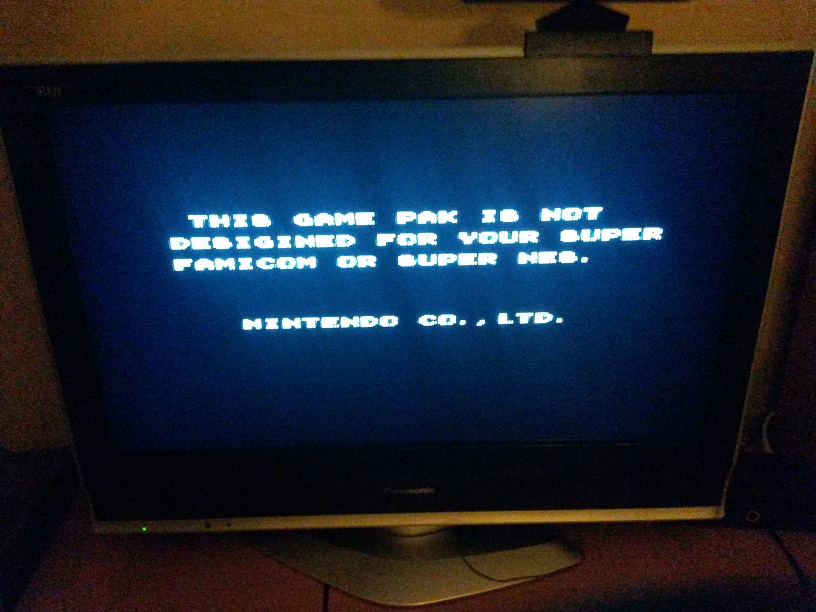

    Ok, it is working, but when I load Super Mario All Stars files I have that info:
    Is it regional lockout?
    How to use that real time saving cartridge? When I put it into slot console don't want to start.
  20. abveost
    abveost Robust Member
    Dec 15, 2014
    273
    Certainly looks like a region mismatch. What region is each?
    To use RTS you enable it in the menu and then activate it with a button combination in game. I don't recall which combination goes with which copier as I have many. It's generally a combination of start/select and L/R for save and slow motion.
