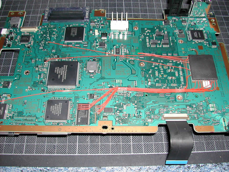

    This will be extremly bizzare if true, as I've never noticed a light when the HD is reading. I'm going to dig through and find a network adapter to try this out. I do have a v5/6 board sitting on my desk and there does appear to be some sort of LED on it facing the front next to the controller ribbon. Going to see if I can query a v9 pic to see if and where this LED is.
    Edit: here is a v9 board: http://www.picsystems.net/imagenes_instalaciones/juan_carlos/juan_carlos_mxl2_V9_chip_aislado.jpg
    If you look to the bottom right, you see the ribbon for the controller. If you look directly left of it about an inch and down slightly, there is a little yellow square with two traces, it's right above the copper grounding side strip. I assume this is it because its in the same vicinity as the one on the v5/6. This is the only LED I can find on the board. I'm going to play with it tommorrow and see if it lights up. If this is indeed the culprit, then a piece of electrical tape on top of it should solve your problems.
    The only reference I have right now is a v12 slim with HD and I'm fairly sure theres no LED on the board (no reason for one obviously).
